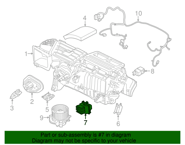

Or your problem could be the blower motor controller behind glove box. FR3Z 19E624 A
Turned out to be a mouse nest in the area of the blower and cabin filter! Damn rodents! 😡
