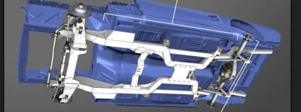

If it’s unibody why it has another frame under?
sorry for stupid question because of my ignorance

That image is showing aftermarket add-on equipment. The blue stuff looks like OE 69 and the white looks like something you might buy for big bucks.

Mustangs have always been unibody. Every generation from the 64.5 all the way to our S-550's.

Guys another question.
Hack said it’s aftermarket chassis strengthen thing.
can I make it by my self instead just buying it for 18,000 bucks

If you want to drive the car, early Mustang stock suspension (especially the front) is completely terrible.
But I would just buy something from TCP, Griggs or Ridetech for the front and leave the rear suspension alone. Maybe if you really want to mistreat the car add in some subframe connectors. You can get by with cheap disc brakes in the front and stock drums out back. If you want to lower the rear either rebuild or buy specific leaf springs for that. I wouldn't bother with a conversion to a fancy multilink setup in the rear.
My answer is no you don't have to spend that much, but it's going to be expensive. FIgure out what you want and add everything up before you start. Decide if you really want to go down that road.
But I would also encourage you to make a cruiser. Don't try to build it into a race car. I think that will cost way too much money. Use a modern car for track days, not a classic.
