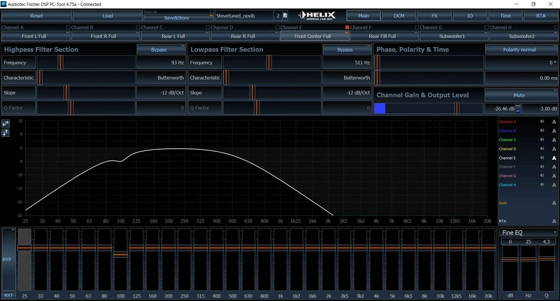

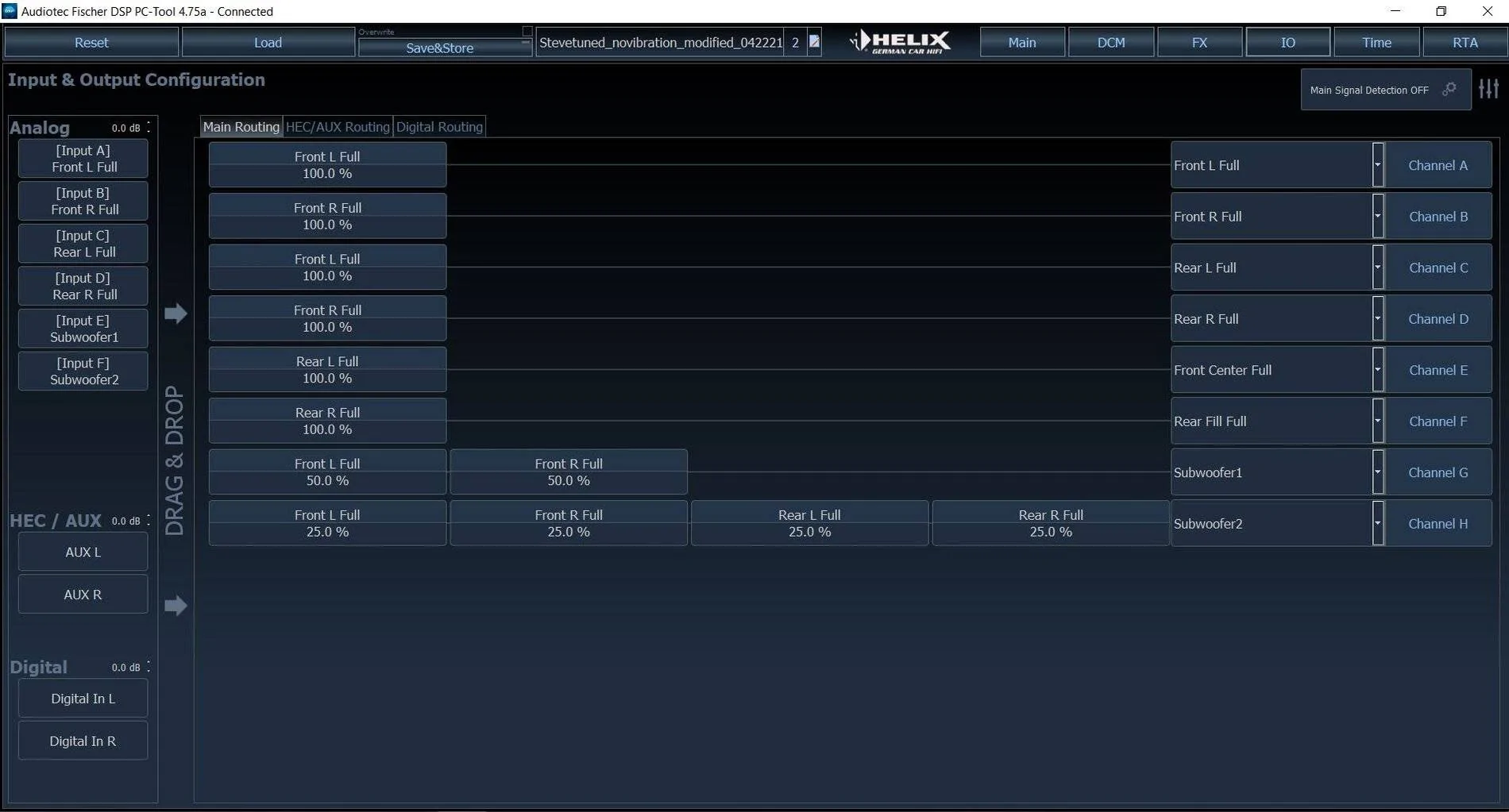

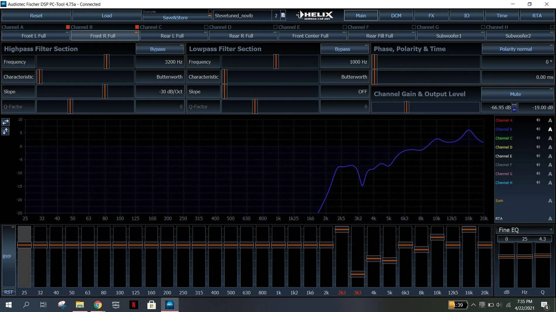

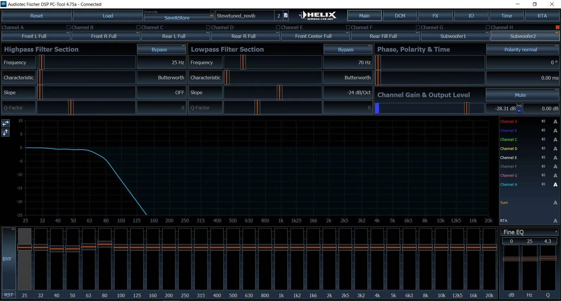

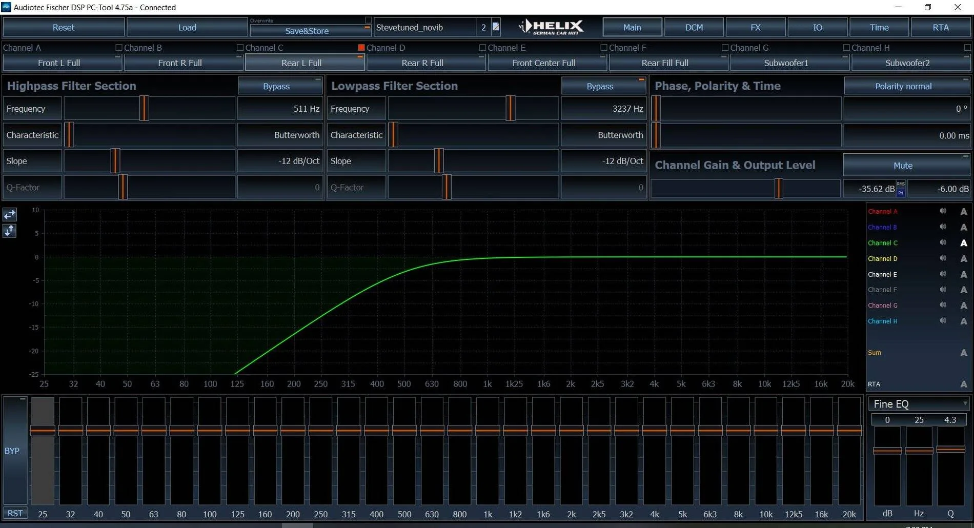

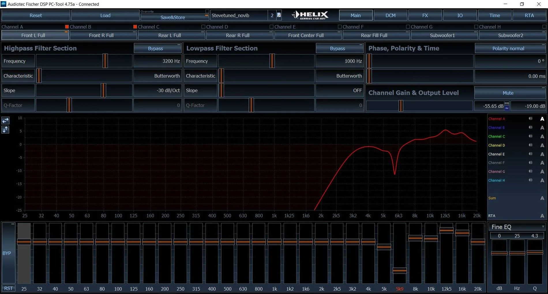

@MegaG @Cathul I took some screenshots of how my current setup is tuned. I already see the frequency range around 3000 Hz is toned down.
I was slightly confused with how the Inputs and outputs were configured.
Input/Output configuration Channel A/B - Tweeter, C/D - Mid, E/F - Woofer, G/H - Trunk sub
Left Tweeter
Right Tweeter
Left_Right_Mid
Left_Right_Woofer
Trunk sub

Why is the lowpass on the left_right mid bypassed?
Uncheck the lowpass bypass on left and right mid and take a listen to the system again.
