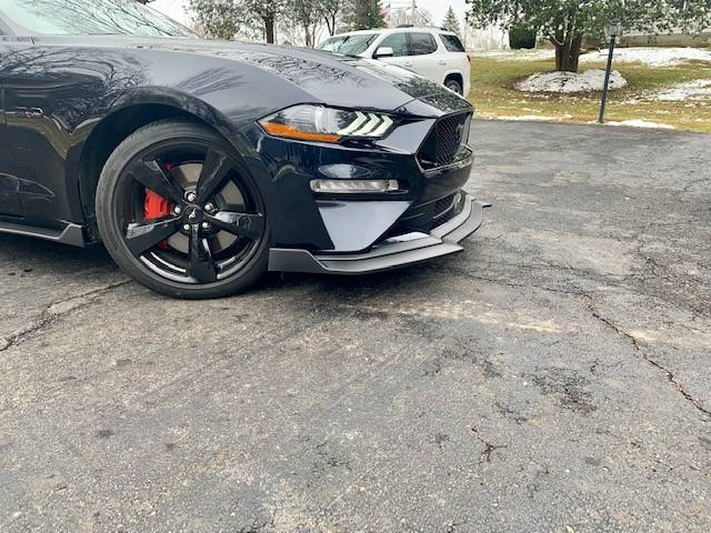

Correct - the belly pans are a slightly different shape. So if you try to use the PP splitter with the non-pp belly pan (or vice-versa), they won't go together correctly, if at all.
And at least for the 15-17's, I know the PP splitter was like 400 bucks at a dealer and the belly pan, another 140 (at least they were in the past year). Worth it for the actual brake cooling for me.
OP - sorry, I don't have a recommendation for ya. Just be wary some out there are quite flimsy or break easy and there's a reason they're much cheaper. There are a few that american muscle and a few other vendors carry that will work with the non-pp belly pan. You'll want to look for the ones labeled " w/o Performance Pack ".
Steeda doesn't show it, but that item listed elsewhere shows that it's for PP models. I like the look though.
