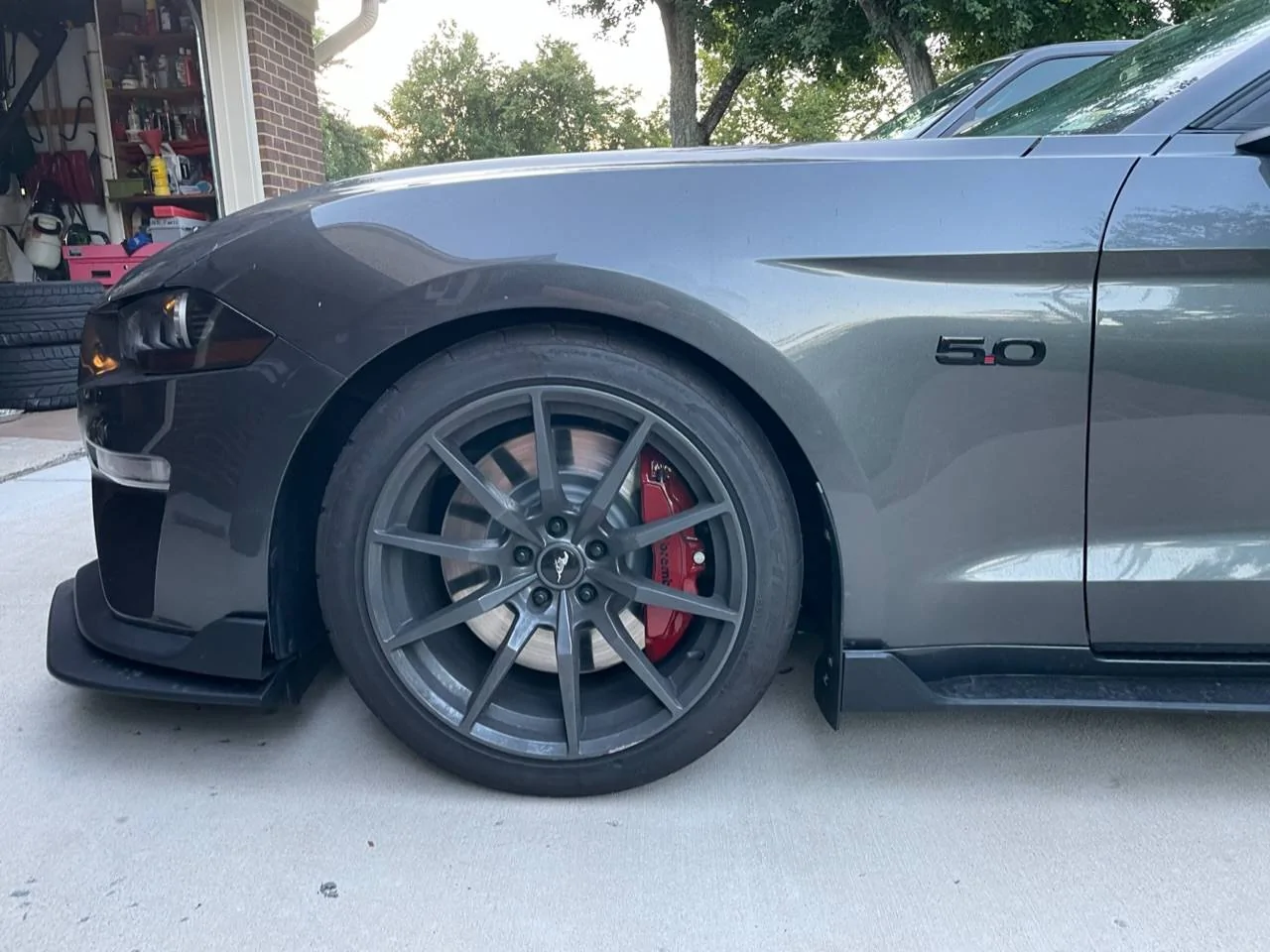

Base 2020 GT with the MP Concepts splitter:
https://www.americanmuscle.com/mp-concepts-mustang-chin-spoiler-407847.html
Flexible when by itself, but it's thick plastic and solid once mounted. It does lower the front end a good bit and will scrape in many places: I'm lowered .5"

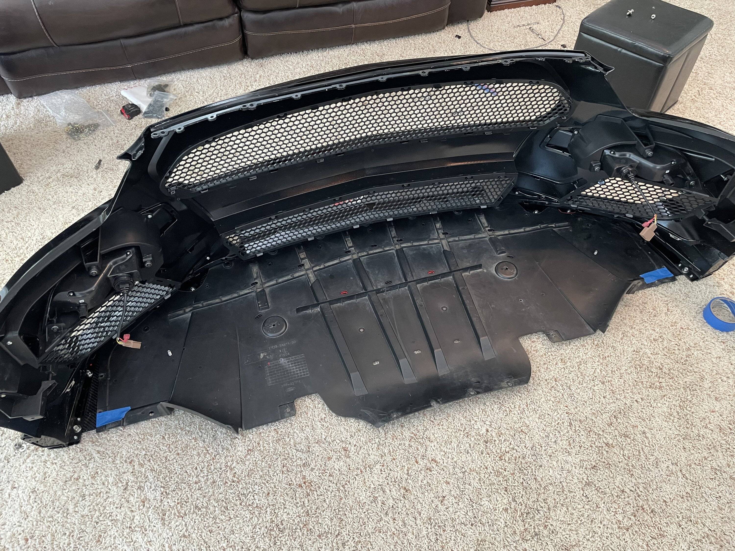

Hey,
Thank u!!! Question? --> do we need to add the black triangular metal brace in order to make the pp underbelly pan work? See pic attached, I highlighted in yellow.
Thanks Anthony
EFI
May 19, 2015
65
5,287
4,734
Masshole central
5.Br0
Thanks Anthony
You can if you want to, but it's not required. It's just additional bracing that Ford deemed improved the driving characteristics of their performance model, but I can't really tell you how much difference it really makes.

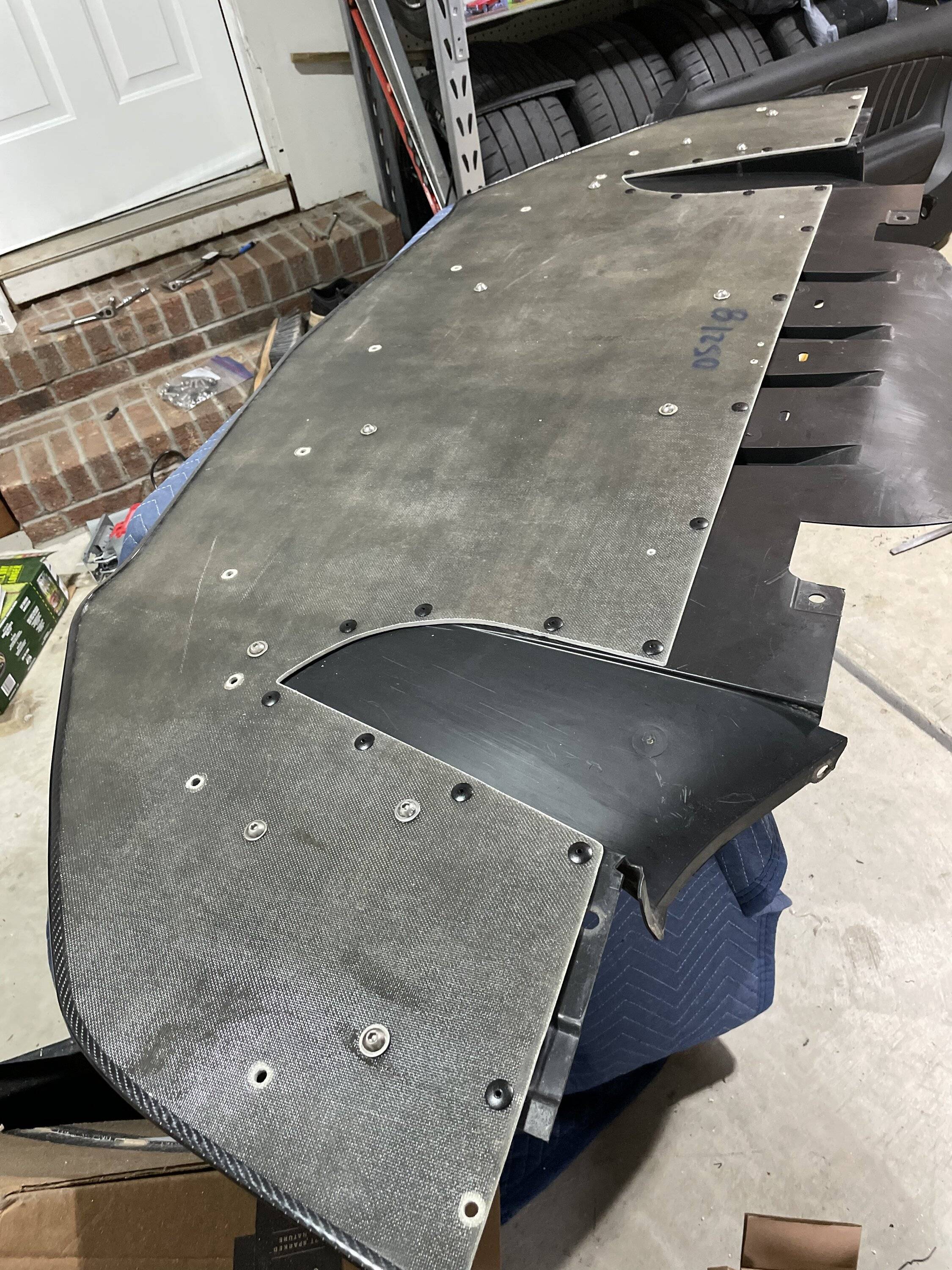

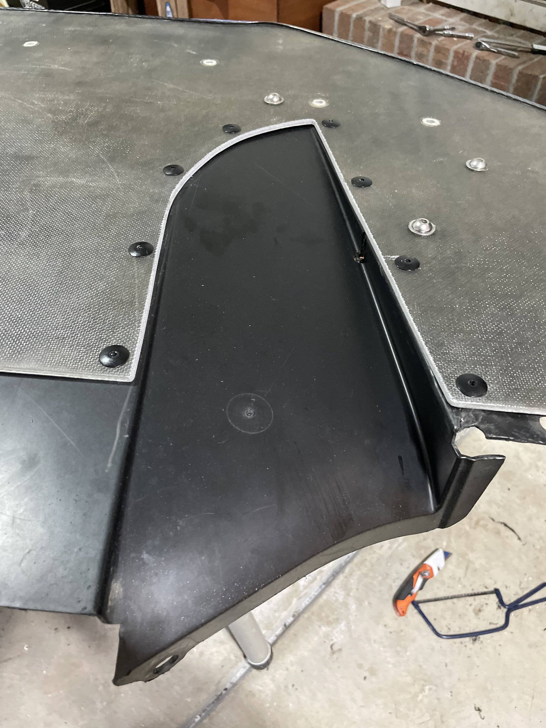

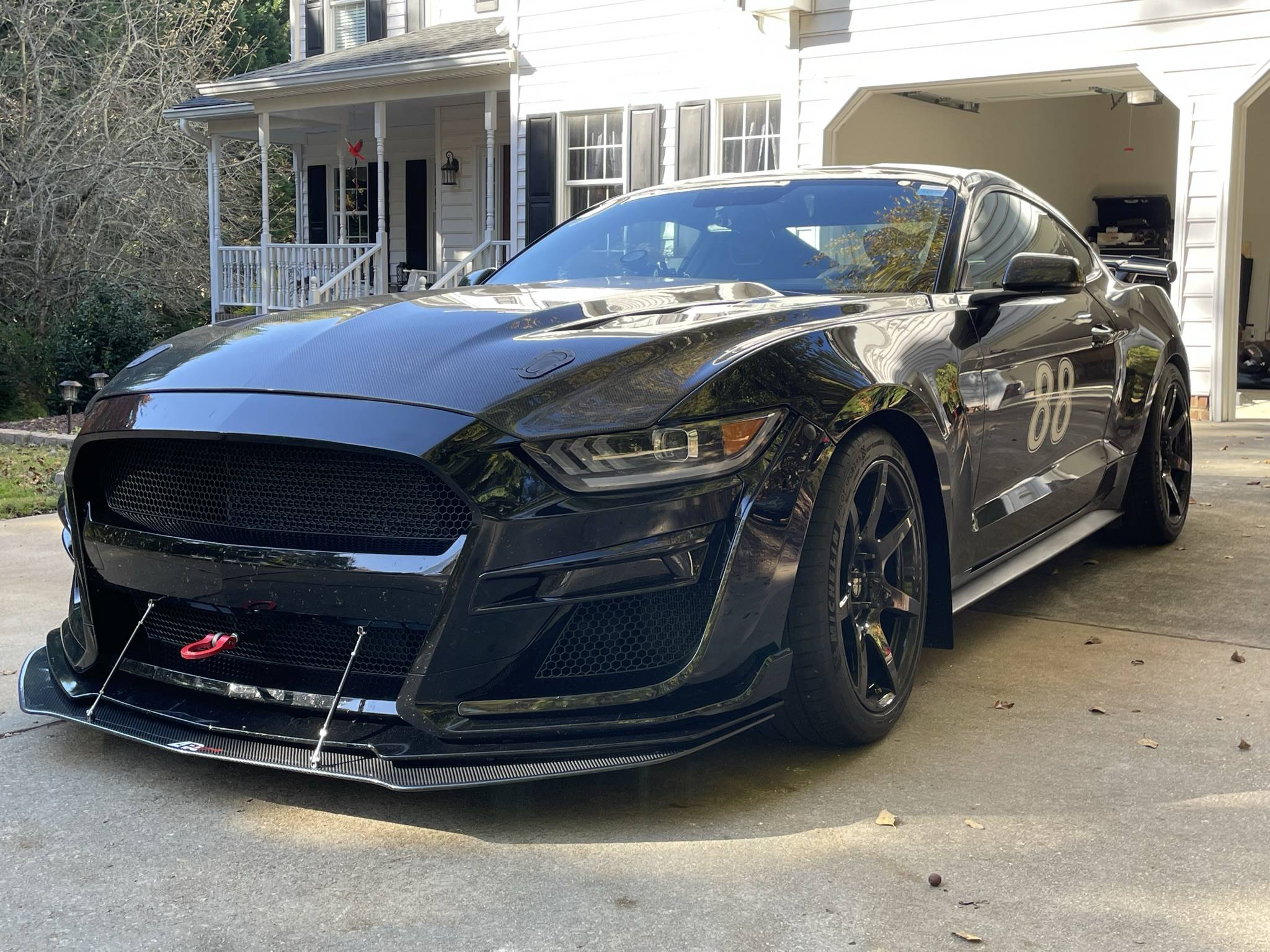

Make it a project..! APR PP splitter mounted to after market GT500 front end, cut outs for brake scoops. Made brackets to securely mount to frame and secured to bumper. Rods secured to crash bar with further brackets.
Solid mounting and functional.
Wow, that's totally badass!!! Thanks for reply and pics for the visual reference. Greatly appreciate it!!

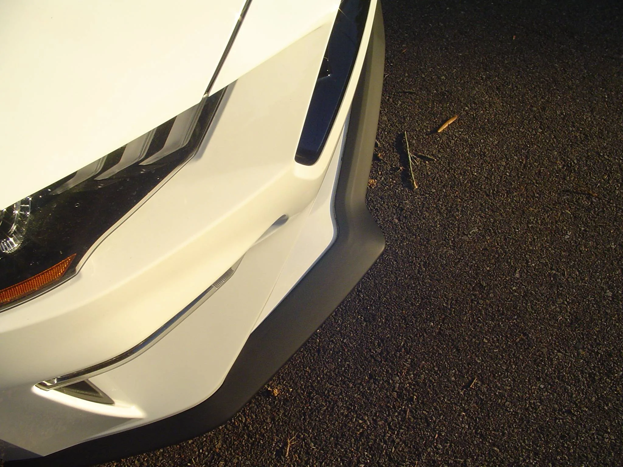

i recently got the "air design" splitter for my base gt,install is an automotie adhesive and 3m tape,adds about 1.5 in of surface,you'll lose .4 in of clearance at the most.
