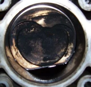

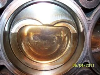

Have a look at this LS2 GTO's carbon buildup after 30,000 miles on 93 octane. The second picture is just 3,000 miles after switching to E85.

You're using a video from a company that sells E85 conversion kits? BS.
I live smack dab in the middle of E85 country, have watched how it has affected vehicles using it and would never use it in a vehicle not specifically designed for it. Plus, I would never put up with the huge reduction in fuel economy or the lack of year-round usability.
It may be fun for instant gratification and a power boost in a vehicle built and tuned for it, but that's it. Converting to E85 also will violate your warranty if any engine-related issues turn up.
