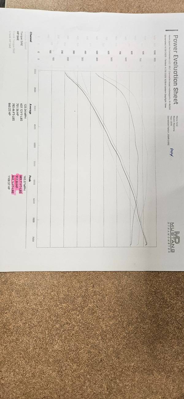

What's the boost curve look like? Interested in how you ramp it in or did you do it by gear?
i should get more clear color graphs from Dyno tec later this week

First I thought “Holy crap!” But then I read the graph and realized the 1108 is CRANK. Very misleading. How do they estimate crank? Is it kind of the reverse thinking? No one I know compares crank these days, especially when whp is there. Which, at 917 is very nice! Great numbers.
Interested in how the smooothboost is working.

Two Things. Wheel HP is definitely what tells you exactly how much engine power is reaching the ground, which is all that matters when racing. But; Crank HP and TQ is the limit on any engine not wheel HP and I would say 1108 crank HP is maxing out the 5.0 Coyote Engine for any realistic, even if small, its reliability/survivability. A Stock 2019 Mustang GT A10 Dynos at around 410WHP. The Factory Crank HP is 460. That means the car loses around 11% CWH to the wheels. Now my Engine produced 1108 Crank HP which is staying close to the same 11% loss from a stock 2019 Mustang GT I lost around 19% horse power from the engine to the wheels.
**After reviewing my Dyno runs I can See my Transmission Torque Converter (Most Likely) Was slipping quite a bit. So, I will not trash the transmission but keep my boost around 11PSI until I replace with like a Circle "D" Converter.

Hi. After reviewing my Dyno graphs I can see I lost around 19% HP from the engine to the wheels, (1108 Crank HP and 917 Wheel HP). That most likely means my Torque Converter is slipping pretty bad. So, I will keep boost around 11lbs until I get a Circle "D" or Suncoast Converter put in. Running a transmission where the Torque Converter is slipping all of the time is bad, and will contaminate your transmission and most likely cause damage to your transmission clutches, valves etc. I will also talk with transmission race shops and ask them if they feel by my Dyno Graphs that both the Converter and Clutches are slipping. If they are I will Upgrade both. I have learned that when building engine One must keep in mind that as HP goes up, Other Parts will fail and need upgrade. That's just part of this world we live in.
