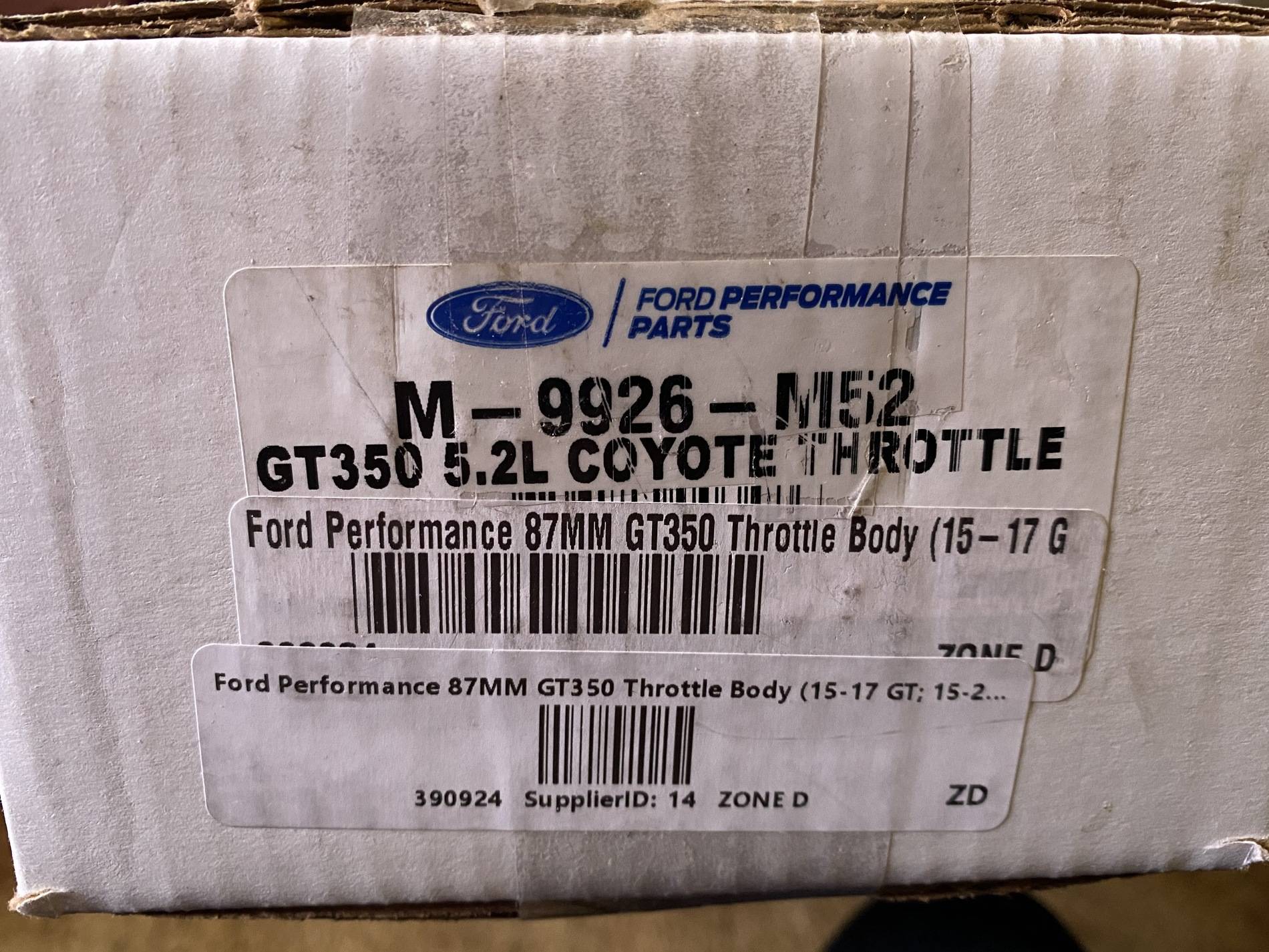

Hello, I'm new here but I'm on my third mustang gt. I purchased a 2017 gt earlier this year and have been modding it with all this downtime recently. I purchased 18' manifold, jlt intake, exedy stage 2 clutch (factory throwout bearing was squeaking) and ngauge with a tune. I also purchased the 87mm throttlebody but I didn't install it because my tuner said there are no gains to be made from it. THey said we can tune for it if you like but it will cost more. Of course I figured why would i spend more for no gain? So my question is, does anyone have a different opinion on this or are they pretty much correct in saying that the throttlebody, or even with my current setup i wouldnt see a difference. Maybe improved throttle response but if theres no power to be had i'm not too concerned with that.

Thanks for all the responses, I do have the ford throttle body the gt350 5.2 from AM. I purchased it after seeing their gains from the combo of intake, intake manifold, and throttlebody. I might just throw this thing in the marketplace for cheap since I don't need it. I'll have to check if there is a post minimum before I can do that but I'm not in a huge rush.
