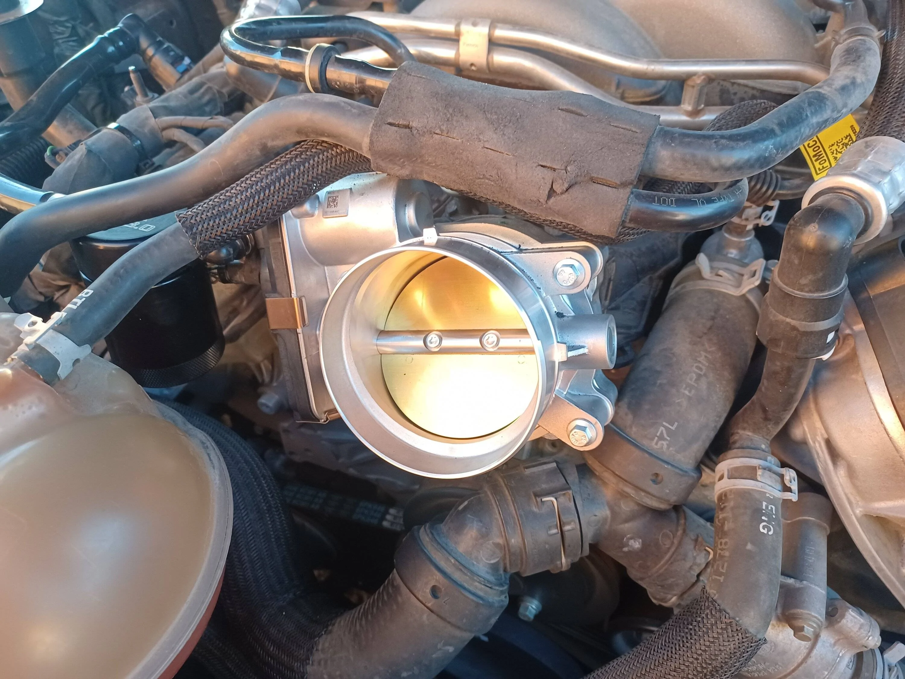

what coupler can i use to fit i went and bought a 4 inch coupler but its too big for the throttle body. anyone running it could help

3.75" - 4"

I thought the 2018+ JLT’s used a 4.5” at the plastic tube end before the TB transition.
Could be, my bad. The tb needs a 3.75 though for sure

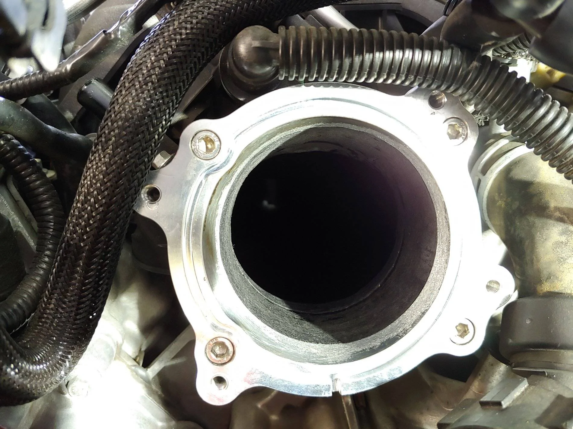

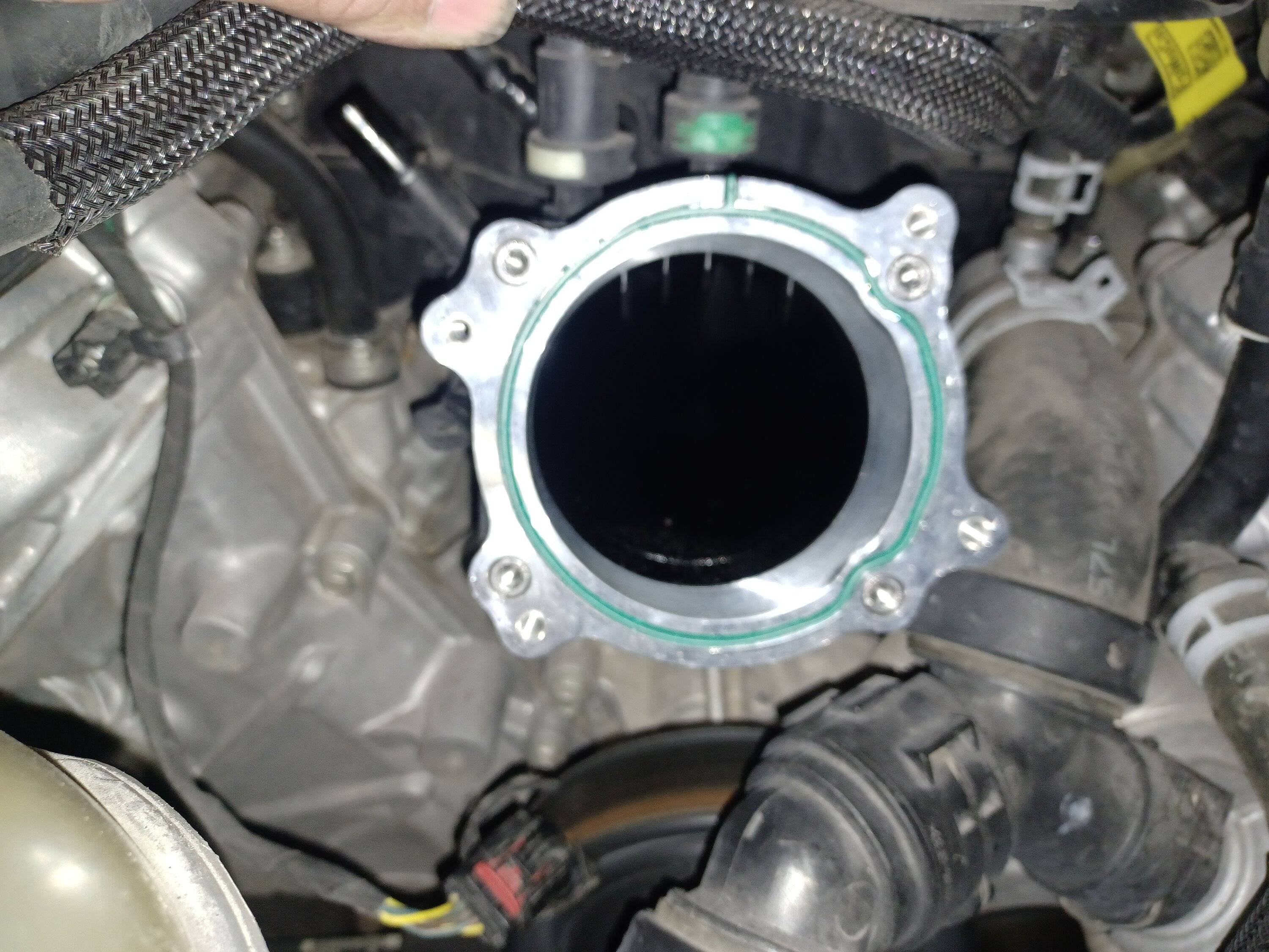

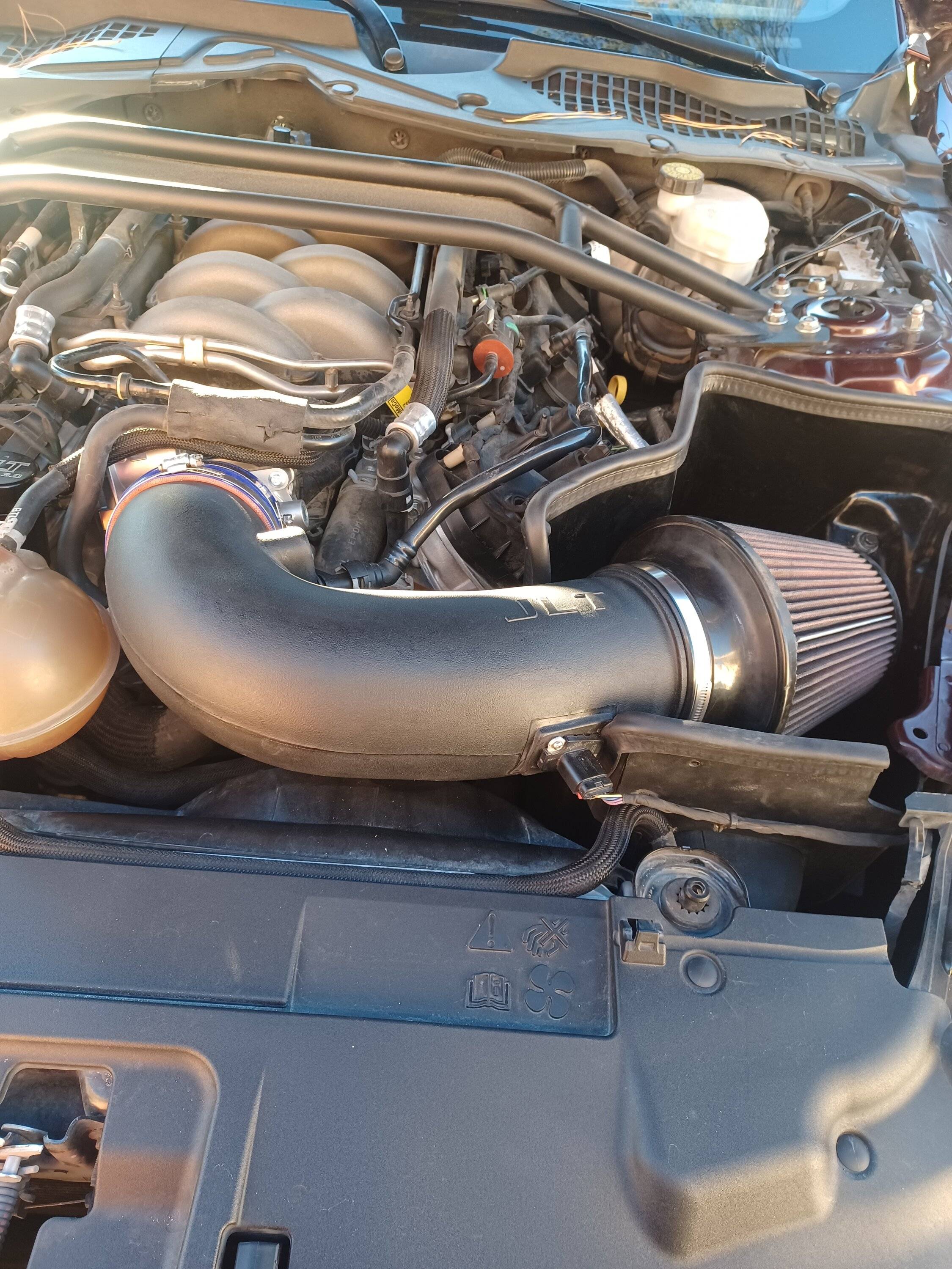

Couple things I tried to install it today since I got the right coupler it is 4.5-3.75 so thanks for that. But I used the adapter for the bullitt throttle body and it sort of makes it tilt to the left it looks weird but that's the only way it would go. Also the jlt now sits higher up and hits the hood. Got everything buttoned up and loaded the tune. It drove like a beast for about 5 minutes then the wrench came on which was a bummer.
I check all connections and everything is secure no leaks or what not. Couldn't do any datalogging as I wanted to but something came up so I had to put everything back to stock.
Any ideas on what could have caused the wrench?
Also any way to be able to tilt the jlt so the hood won't hit it

Tuned by juggernaut performance and yes it was tuned for the throttle body. I need to recheck as i was watching videos of the people installing the power pack 2 on cars since that kit uses the throttle body adapter and 87mm and I seemed to have installed the adapter the wrong way

Yes, according to this install your 180° out. I don’t see how that will throw a DTC.

Disconnect the battery (OEM tune loaded) flip flange to its proper orientation, reassemble everything, reconnect battery and reload the tune.
If you get another DTC reach out to your tuner.
