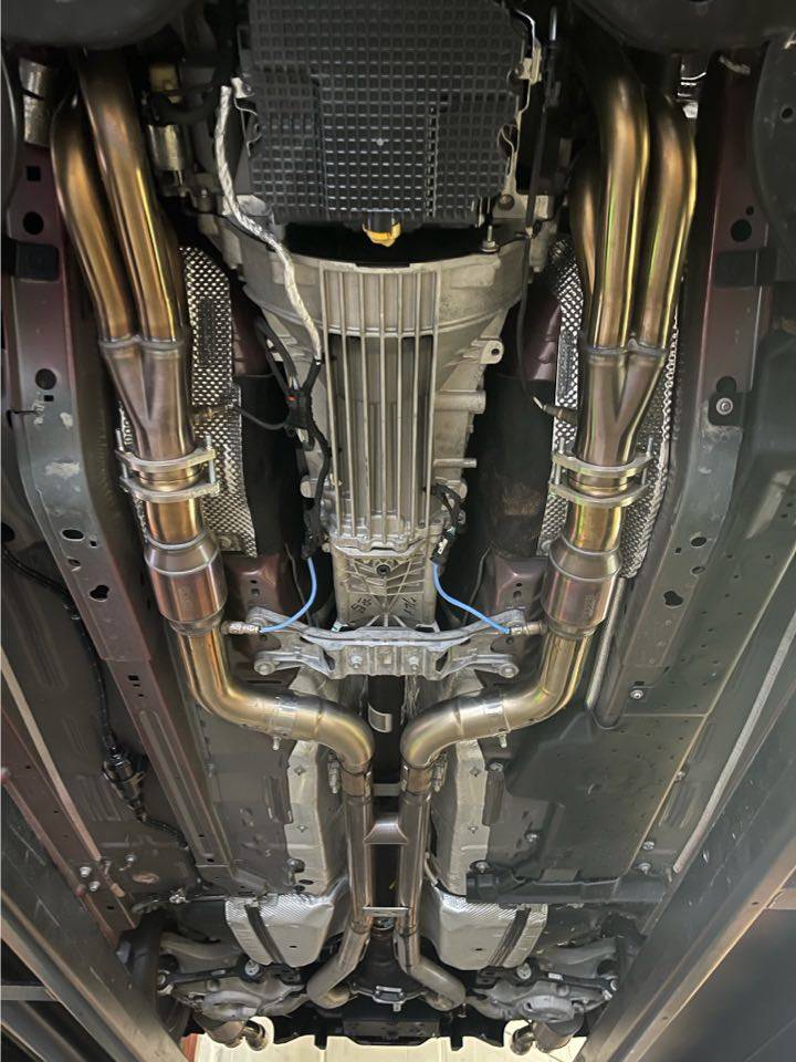

1/34 Kooks Headers and Exhaust longtubes with catted mid pipe

Steeda H-pipe

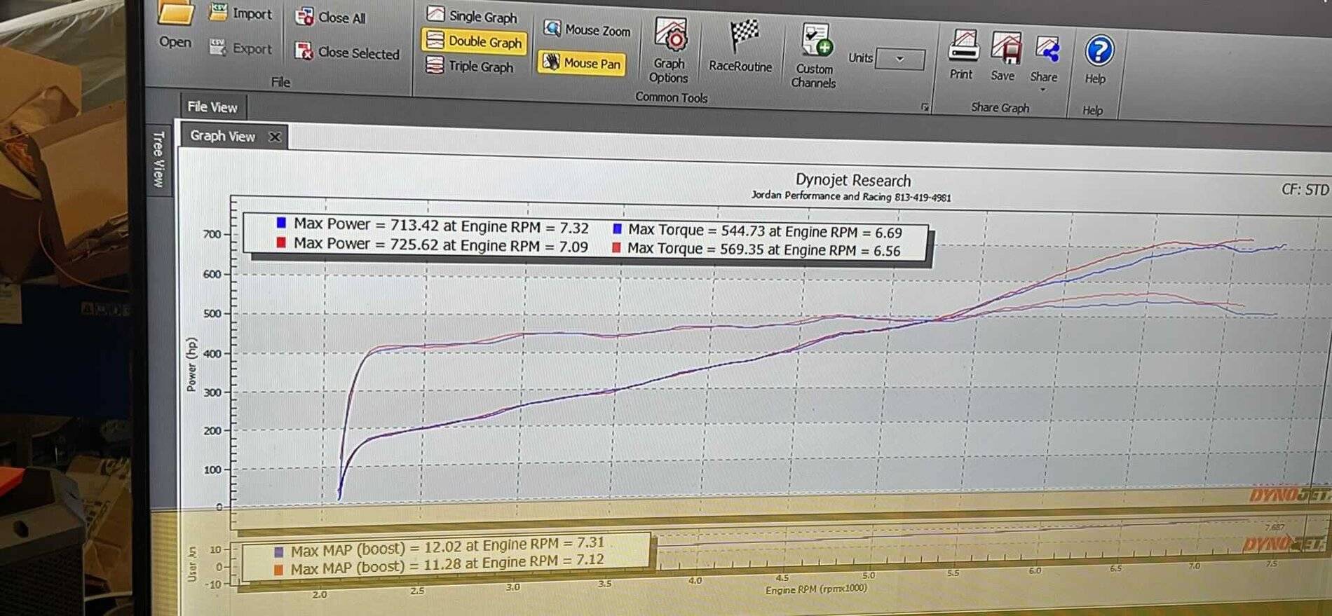

Final Power, Dyno Numbers tuned on in-house Dynojet)::
93 Octane
657whp on second pull. 6500rpm, torque 552, boost 10.46 - before tune
725whp at 7k rpm, torque 569, boost 12.02- after tune

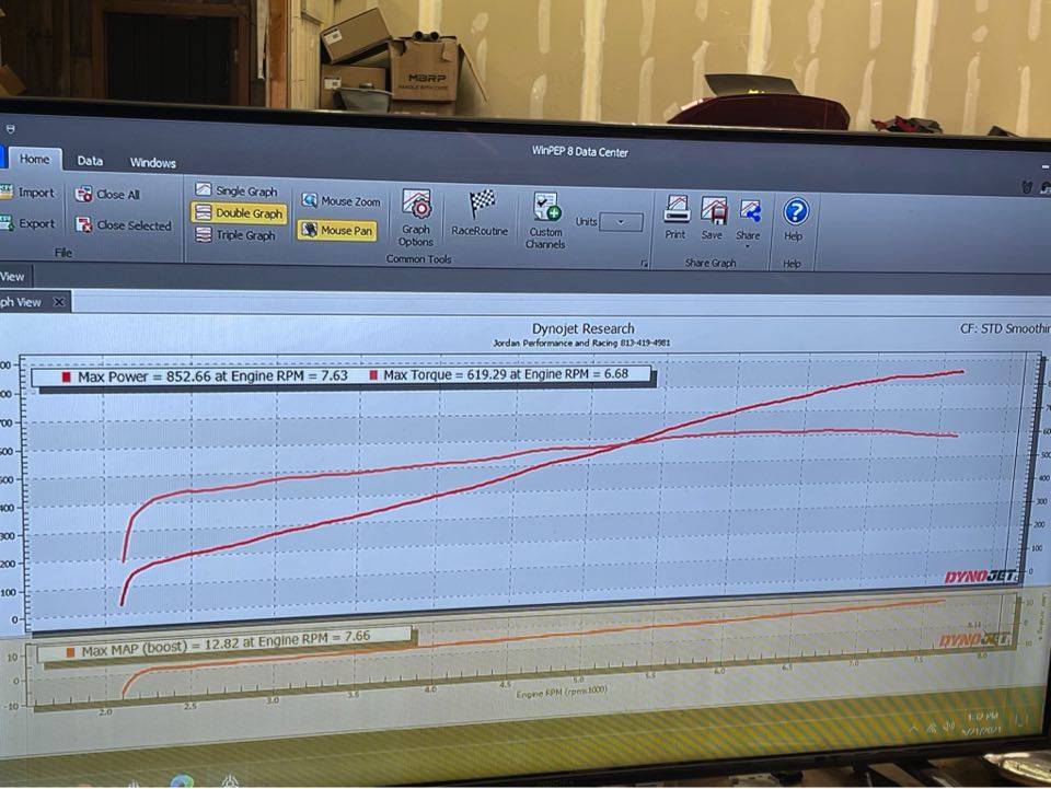

E85
852whp at 7.63 rpm, torque 619, boost 12.82
