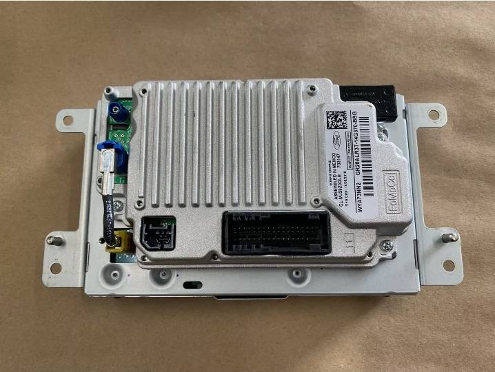

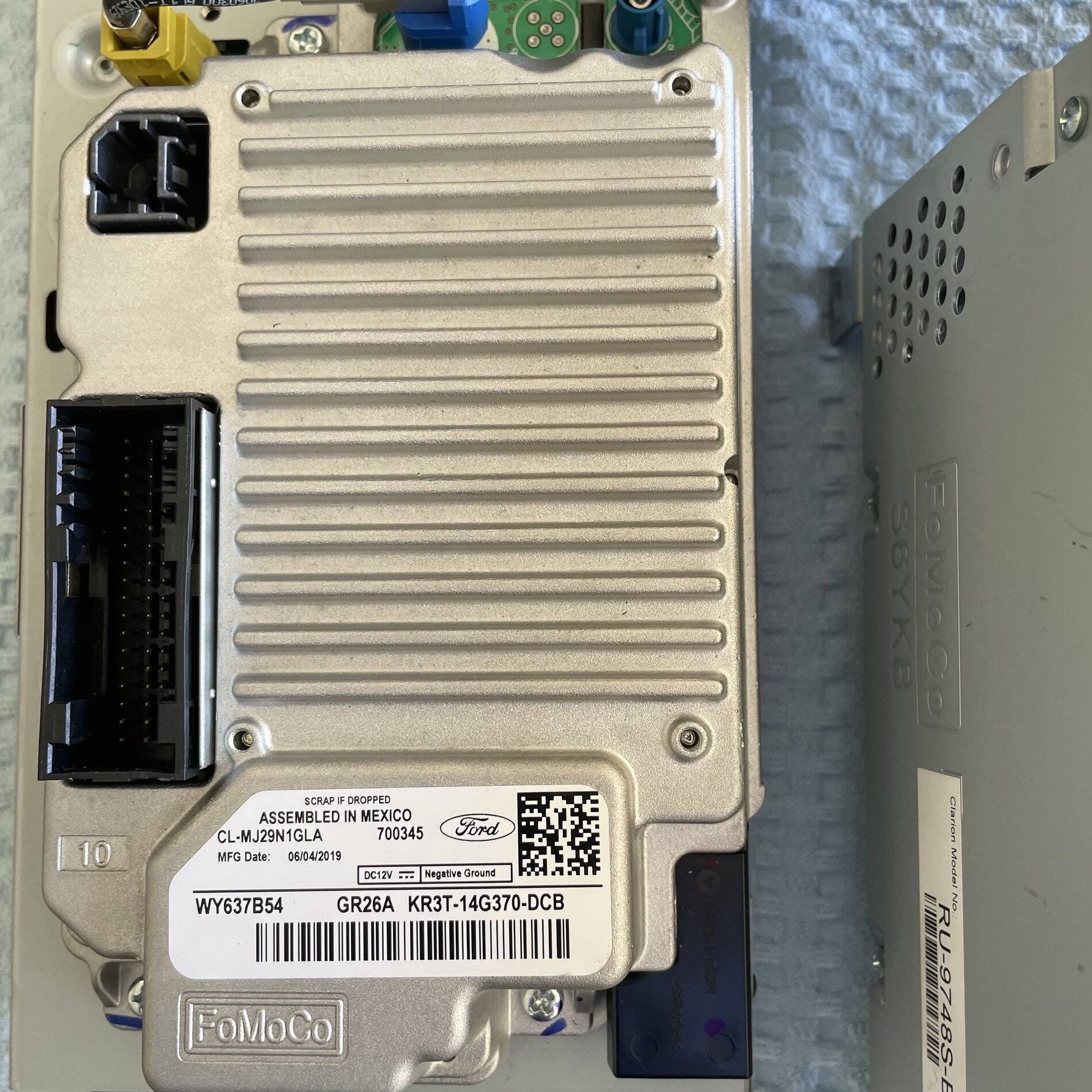

As far as I know the GPS antenna IS installed in the base cars, it was there in my '19 base GT. You may have purchased a non-Nav APIM.For reference here's an APIM with Nav (that I have for sale BTW), check out your part number for comparison. If I recall correctly, "371" parts do not have Nav

This is the one I installed

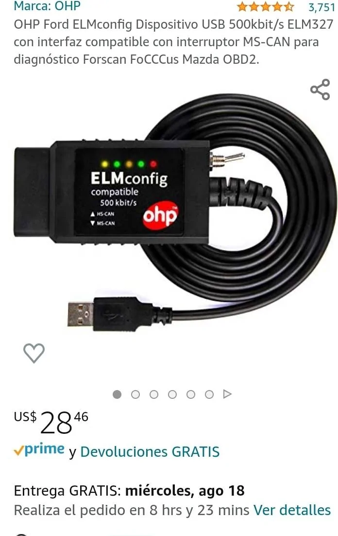

Do you happen to know a OBD2 reader that works with 2020, I bought this one but I cant even connect it. It barely plugs and when I try to pull my cars info into the laptop it just does not work
Pretty sure this is the one I have. I don't know if you can do this yourself with forscan, don't know that you can't either...
