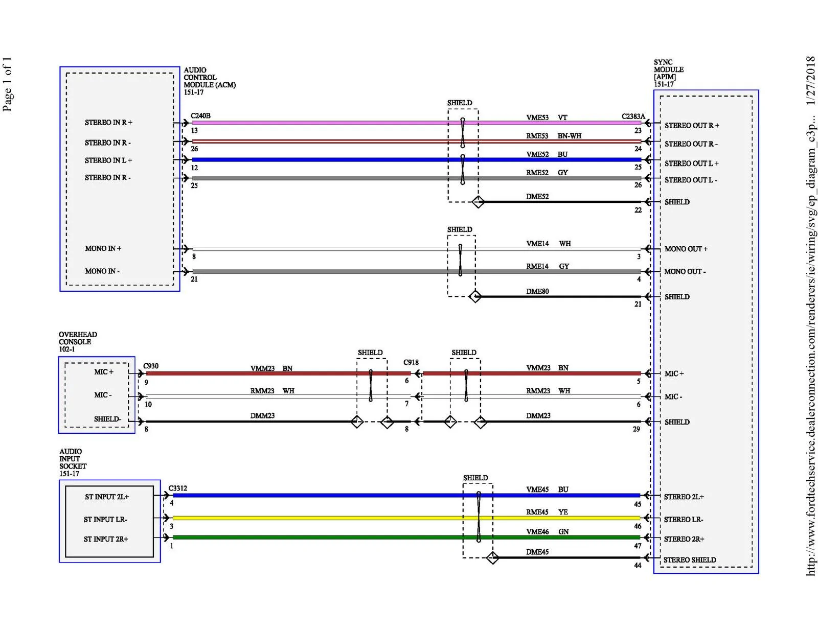

Is this what you guys wanted? If not, let me know. I also attached the pdf of this image (ignore the filename, it's just what I called it when saving).
Close, those are the connections that go into the CD Player. There's one connector with 54 pins on it that I think is the one.
