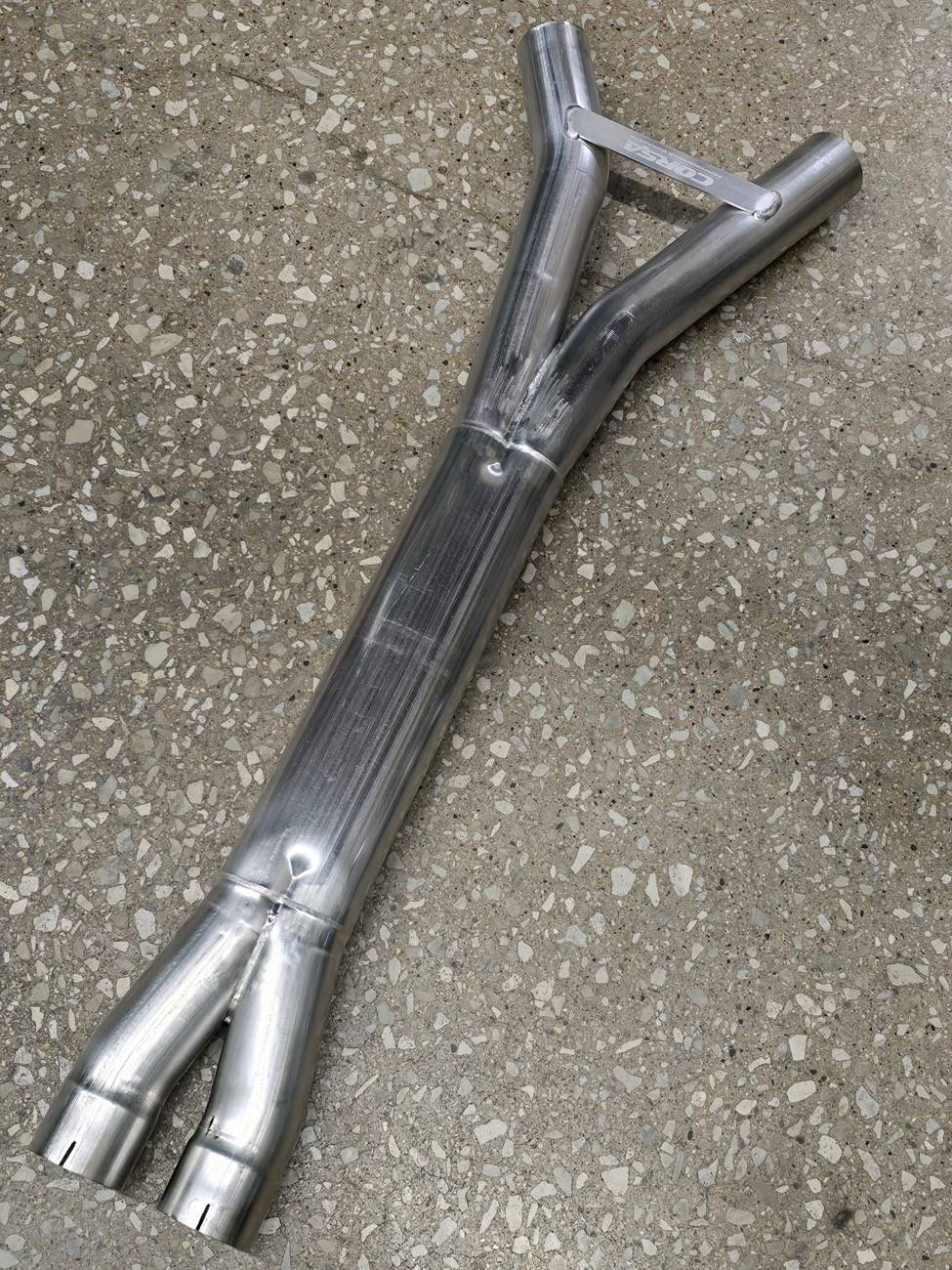

My guess is we were all hoping for something along these lines, but it clearly didn’t come to fruition. And this isn’t even a Voodoo, it’s a Coyote.
I really really really like the sound … to my surprise the rasp is no where near as bad as I expected and to be honest there really isn’t any super happy about that to say the least .
Post a vid when you get the chance. I think I’ve always been drawn to ARH’s full system with cats/res because it took away all the rasp.

I think we were all hoping for something along the lines of this
