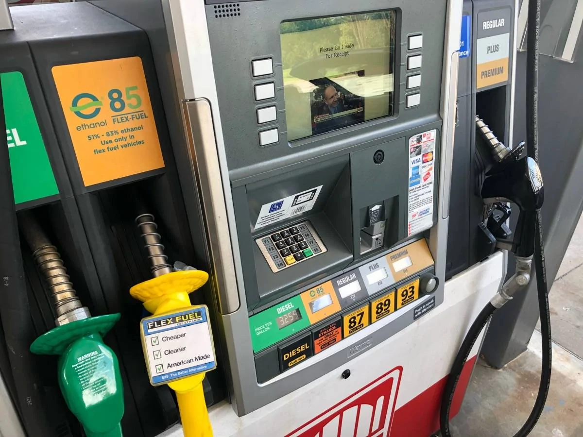

So I was checking out a station that has ‘e85’ near my house and on the button where you select the e85 type of fuel it states 51% ethanol.
So I’m wondering if other e85 stations have the same labeling and that is a minimum number for ethanol content or it stays around 51%. Is this 51% labeling standard for all these stations, etc?
This is a MAPCO station in north Mississippi.

Ok I did a little googling and found out in the US the minimum ethanol content is 51%.
Guessing that is a minimum number. Still wondering if other/all stations have 51% listed on their pumps.

I vaguely remember seeing something like that when I had a flex fuel tune on my car. Ethanol content varies depending on time of year and your location. For most people (and by that I mean people that drive cars that are flex fuel capable from the factory), this variation does not matter. For people running dedicated E85 tunes, they need to test the E85 regularly to make sure it is spicy enough.

The pumps here in CA are also labeled the same way, however they all dispense @ 85% ethanol year round.
If you have any doubts about the quality of your fuel, you can buy one of those testers online.

That's the advantage of running a flex tune is even if the content is lower you are safe. Standard disclaimer. AZ mostly has e54 aka flex fuel with occasional nice exceptions of real e85. As others have mentioned test and see what you are working with.

Yep, this is why its important to test your E85. The number typically drops lower in the winter because true E85 is difficult for a car to start in cold temperatures. I got tired of testing so I just installed a flex fuel sensor on my car so when I fill up I can see what the ethanol percentage is. Another way to check if your E is good is to check your short term fuel trims (on dedicated E85 tunes only, not flex). If its really E85 there will be hardly any trimming.

Like the others posted 51% is a Flex Fuel Ethanol, The fuel selector should say Flex on it. I've seen one pump labeled like that.
Flex Fuel Ethanol can run 51%-83%. You need to check it to see what it actually is.
A couple local stations to me have flex ethanol and the selector actually sez Flex Ethanol Content 51%-83%. They distributor fills that flex ethanol with 70% winter blend and 80% summer.
I switched over to corn this past weekend with flex ethanol and it tested 78%.
As for ethanol pumps, You can have E15.. E30.. Flex and E85 on tap.
Bad thing about corn,, it doesn't last long in a daily driver, 180miles and I'm filling up again.

The pumps here have a big range listed, like 51-83%:
If I go back to E, I'm going to get setup with a tester, curious what's actually being pumped.
