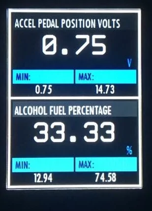

How To: Display Ethanol Content on SCT Device

I think the tuner has to check something in the tune itself along with the download to the device.

Verified it works. Folks need to go to the datalog options and select the new log file to see the Alcohol percentage after downloading OP's file

Wow! Glad this is still working for people. I should update the parameters on that file. I think it was missing some common things if i remember right.

I added the configuration file to my sct x4 but it doesn’t show alcohol percentage! What I’m I missing in here ?, and what is an OP’s file ?

So turns out the Lund tune doesn't log alcohol percentage on the e85r file. Only logs alcohol percentage on the flex fuel and 93r tune. The e85 tune assumes you have at least like 75% ethanol so doesn't even log it.
Switch to the Flex Fuel tune then try to load the config file.

Thanks
