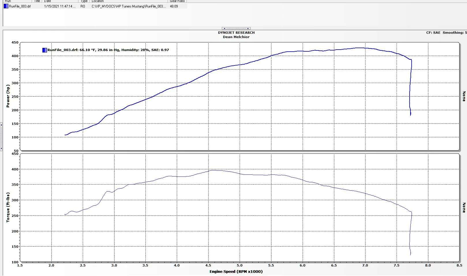

Do you have any logs from the dyno runs or street? Something does seem a little off or WAY too conservative than necessary. my 2020 A10 car made comparable and better in the mid range with only S-type Borla cat-back and some basic tuning.

I do not. However, I plan to switch back over to my Wengerd tune. Nothing against my local shop/guy; however, they are more of a Dodge shop, and I also believe the tune could be optimized.

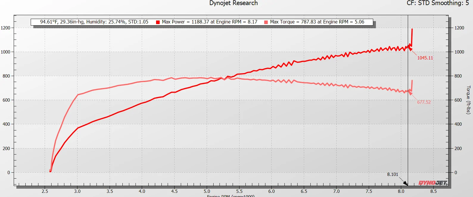

3.8 Whipple 3.25 pulley 6 rib stock lower 1045RWHP. Stock sealed Gen 3.

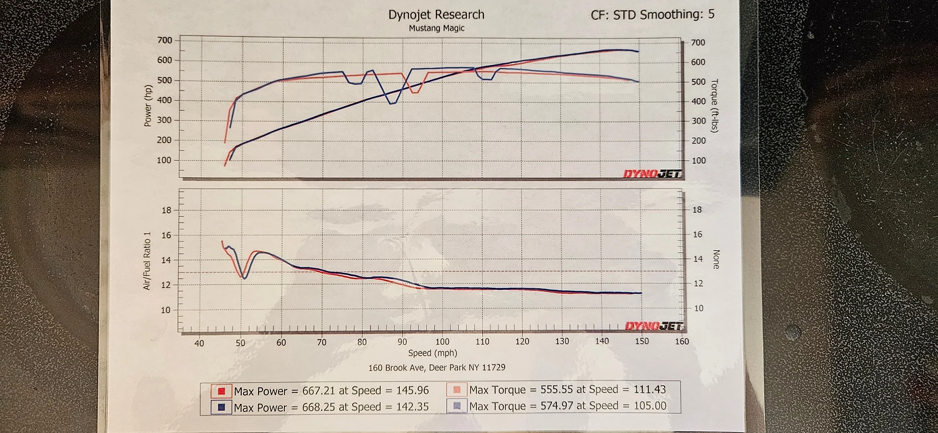

2020 GT MT82 with Roush 2650 and LTH on the stock Roush tune. It was a busy dyno day that got stared late after issues with the dyno so I never got to ask them about the dips in torque. My guess is interference with the tach signal 🤷‍♂️

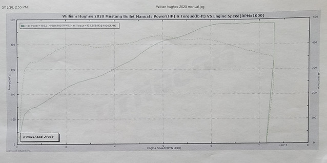

2020 Bullitt just tuned at 5 Star yesterday. Runs clean and the gas mileage on the way home up I95 was 27.5 cruising at ~80mph 2200 rpm's.
All stock intake, on the Bullitt's, it is the GT350 intake, Throttle body and air cleaner/box. Only mods that were added was Stainless Works LT's, Gesi hi flow cats and Stainless Works H pipe. Kept the stock active exhaust/muffs.
486hp @6900 rpm and 435 torque @4900 rpms. Runs clean and strong all the way. happy with the outcome for just exhaust mods and the GT350 intake stuff.

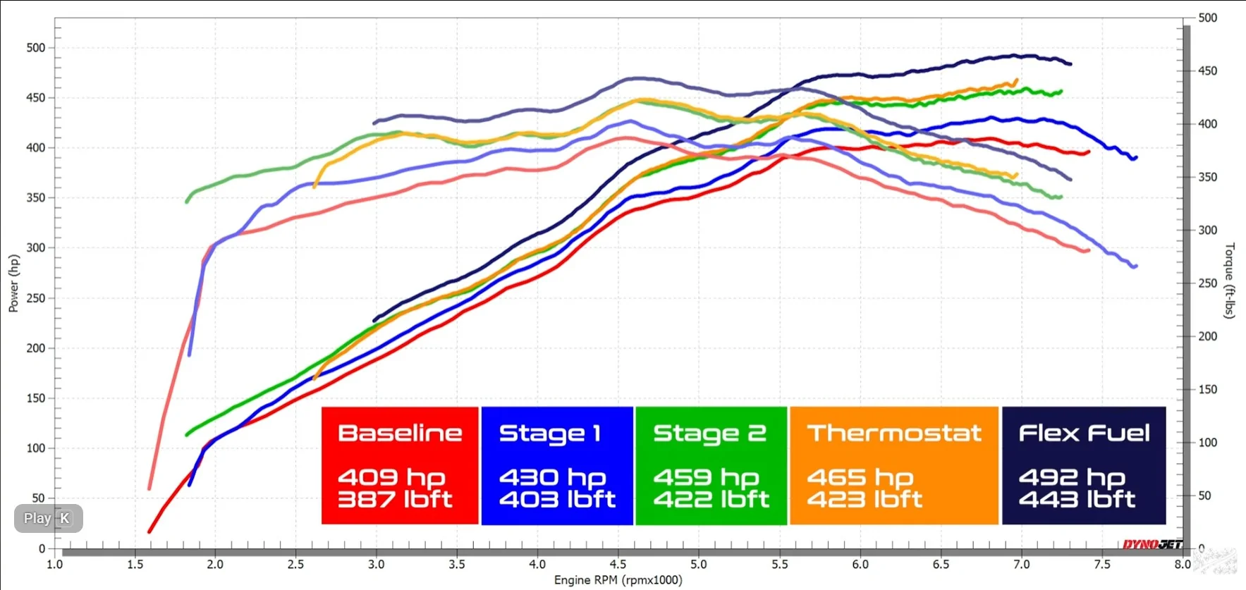

Blue is JLT intake, Green is long tube headers. I got this from National speed youtube vid.

Thanks! I was hoping to see something with the Steeda Max intake since it’s a different diameter.
Slap in an X-Pipe and good weather to get you that 500 number. Or go for the GT350 intake manifold and 87mm throttle-body, to get more air into the engine.
