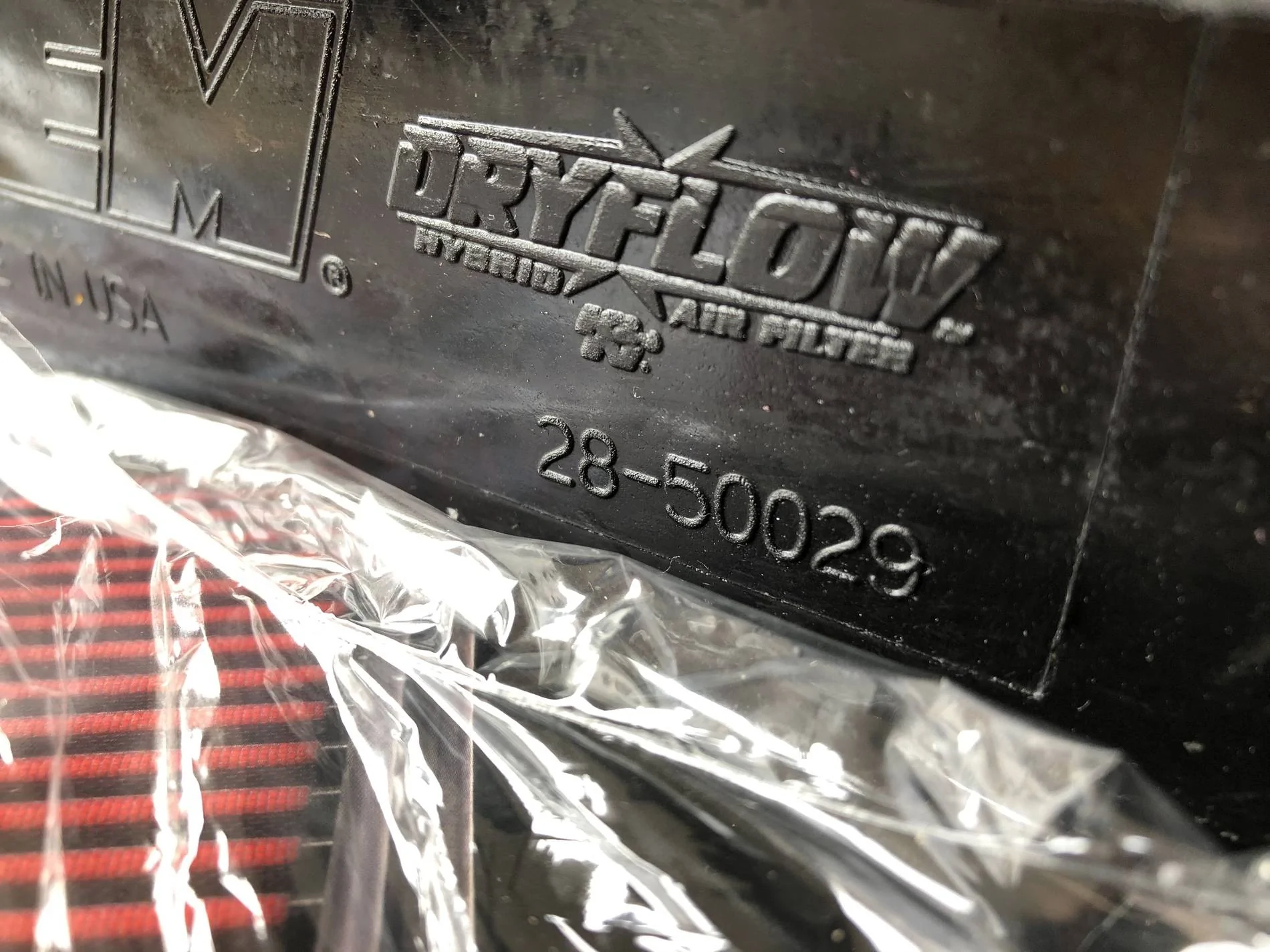

No comparison for you - but I went with a dry filter rather than a oiled type.
I picked AEM (over AFE) after reading through threads on here.
Turns out AEM is K&N’s ‘dry’ brand.
Some guys have had great (independent) Dyno results with the AEM - there’s a few threads on here with numbers / plots :like:

Thanks where can I buy one from?

Cheers buddy, I'll get one ordered
