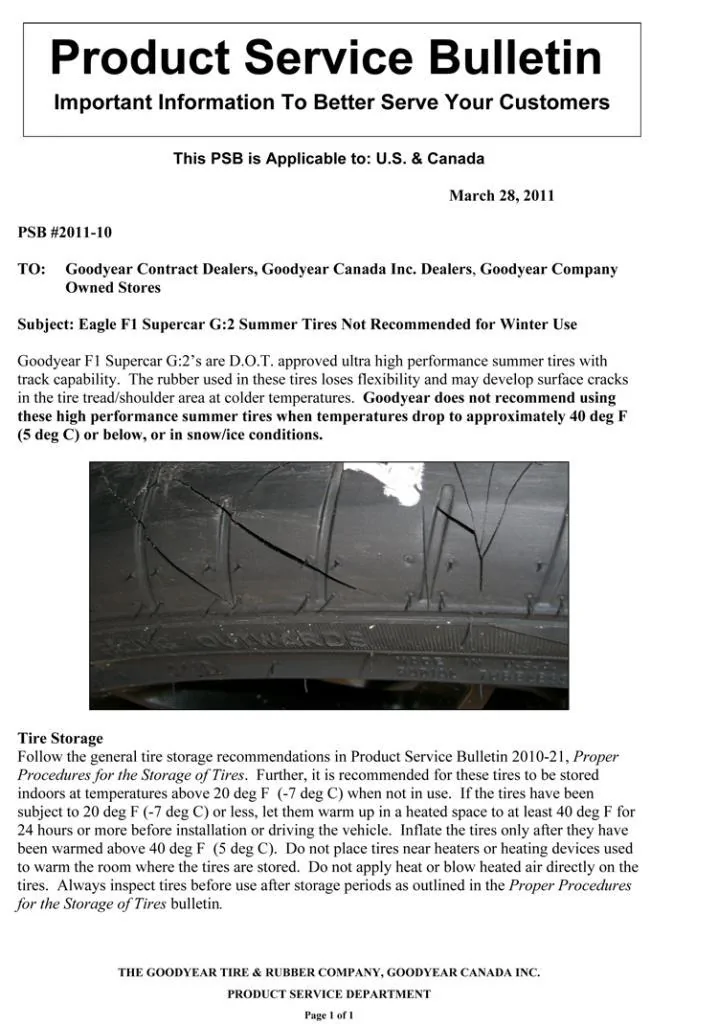

Here is a Product Service Bulletin from Goodyear. Not the tires on our cars but made out of similar compounds.

They lose grip when cold but thats it. They don't crack. You guys are crazy. :D
They actually can crack if the temp gets low enough. If the temp goes below the glass transition temp, that's when the cracking can happen. The transition temp depends on the compound and its impossible to say without analyzing the tire.
