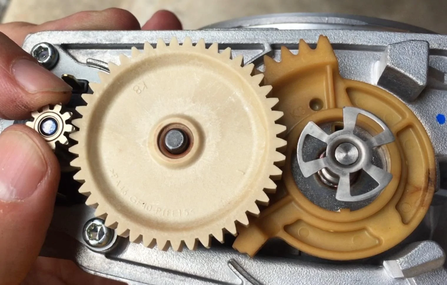

My guess is the gt350 probably has a TB that is some what over sized. To solve the bucking issue with a large TB the computer gets involved.

I hadn't thought about the one big throttle body being associated with the issue but that sounds like a good point. I had looked into ITB assemblies out of curiosity but there's nothing plug and play or costing less than a small ton of money.Maybe they should have used ICTBs![]()

Since the 2011 Coyote, the ECU has used a selection of predictive measures to know exactly how much air will go into the cylinder one or more crank revolutions before it happens. The link between commanded torque and throttle angle is very precise and takes into account the time to fill the manifold. I've measured the delay on a Coyote and it's negligible.My guess is the gt350 probably has a TB that is some what over sized. To solve the bucking issue with a large TB the computer gets involved.
Ah maybe!! I put oversized TB on my last car and i hated it, youd hit a pothole and start to buck drove me nutsSince the 2011 Coyote, the ECU has used a selection of predictive measures to know exactly how much air will go into the cylinder one or more crank revolutions before it happens. The link between commanded torque and throttle angle is very precise and takes into account the time to fill the manifold. I've measured the delay on a Coyote and it's negligible.
However, for a variety of unknown reasons, they have created delays and slow ramps in the pedal processing before the commanded torque tables. I have no actual idea why they did it, but the most obvious purpose would be to maximize fuel economy on the prescribed test route for EPA testing. Unlike a famous German company that disabled all this rigmarole for everyday driving, Ford uses it in testing and it stays in place every time you drive your car.
