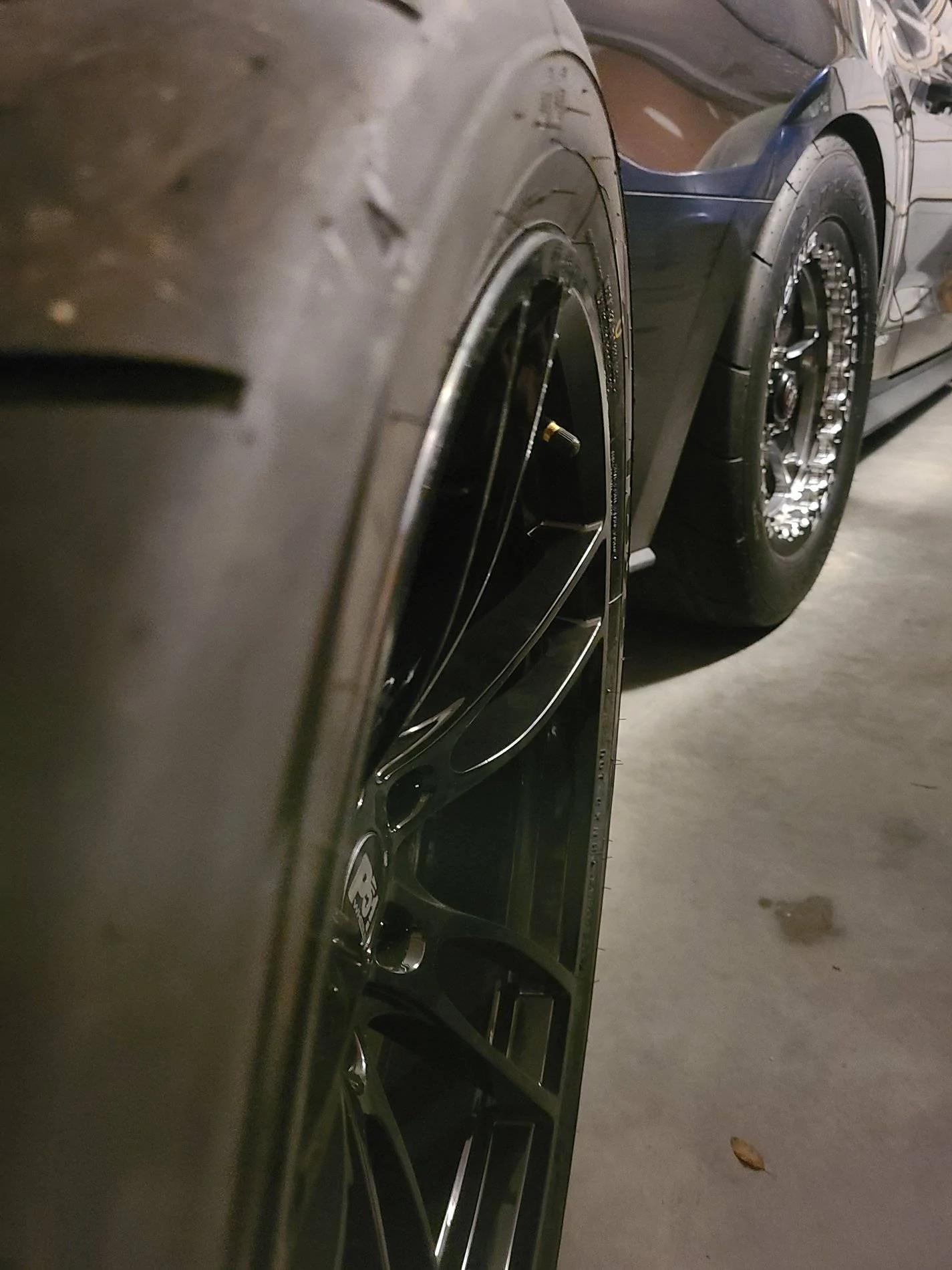

I have 325/30/19 R888Rs (some tires may fit differently?) on a 11inch wheel. Fits fine, will upload picture in a minute.

These were the best I could get to show bulge length and "poke" on the car. Don't have many pics with them on the car currently.

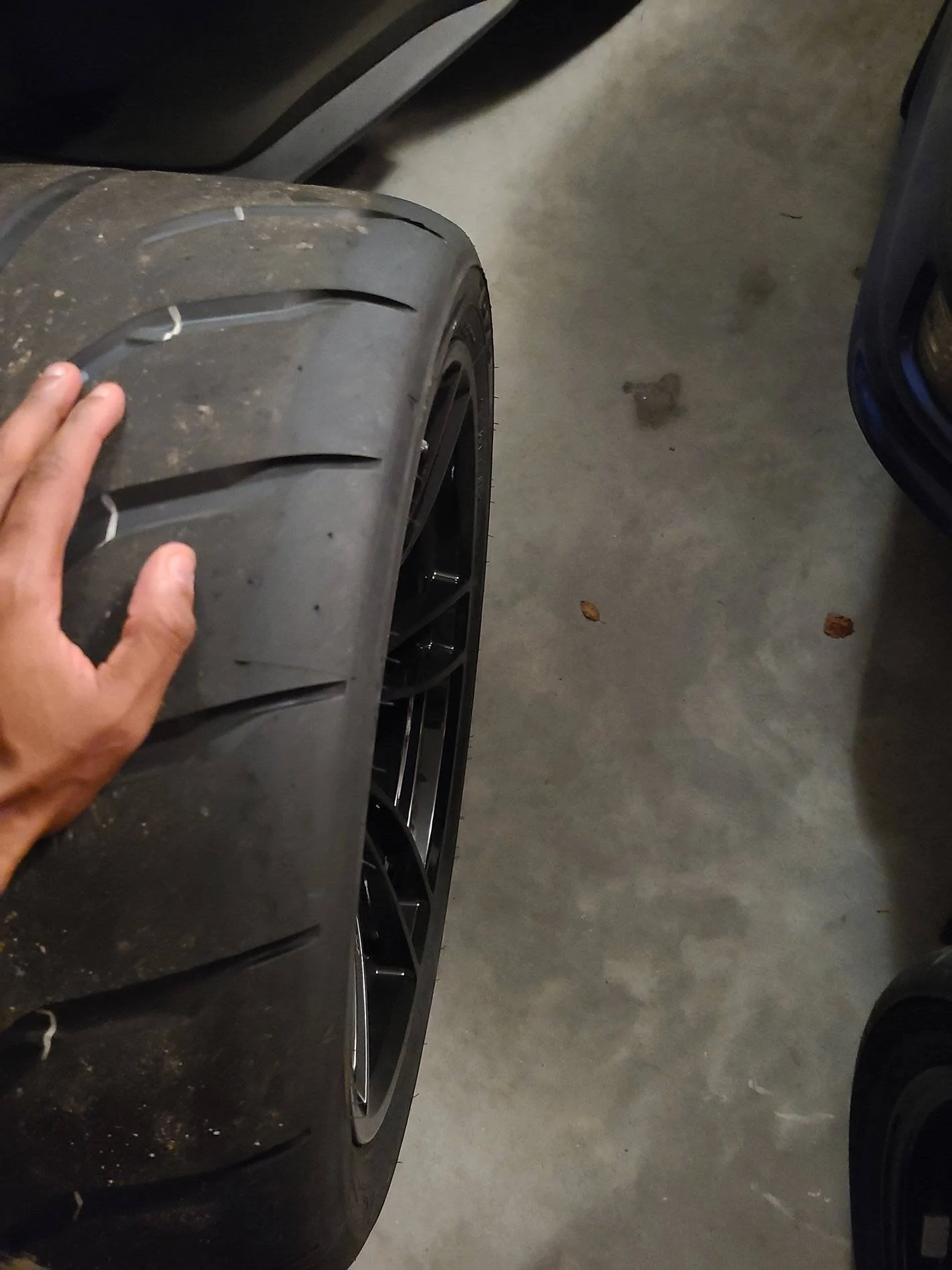

No problem. And I know this isn't the best quality lol but here is how it fit on the car:
No real poke

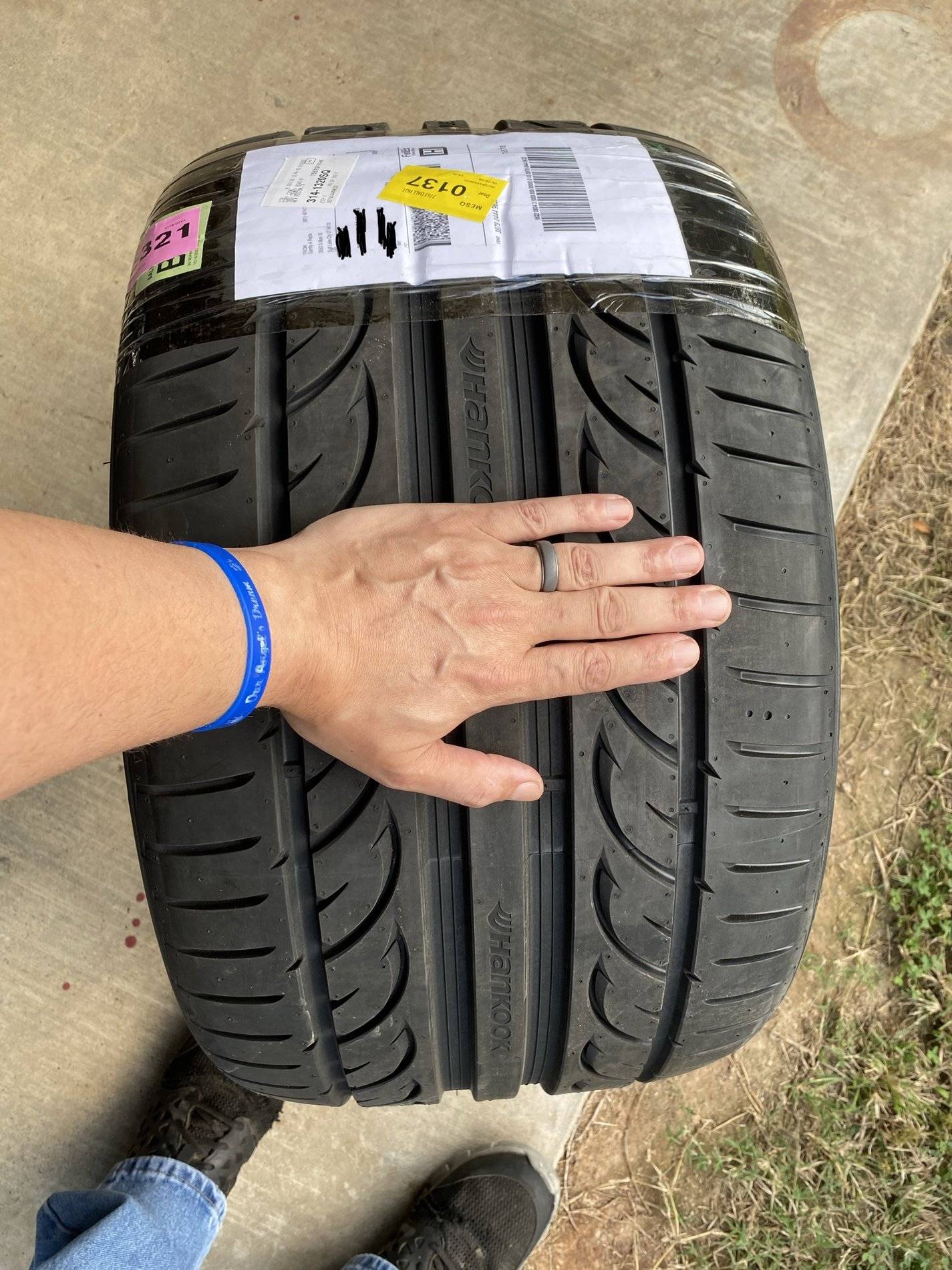

I got my rear SP2s in 19x11, still waiting on the front wheels to be available. Have one 325-30 already. Just ordering a piece here and there. It’s my daily so I’m not spending money for expensive tires that won’t see the track.

sorry, what tires there? Those look meaty but far more manageable if caught in the rain and or temps drop (I live in NH.. it happens)
They’re Hankook Ventus V12 Evo 2. They have good reviews and treadwear ratings.
