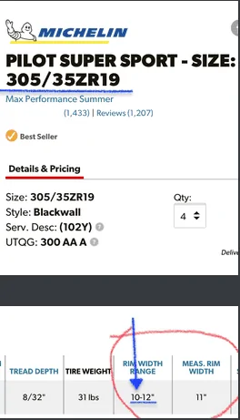

I am always a wide-rim, big-tire footprint driver. OP can afford the 11 rims, best choice, as I would if in his shoes.
10 rim not having what it takes to run the 303/35Z19 is one man's opinion. Michelin apparently disagrees.
