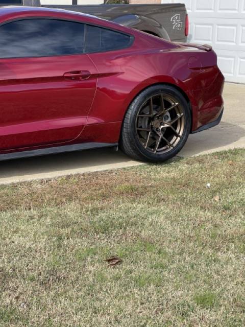

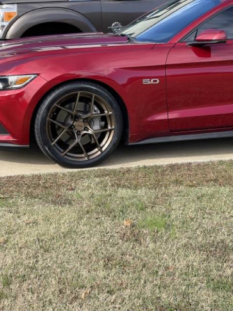

Pictures are worth a thousand words. I know these are not PP 19" wheels, but they are of a similar design on 20". The Front wheels are 20x9 32mm offset with 275/35-20 and the back are 20x10.5 45mm offset with 315/35-20s. I would expect about the same bulge from 305s on 10 inch rims. Only difference I feel driving is the wider tires from the stock setup of 265/35-20 and 9" rims front and rear is the back seems to want to follow the depressions from big trucks on highways if I am not paying attention similar to what my wife's jeep wrangler does with 305s on 10" rims. Personally, I like a little bulge, saved me from scuffing rims the other day when my wife was driving and pulled thru an ATM drive and hit the curb with the front tire. The bulge kept her from hitting the rim as the tire woke her up and she got off the curve quick.
If nothing else this will give you a feel for the amount of bulge you will see.

That fit and bulge is perfect. Are those with lowering springs or spacers?

Not lowered and no spacers.

When I ordered the wheels, I had ordered 305/35-20s for the rear 10.5 rims and 265/35-20 tires for the front 9 inch rims. Got a call later that day and was told the tires were on a 60 day back order. This car started as my toy and since Diesel is so high for my dually, I use this as my daily driver now. I like the look of old school muscle cars and am old enough to know I am no race car driver and don't need the extreme performance that many want. I ordered these tires and wheels for my winter tires and ordered all season radials. Any way, sorry to ramble, I got the guy to see what was available and found the Nitto Motivo in the size listed above (275/35-20 and 315/35-20) available and that was what I had him order. In the spring I am going to check into a set of Variant Krypton 20x10 for the front and 20x11 for the rear and put summer tires on them in a 285/30-20 and 305/30-20..

Wow, that's perfect then. I also don't mind the ramble, more info for me!
