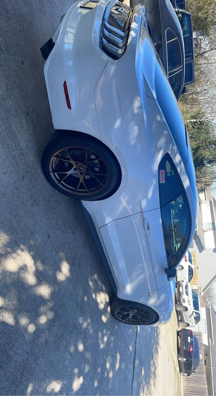

Here's my setup with no rubbing.
20x10 Front, Offset 35mm, BF Goodrich G-Force 275/35
20x11 Rear, Offset 50mm, BF Goodrich G-Force 305/35
Steeda Progressive Springs 1" drop
