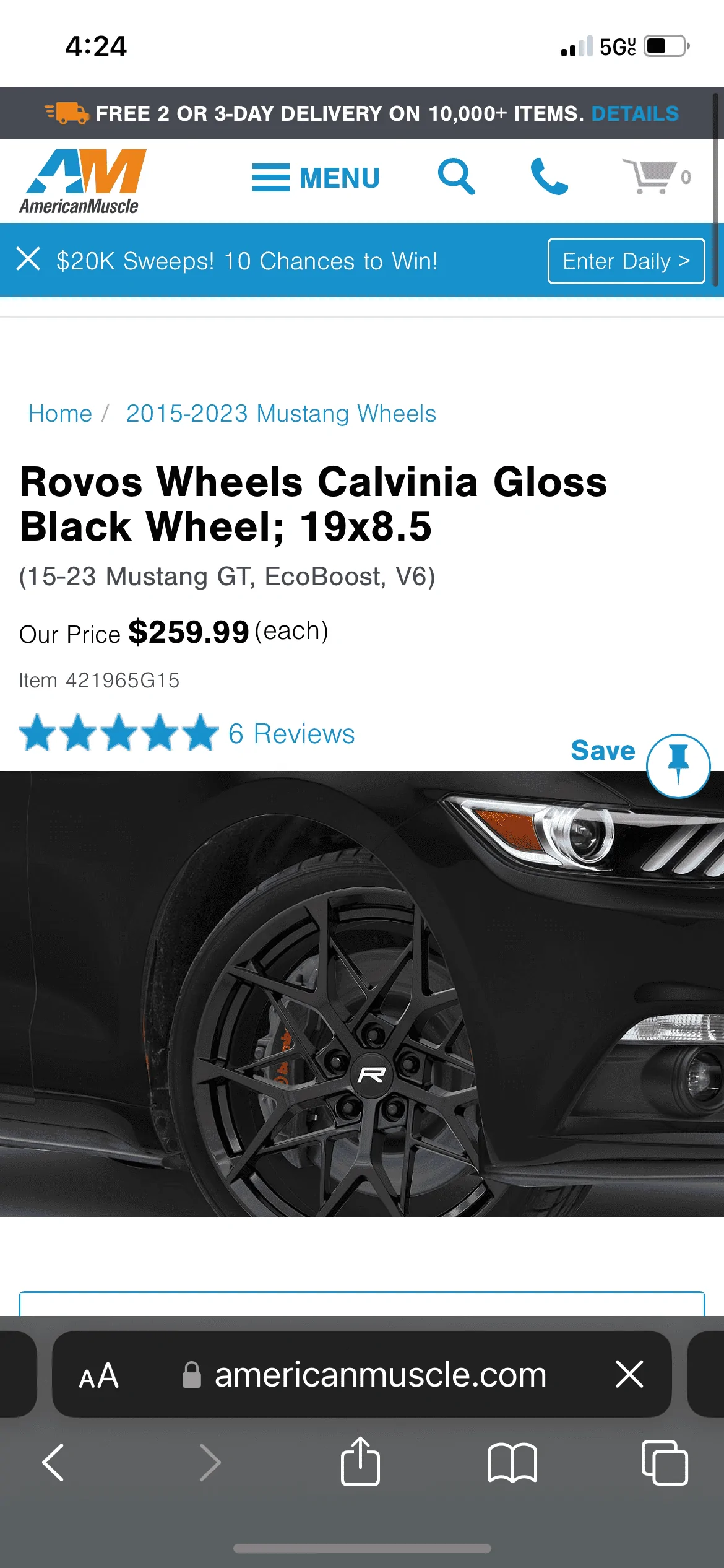

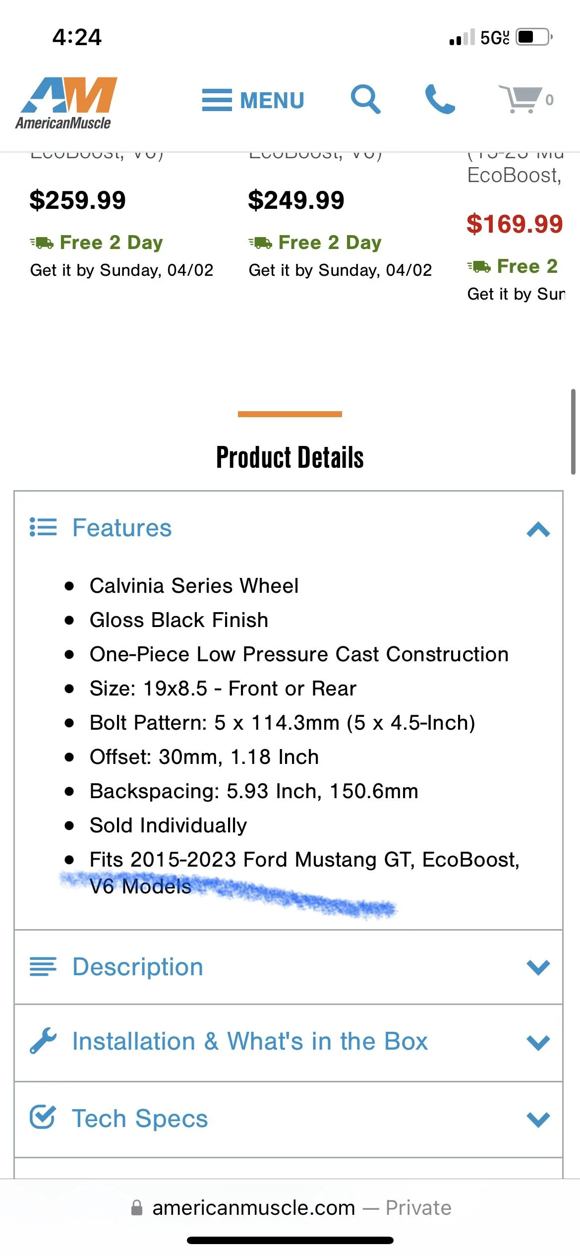

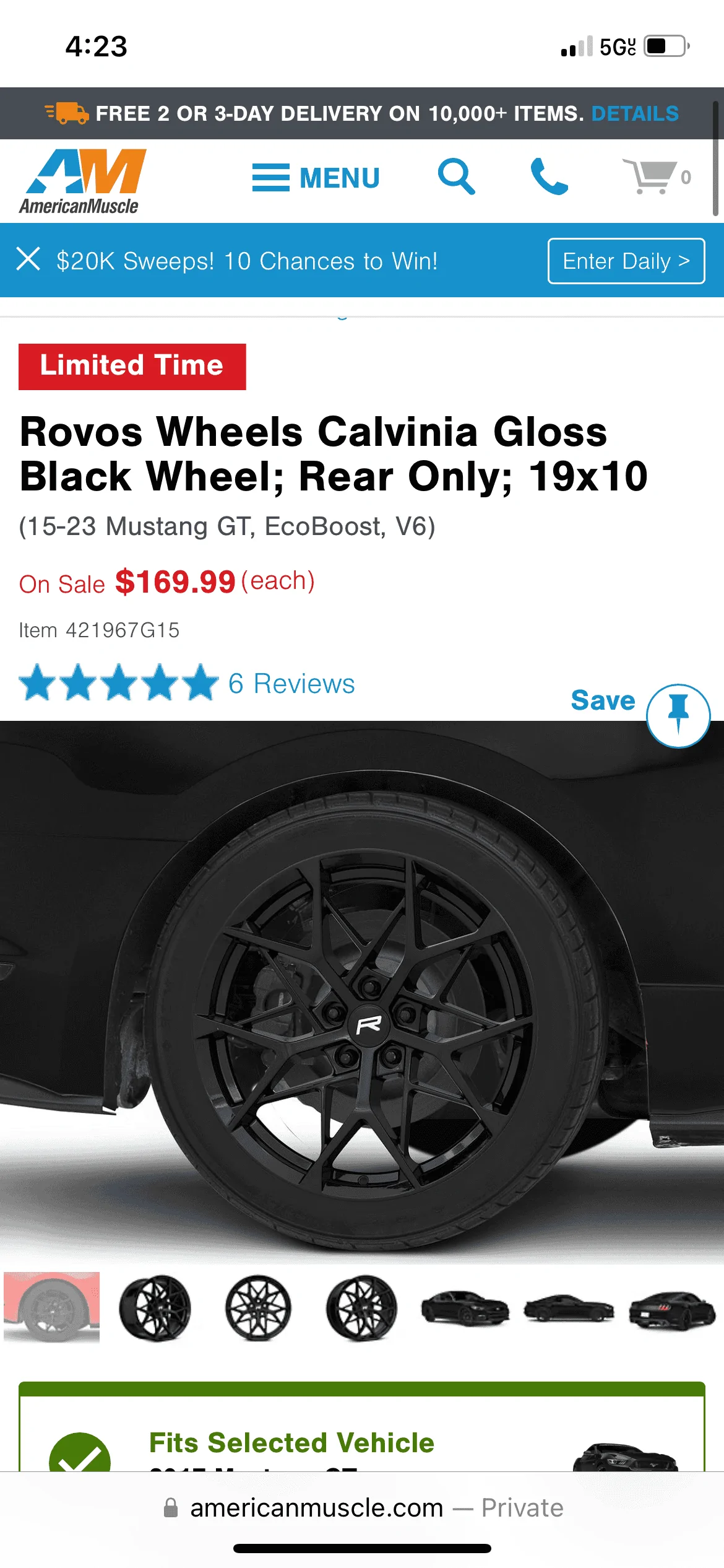

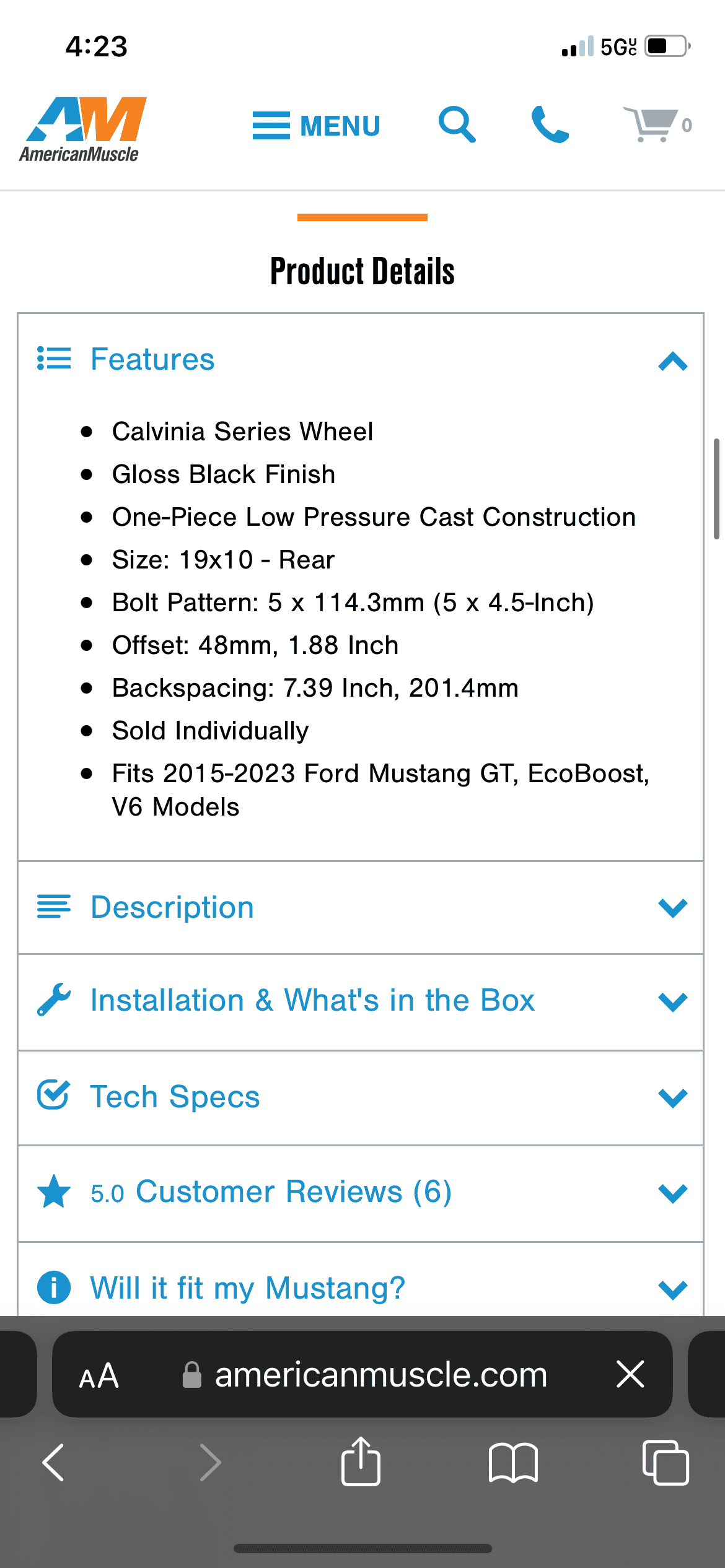

Trying to figure out wheel and tire figment on my 2017 mustang pp1. I’m lowered on eibach sport line lowering springs. I’m planning on getting a new set of wheels for summer driving tracking and drag racing. The wheel size I’m planning on going is 19x10 and 19x8.5 willing Chang it if told differently but wondering what my best options for tire sizing is, I’d like to go 295s in the rear but I’m worried about rubbing. Here’s the wheels I’m planning on doing

Depending on how low it is I'd run 295/35 or 30/19 and 255s in the front. Im pretty sure a 295/30/19 would be absolutely no rubbing, but 35 will be closer, if the offsets are right of course.
