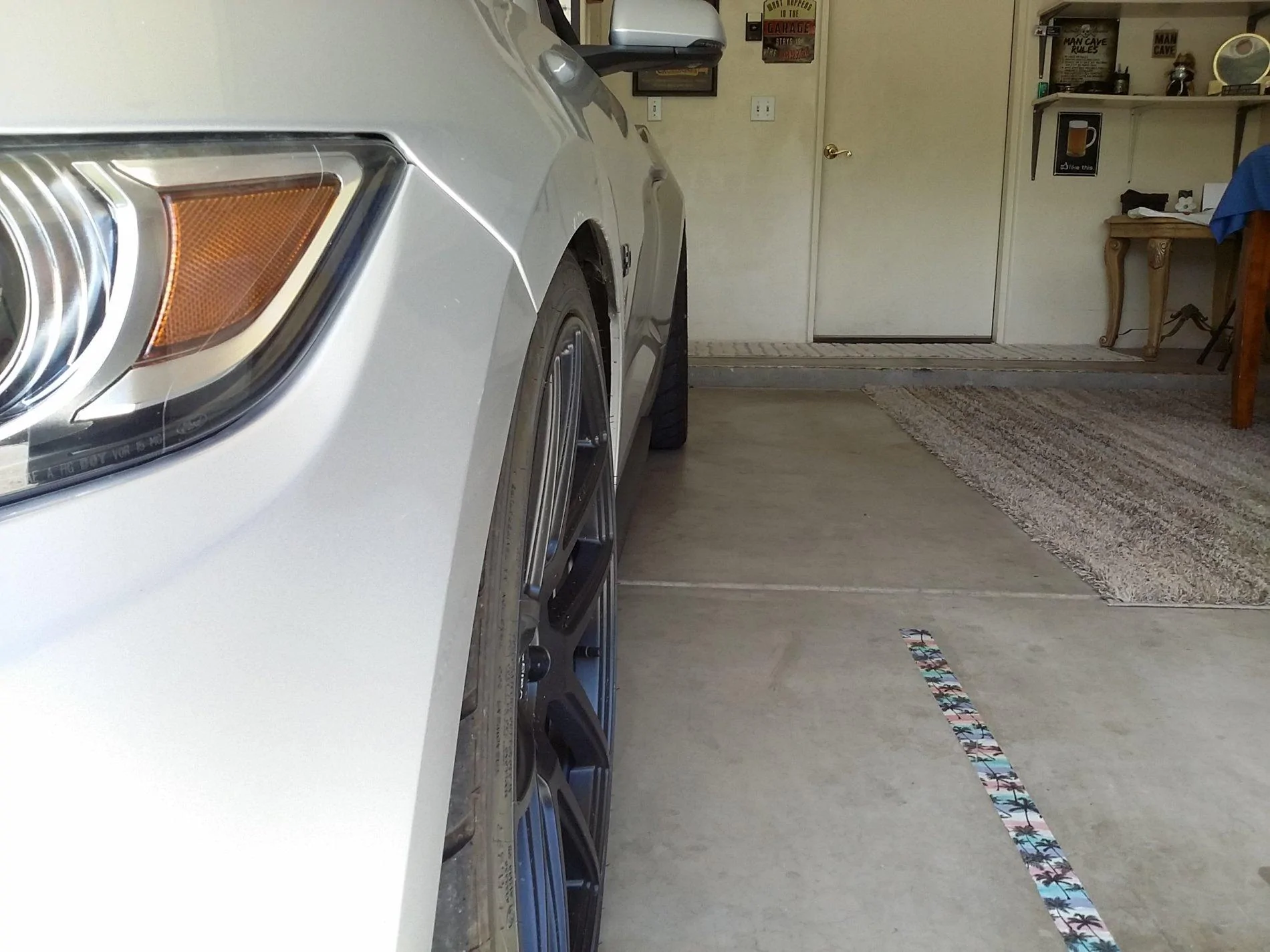

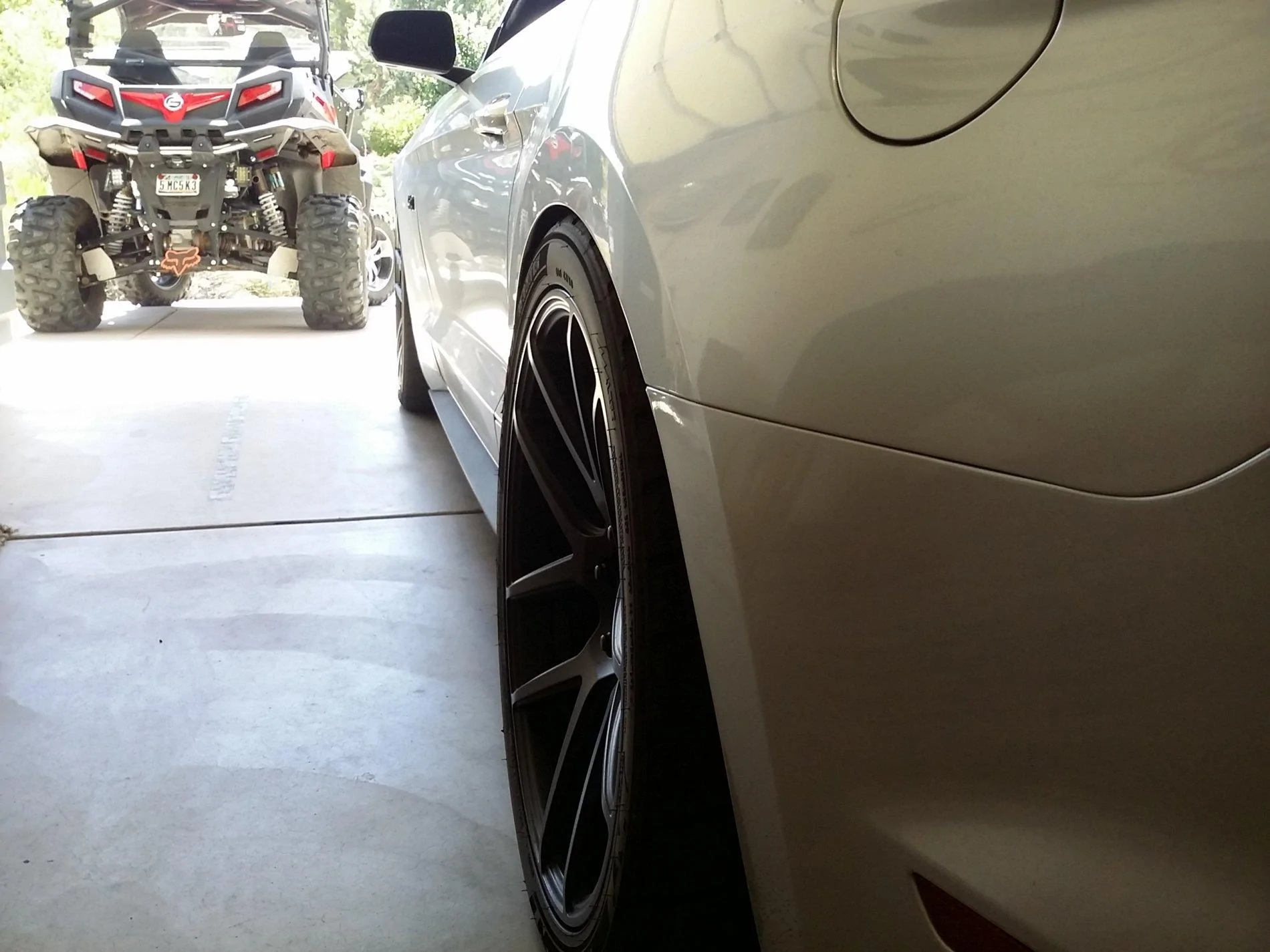

I went from 265/35's to 315/35's and my speedometer is off apprx 3mph. Now, if you want to get real technical, when figuring in parallax (angle from driver's position to the speedometer needle) it's almost dead on.
