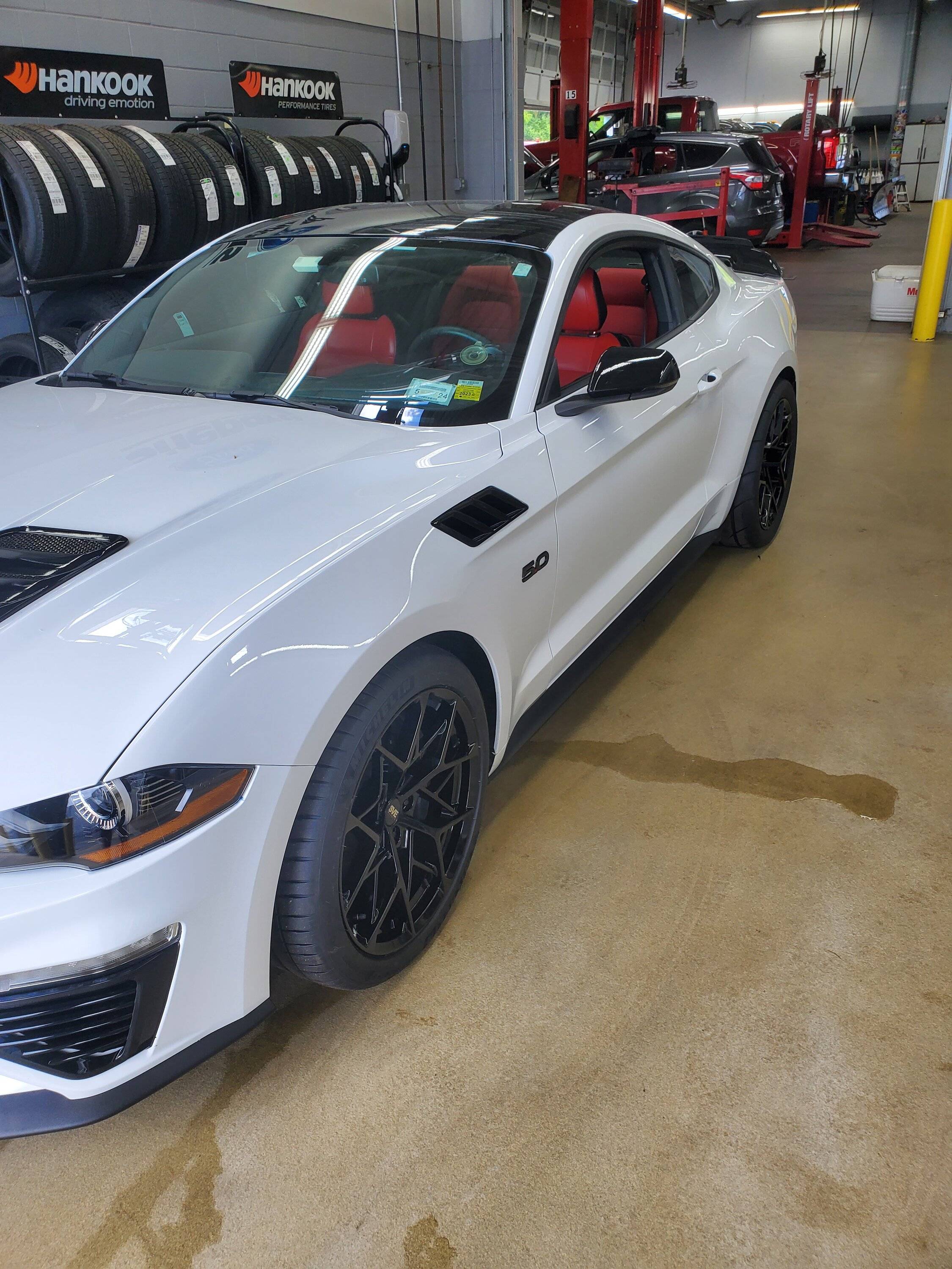

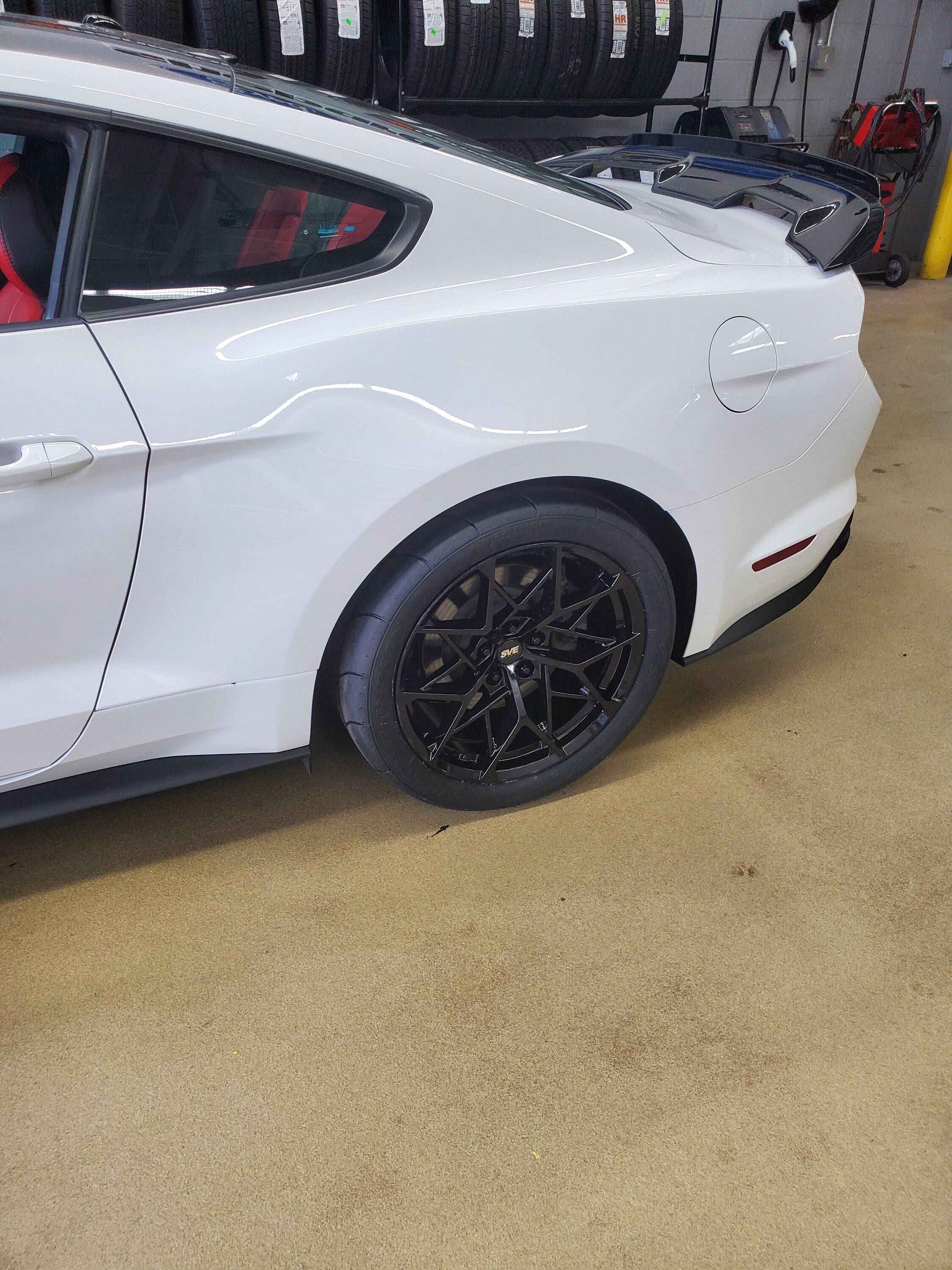

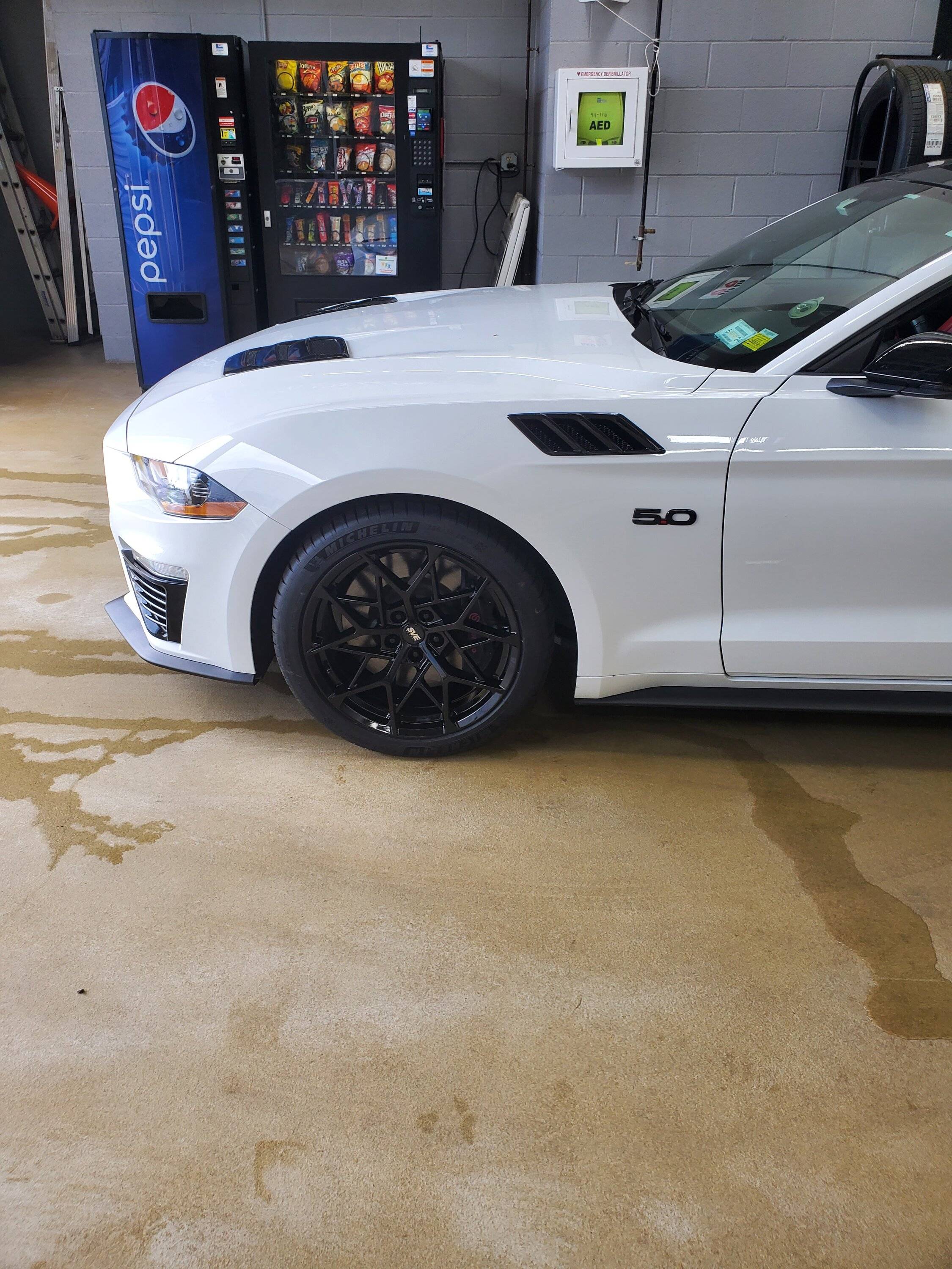

I went with 285/35/19 in the Front and 305/35/19 in the rear
Fronts - Michelin Sport 4S
Rear - Mickey Thompson Street SS
