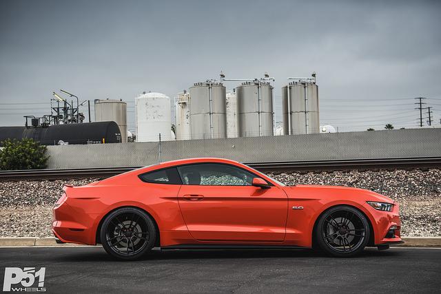

i run a 285/30/20 on a 20x10+35 and
305/30/20 20x11+50 set. all depends what doing with the car and how low. i'm over 2 inches lowered. pretty much one finger gap all 4 corners. more sidewall is better for drag.

https://www.mazdas247.com/members/White%206s/p51-1m.jpg
Convertible, fun car, shows, no AX/tracking or drag for that matter - just some occasional "spirited driving", nothing on the street more than 7/10ths :D
