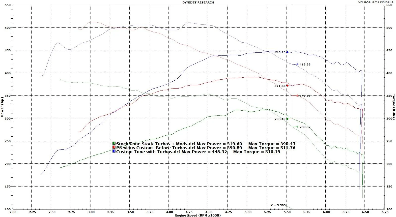

Here is a comparsion of stock ecoboost turbos vs the drop in upgrade "GT" / "BW Ford Perfomance" / "FR race" turbos on a dyno. I also found out that CR Performance in house can machine out and upgrade the compressor wheels on the stock eco turbos and the gains are almost indentical. The costs are apart by like 200 hundred between the options. I know your budgeting this build but I thought knowing the option of machining out the stock ecoboosts turbos produces valuable gains. Albeit you must also upgrade the compressor wheel and balance it. ALSO, the dyno is all pump gas and not e85.

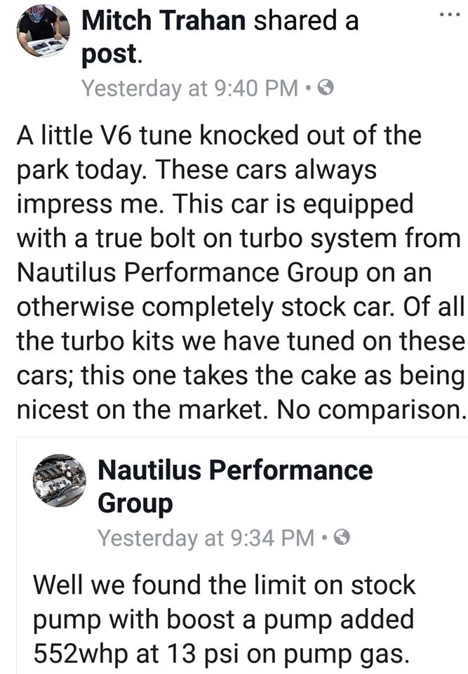

We got another option on the table for FI. The Nautilus Performance Group turbo kit is about here for the s550 through auto mafia racing..
It does have a larger price tag now though and is a tuner kit so no injectors, fuel pump, or tuner. Its a bad ass kit though.

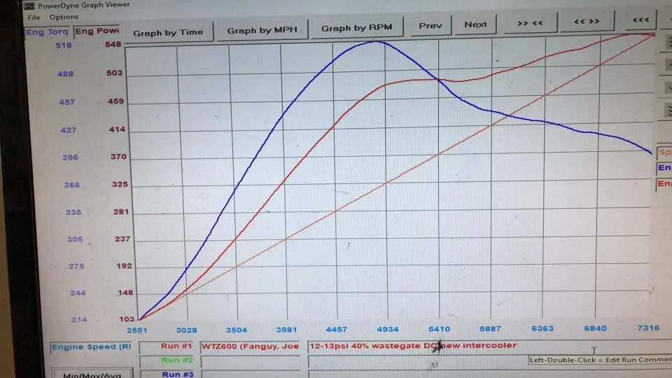

Saw it early this morning, but here is the tally so far:
Bare minimum to expect assuming full prices and self install on everything at current AMR prices is $8159
When asked about a dyno he posted, responded with "I believe so" to it being on 93 so...check this graph:
548/518 on 13lbs of boost

The numbers are impressive but I doubt that is pump gas. I dont even believe it's safe to push those numbers on pump gas. That kit means business though. Just look at the material being used.

Agree, seems high, but if it is really efficient like they've been hinting this whole time, definitely possible. Just checked and back in November they shared a post by Tuned by Norm and it did say 552whp on 13lbs with pump gas. So with E85 should be mid to high 600s easily?

It's very impressive, but yeah run those numbers on pump for long and your engine life is gone and your fuel pump is toast. Dont get me wrong this kit is awesome and I would love to see this on an s550.
