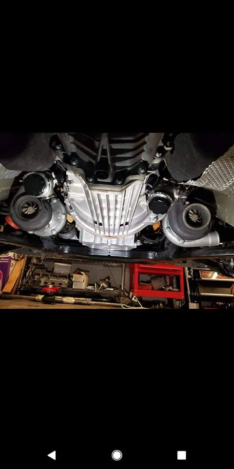

If you want to move on it quickly, AMR just posted up a JMP twin turbo kit for $4500 (needs fuel pump and injectors) including their tunes for life. Sounds like a sweet deal to me, just not something I can jump on right now. Brand new set, but original made 567whp on E85.

Wish I could move on that as well.... Bit too expensive for me as well.
