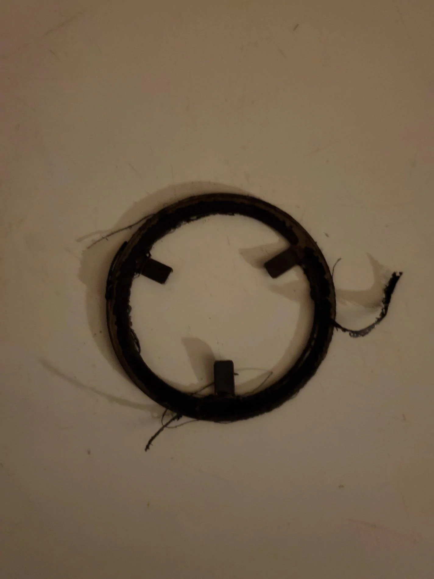

Hi, did you happen to get the part number for this tone ring? I am having the same issue I replaced the left rear hub and found the ring chewed up and need a replacement.
I for the life of me can it find it.

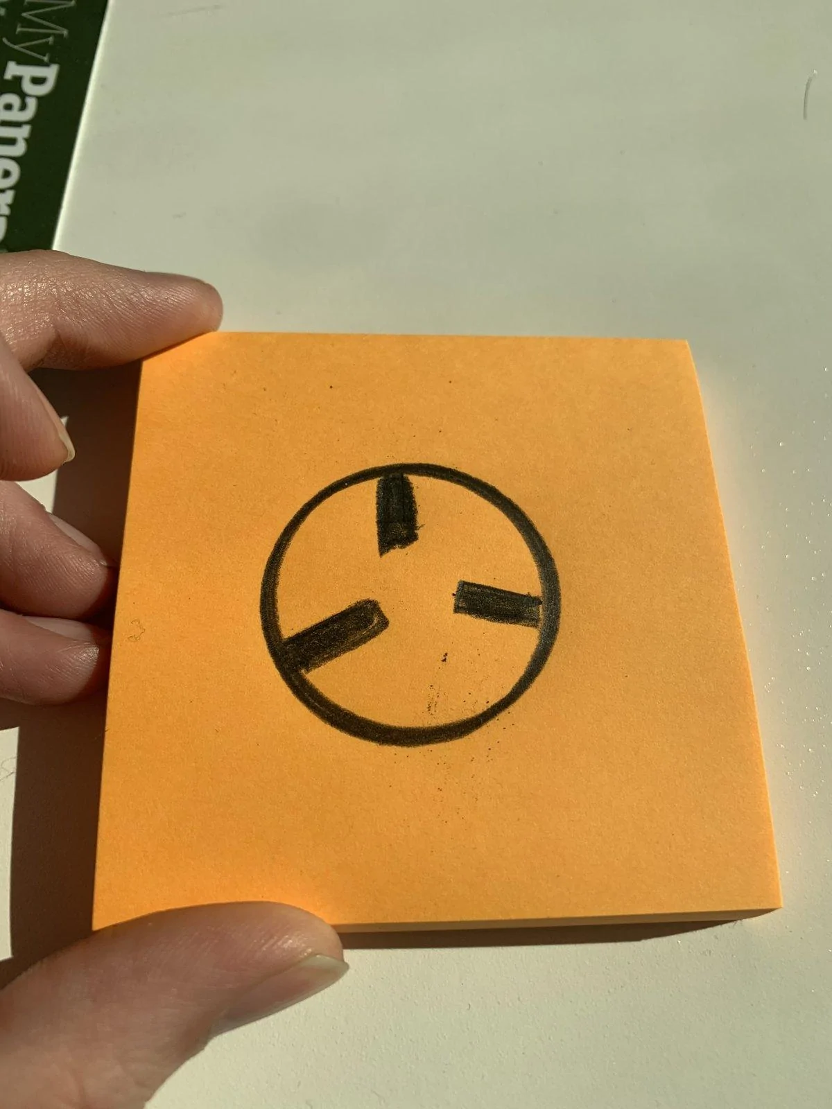

Absolutely HORRIBLE drawing BUT this little crush washer is stamped steel it’s SUPER thin and flimsy. It sits on the end of the halfshaft where the Rear Hub assembly sits these sometimes fall into pieces after you take off the rear hub.
This ring uses the 3 black fins as a “ magnetic strip” for l the ABS/Speed Sensor that goes into hub. If you go to ford dealer parts department and ask them To bring up the parts for the rear end it will take some search but you will find it. That’s what I did on my 2015. As soon as I replaced this little ring everything was fixed.

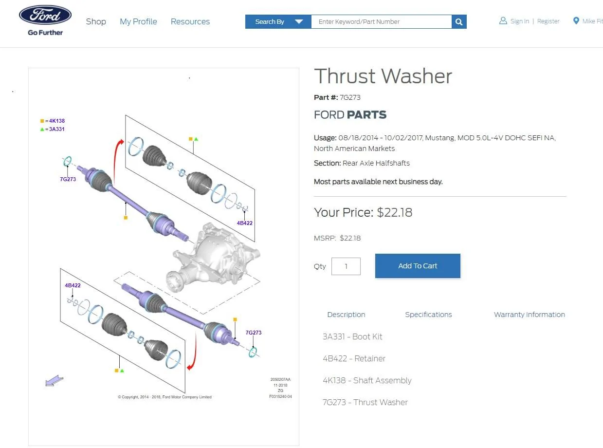

Thanks for the explanation I was able to get the part from the dealer. Here's the part number for anyone who may need it FR3Z-7G273-A

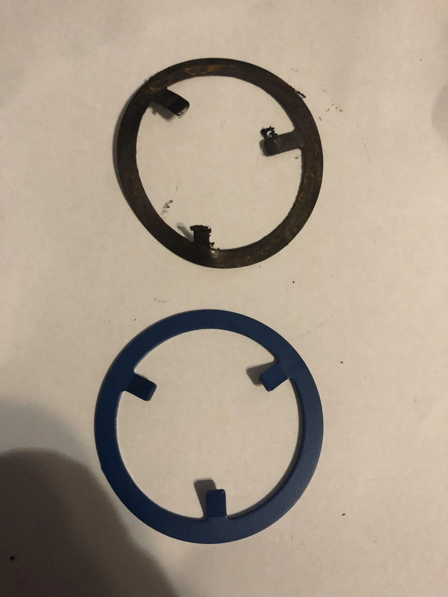

I just want to say a big thank you to the posters. I just bought a 15’ GT with this problem. Searching the net brought me here and this great info! I went to Ford, ordered the part, installed today. Problem fixed.t wanted to add a picture of the one I changed out. It was a little more bent than it is in the pic, plus when we seperated the bearing from half shaft, it fell and rollled under the car. So you got to keep an eye out for it or atleast we did. Installed the new one and problem was fixed

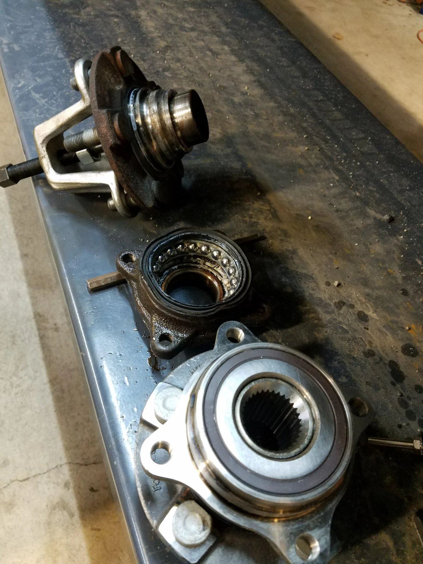

I had the same issue but after reading some post here, I started by changing the Rear ABS Speed Sensor. That didn't work, so I replaced both rear wheel hubs. When I took the left hub off, I found the ring between the hud and axle was destroyed but the right was fine. I didn't replace the left or reinstall the right but all the light went off and everything is functioning as they should.

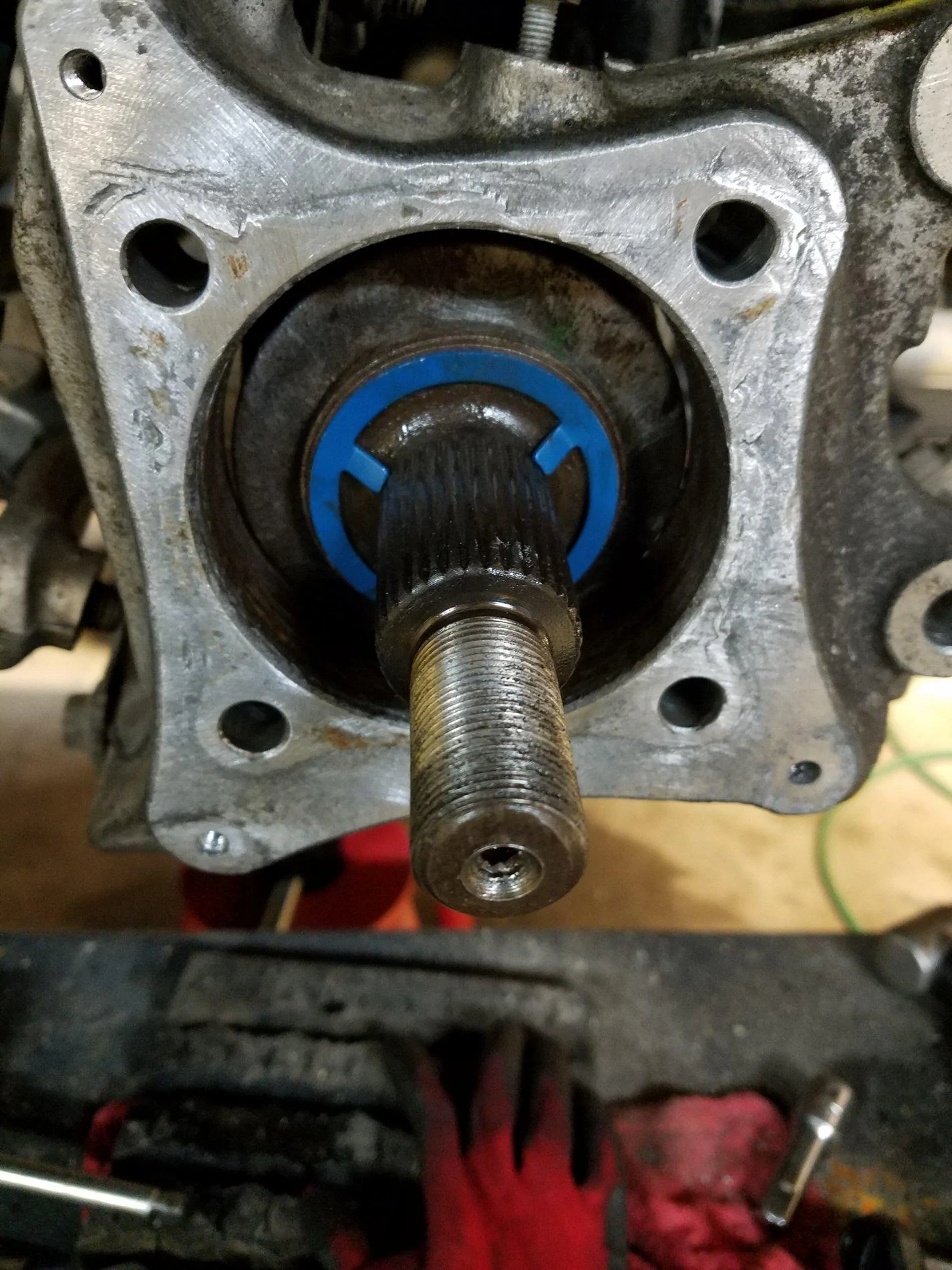

That ring has nothing to do with the speed sensor. The speed sensor has it's own reluctor ring on the hub built into the bearing. sensor rings have lots of teeth, not just 3. Is it coincidence something else is going while those parts are worked on? Maybe. I've looked into this as recently did dss axles and the traction control isn't as responsive, but come to find out the computer just doesn't know how to pull enough power when flogging 750+ on the stock tires. Throw the mickey's on and traction control works wonderfully. BTW those little rings on the stock axles stayed on the stockers, and nothing went on the dss's. No lights or anything with them completely removed.

That rings sole purpose in life is to keep the knuckle from seizing onto the abs hub..thats it. Otherwise you destroy the hub removing it with anything other than the proper tools
