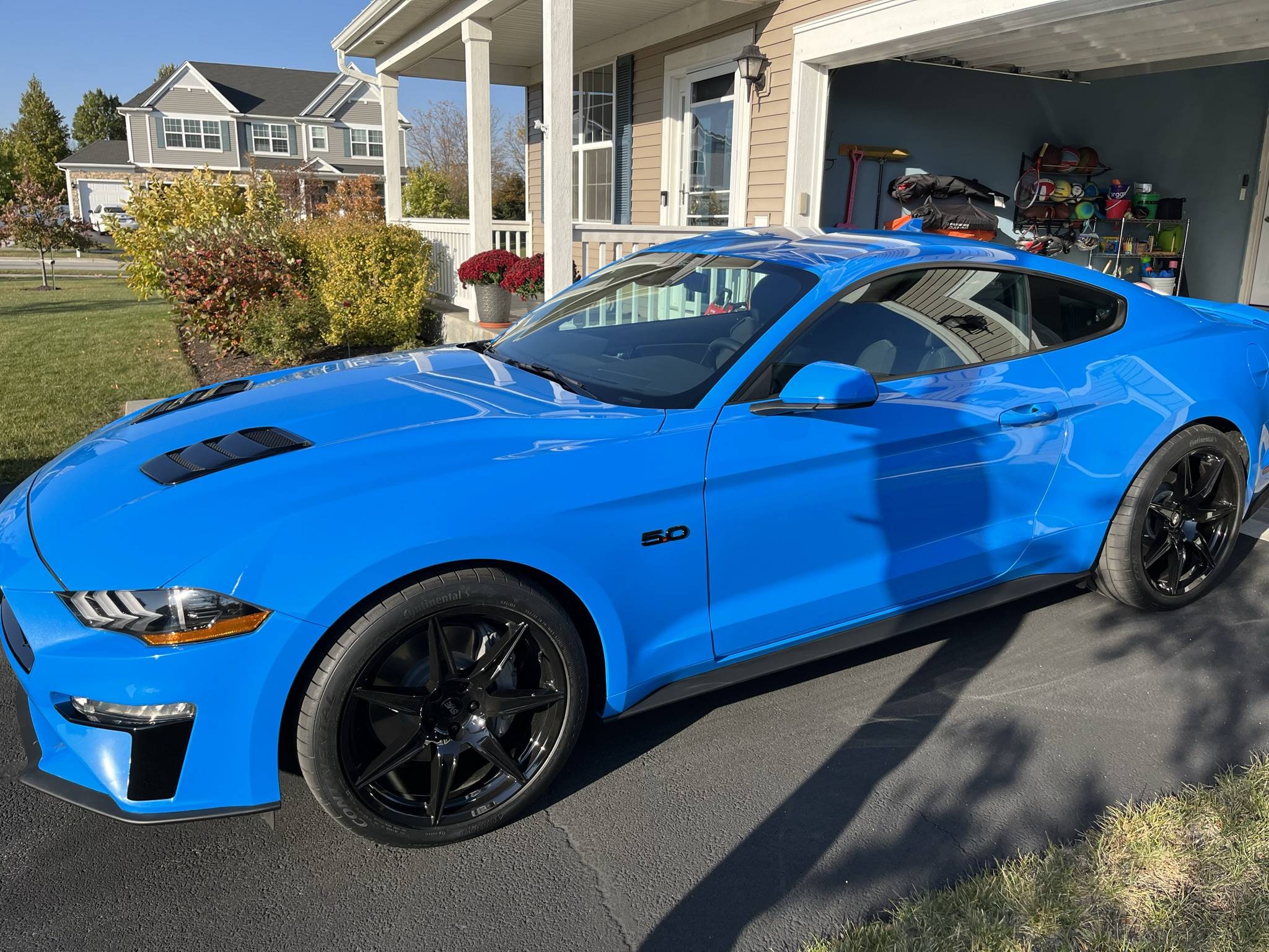

2022 Mustang GT
285/35R20 all the way around. No issues at all

Stock suspension?
Yes I’m on stock suspension. I asked the same question a few months ago and some of the guys that are lowered also run 285’s up front so you should be good to go with the Steeda springs

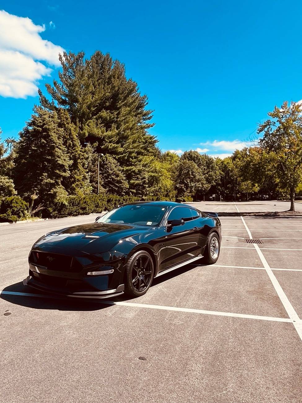

Martinrue97
Jun 11, 2024
New Jersey
23 Mustang Gt
I know this is a little bit of an older forum however I am wondering the same thing. In the process of possibly buying some steeda progressives. Current setup on stock suspension is 285/35s in the front and 305/45/17s in the rear. will they work?
shogun32
Feb 8, 2019
92
16,223
14,019
Northern VA
front should be just fine. Rear could be close. it'll drop the edge of the fender a good inch. So you may need to pull those drag slicks in a bit or add camber so you're not rubbing the fender edge or the inside face. Remember, static observation is worth little. The suspension compresses a fair bit while driving...
