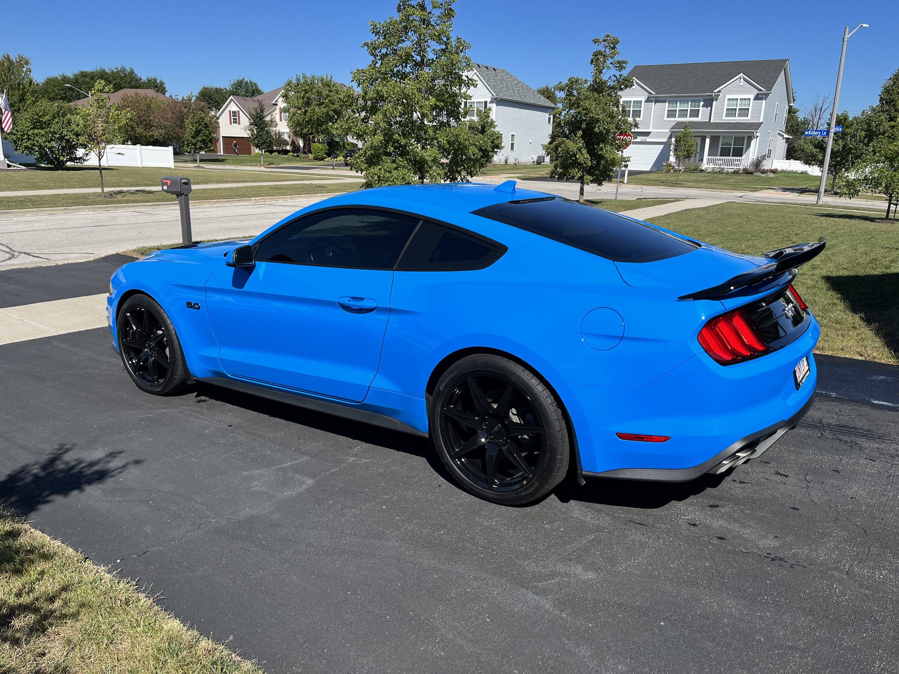

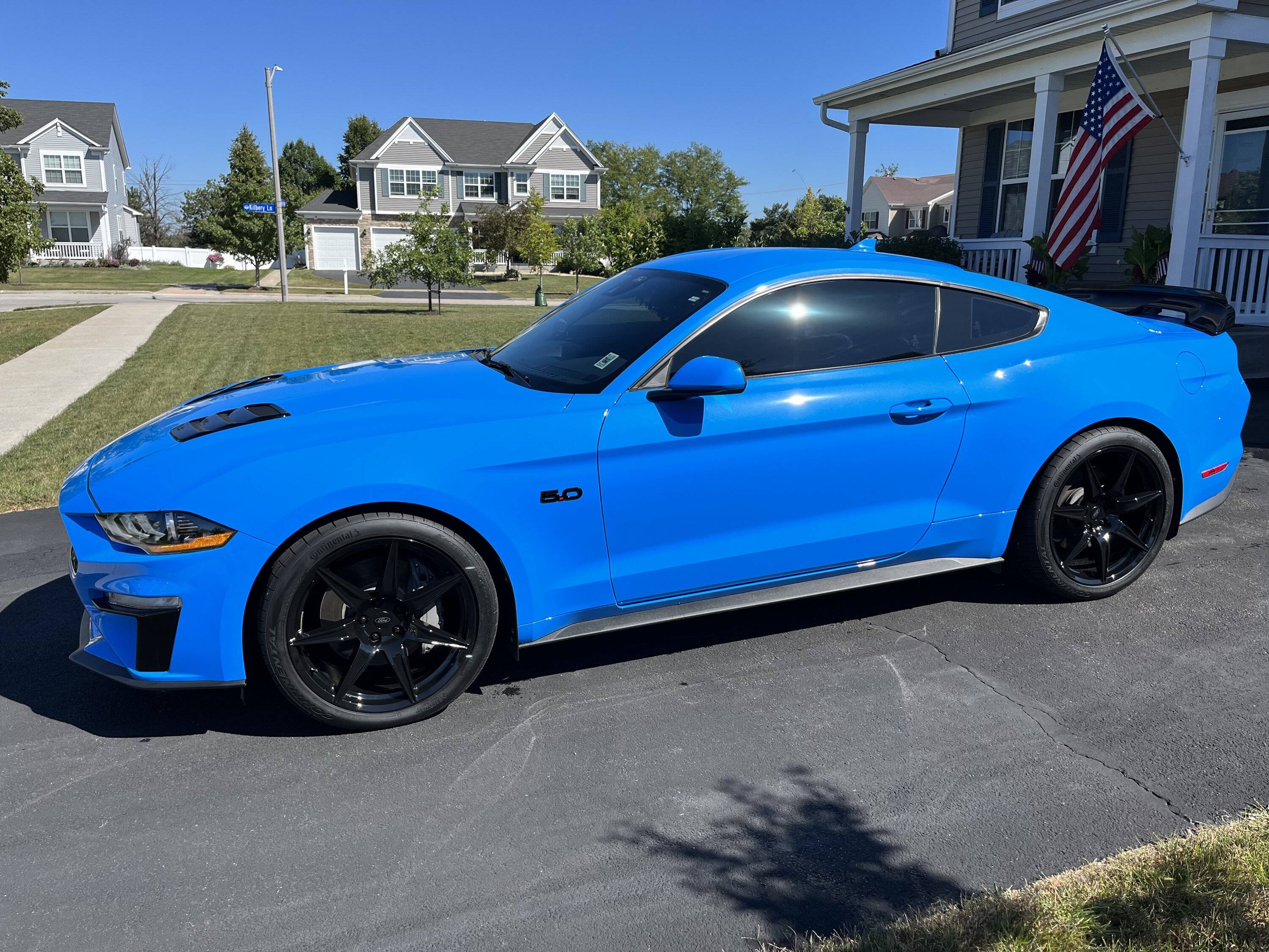

Sidewall is the same height. I run 285/35r20 in the summer and the ride quality isn’t harsh at all. Is it as soft as the 235/50r18 I run in winter? No, but it’s not bad at all. A 30 profile would probably be a bit harsh. Those that run 19’s for a softer ride are probably running 275/40r19

I’m on 20x10 et35 with 285/35r20 in the summer. Stock suspension. It is noticeable going from the stock 235/50r18 I run in winter. Fills in nicely IMO. Visually, 275/40r19 won’t look much different.

We don’t have the greatest roads here in the Chicago area either and my 285/35’s are fine. Don’t want to take on any potholes for sure but small bumps and stuff are fine. It is a noticeable difference compared to my winter set which are 235/50 but I wouldn’t say the ride is overly harsh. You do feel more of the bumps though. If that’s not appealing, I’d go 275/40 in a 19x9.5 or 19x10 wheel.
