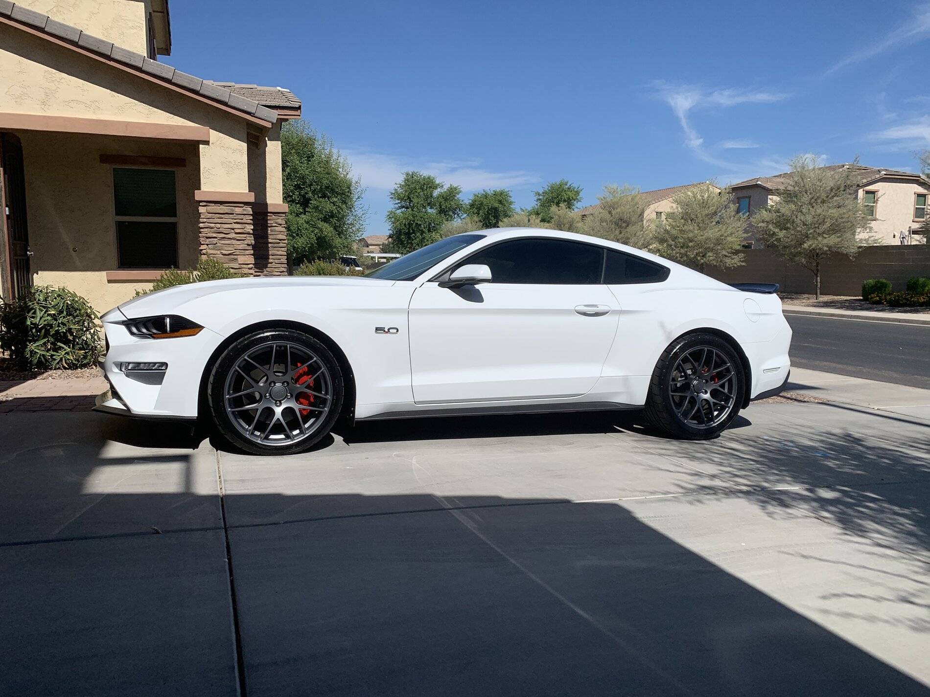

I run 28.4” in rear and they fit just fine. 305/35r20. Speedo is off a little but looks and rides great.
Cant speak to the front though
The bigger question is what tires are 235 wide and 28.6” tall? By my math, that isn’t a standard tire.
