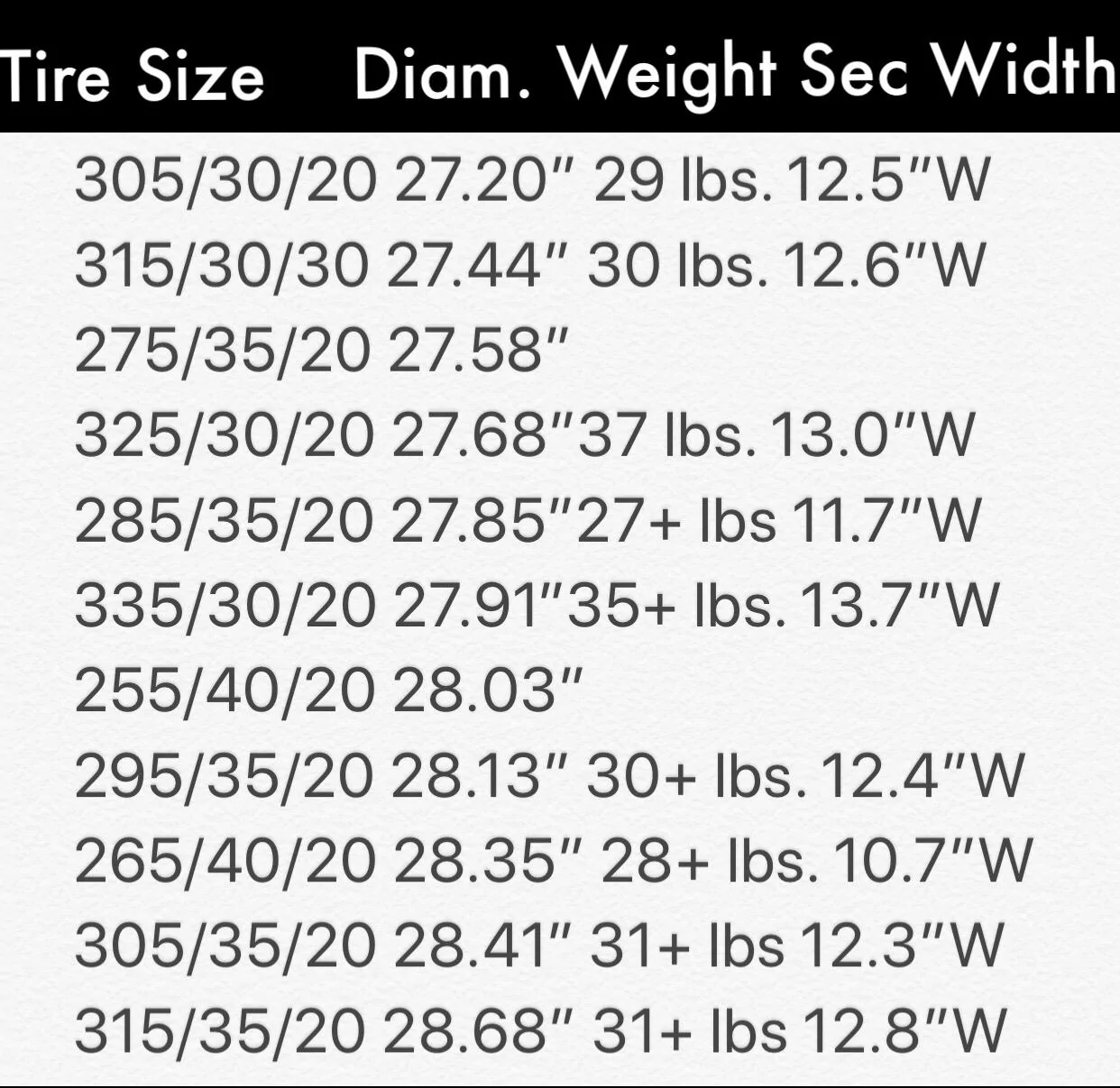

275/40/20 are just a hair too tall for the front but are okay in back. 265/40/20 are the tallest for the front at 28.36” but the tallest for the rear are 315/35/20 at 28.68” in diameter.

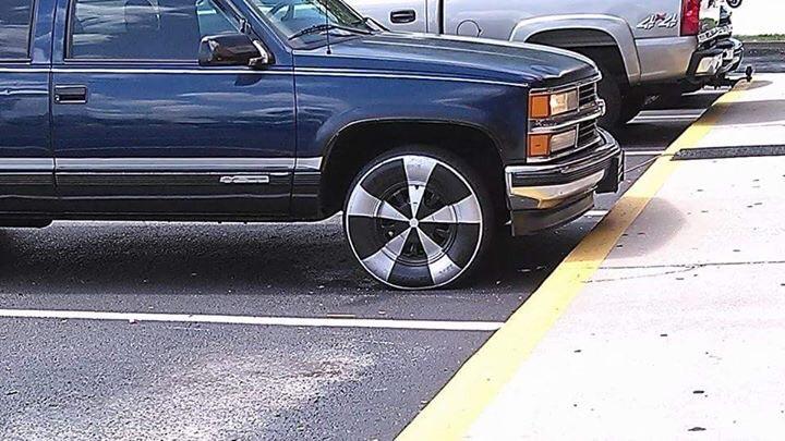

Different strokes I suppose. I grew up around drag cars and muscle cars that all had plenty of meat on the tires on 15" rims. Maybe I'll paint my taller sidewalls so I don't lose cred with the group. Blang blang!
