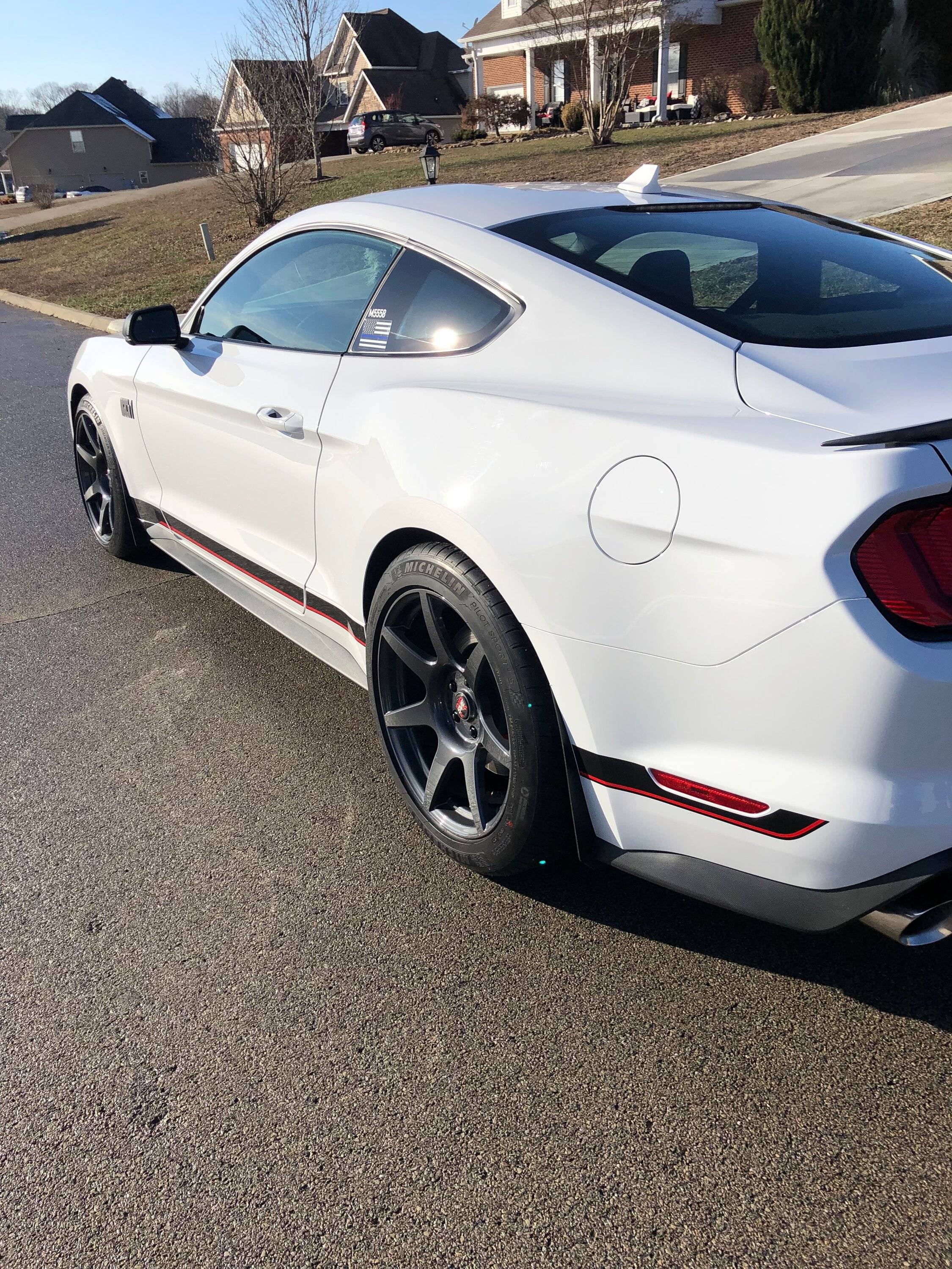

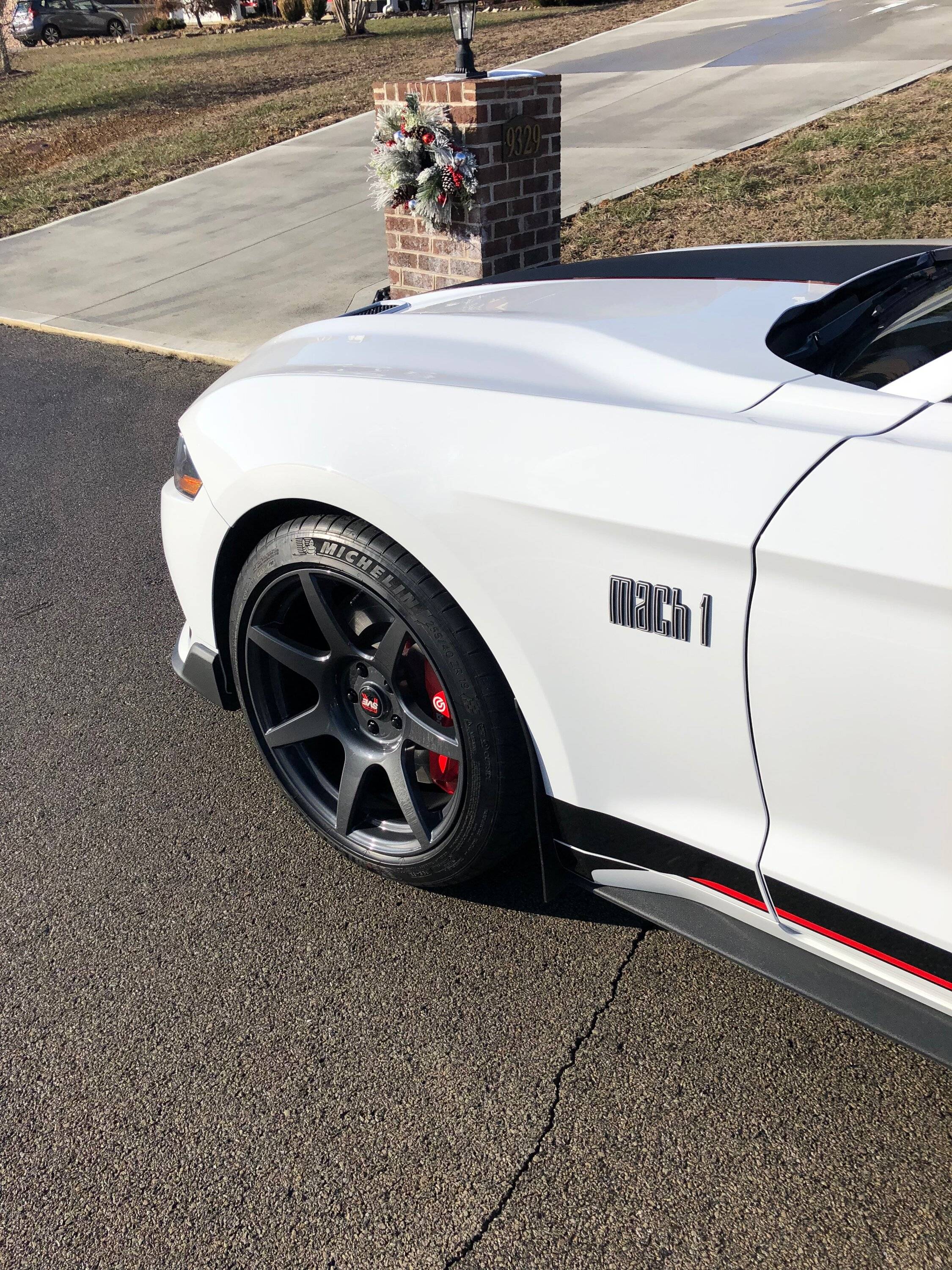

255x40 275x40 stock, 10 in. SVE wheels.

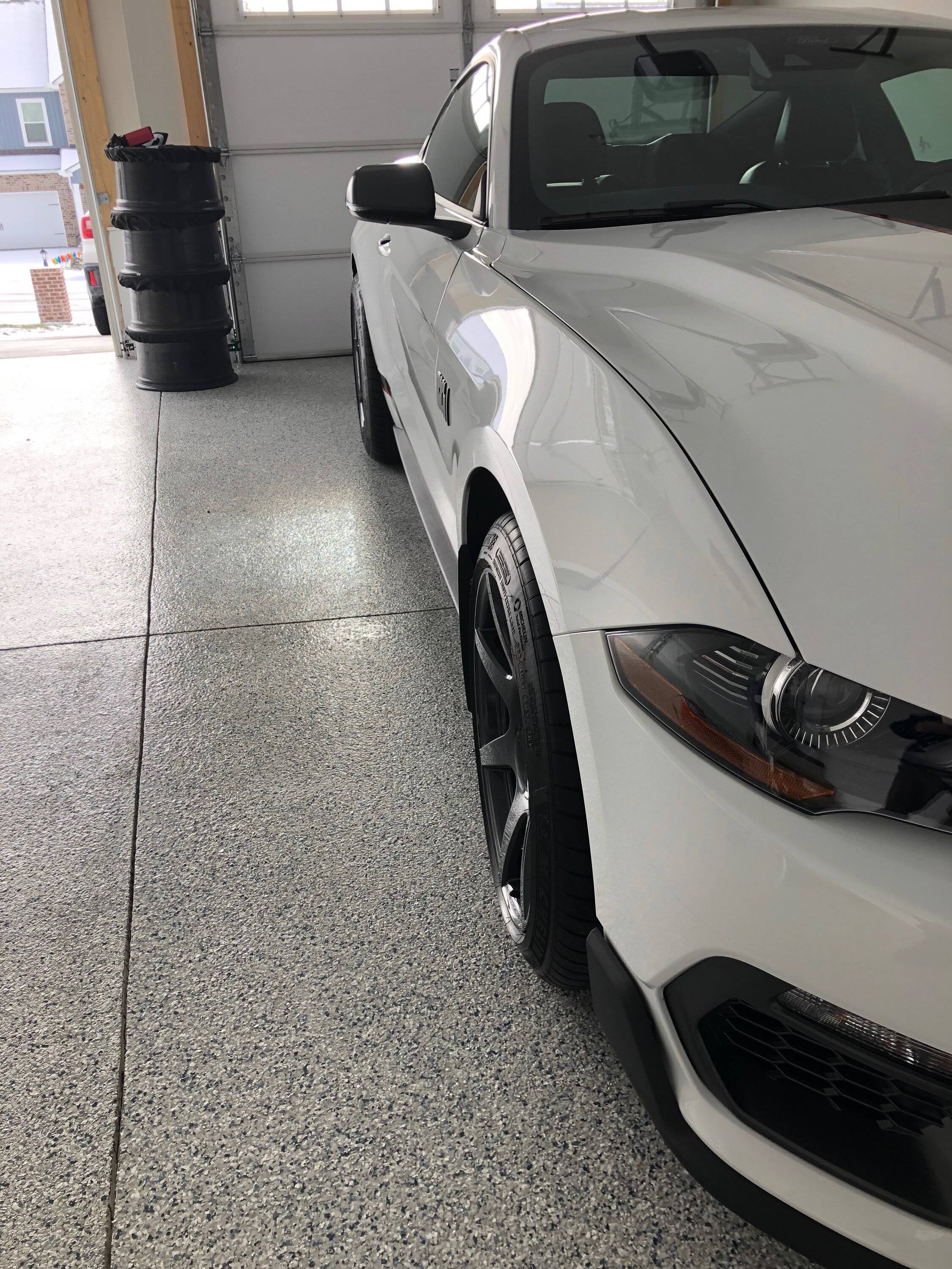

Also, great move with the SP2 19x10 square setup - I'm running it as a plug and play dual duty daily and track setup and love it.
