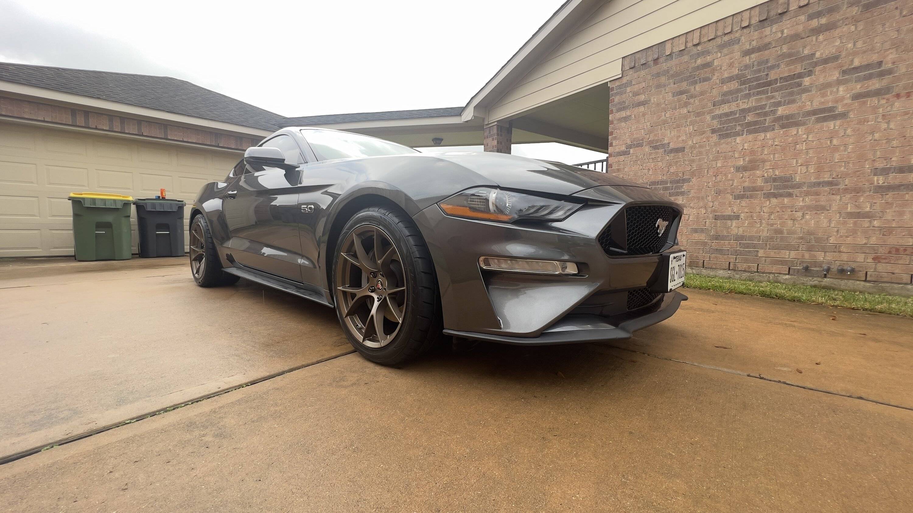

i have 275/40R19 on my front 19x10 and 305/35 rear. Kept overall diameter at stock size. Basically the performance pack tire up front and a 305 rear

honestly if your car is lowered its hard to see the width of the fromt tires from most angle. I think offsets are more important from a look standpoint.Stock wheels pushed out to be flush looks just as good. In your case square setup to be able to rotate is the way id go

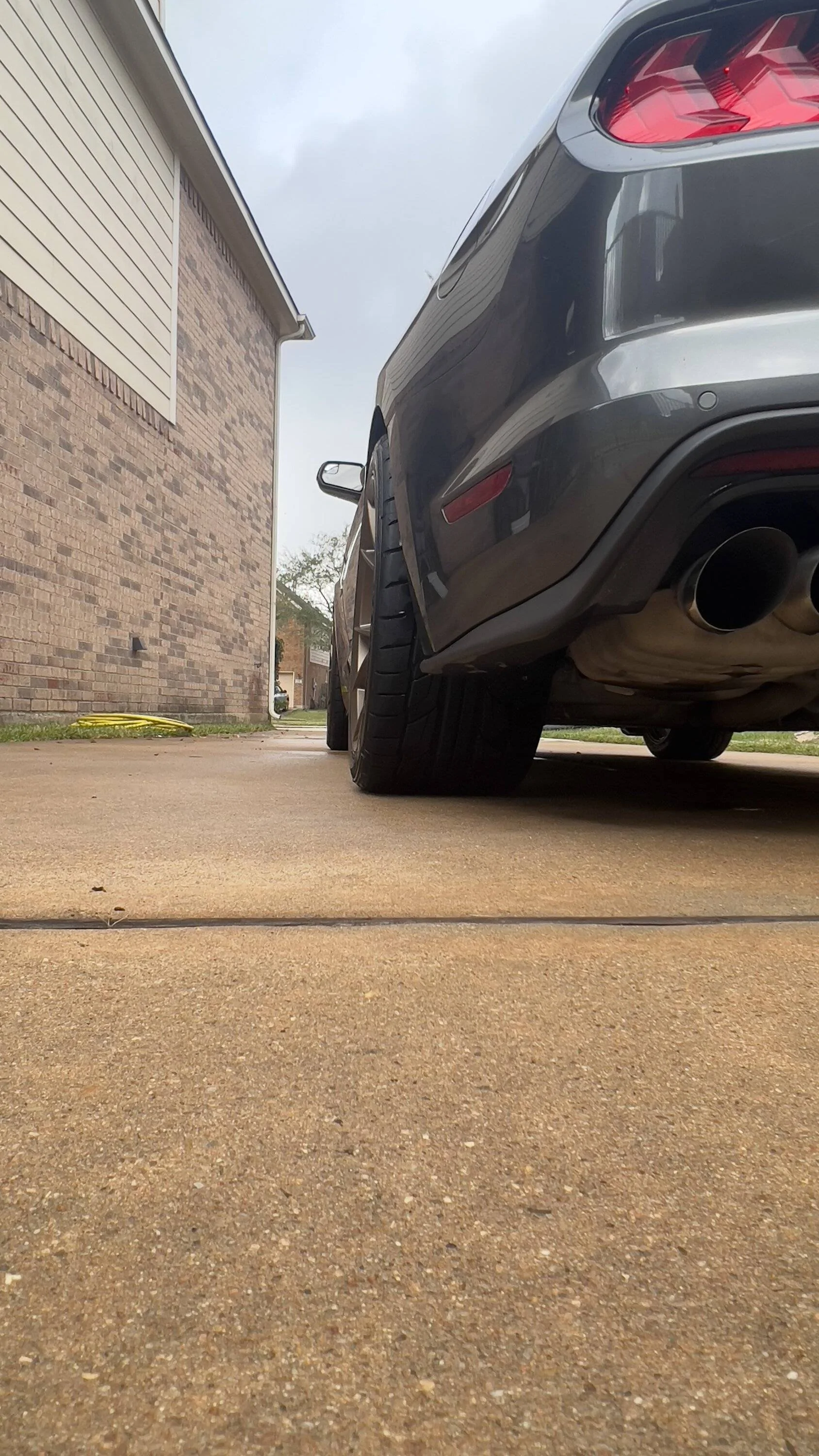

I have 275/40/19 Square and I have no fitment issues with -1.0 lowered on springs

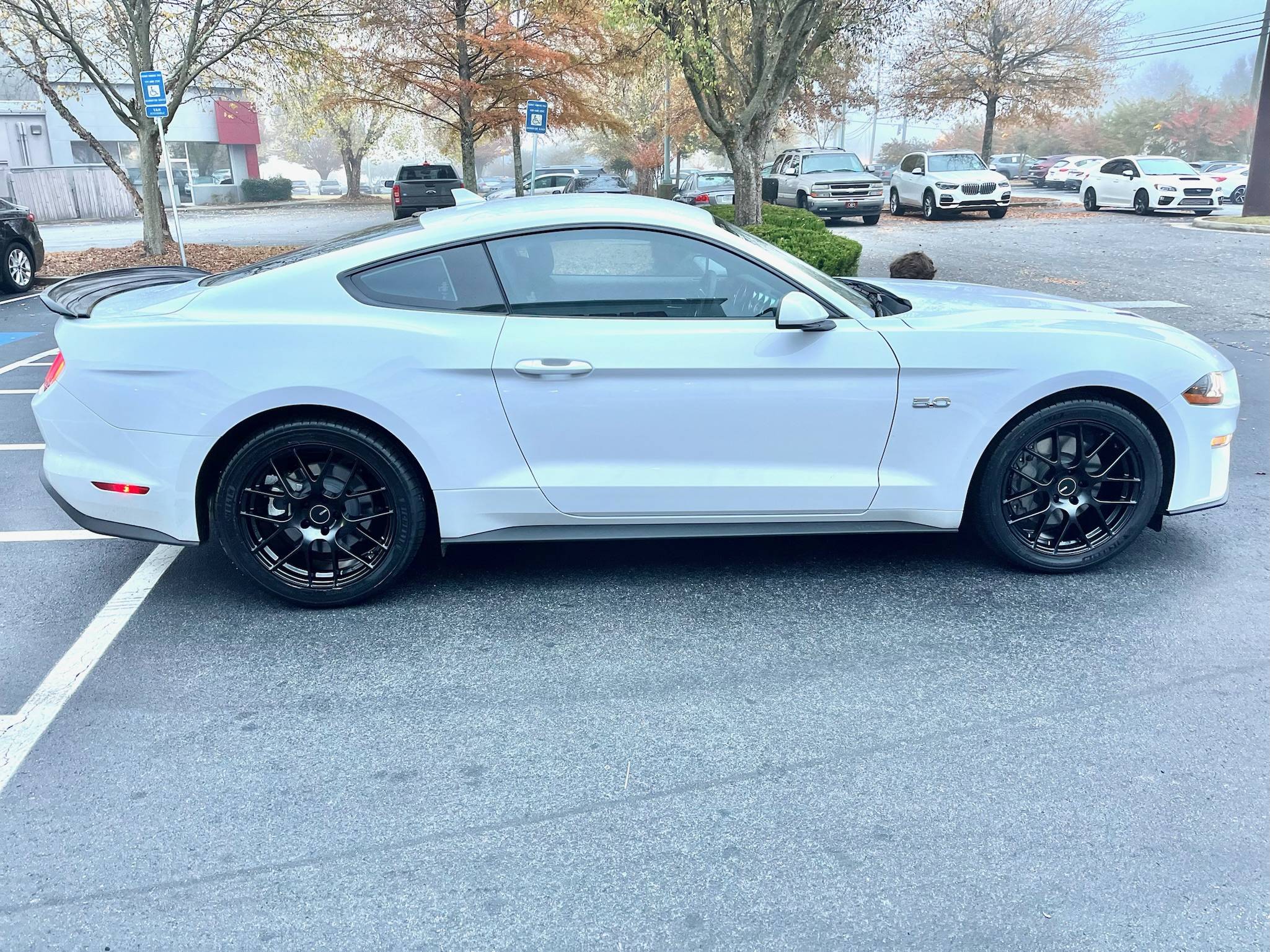

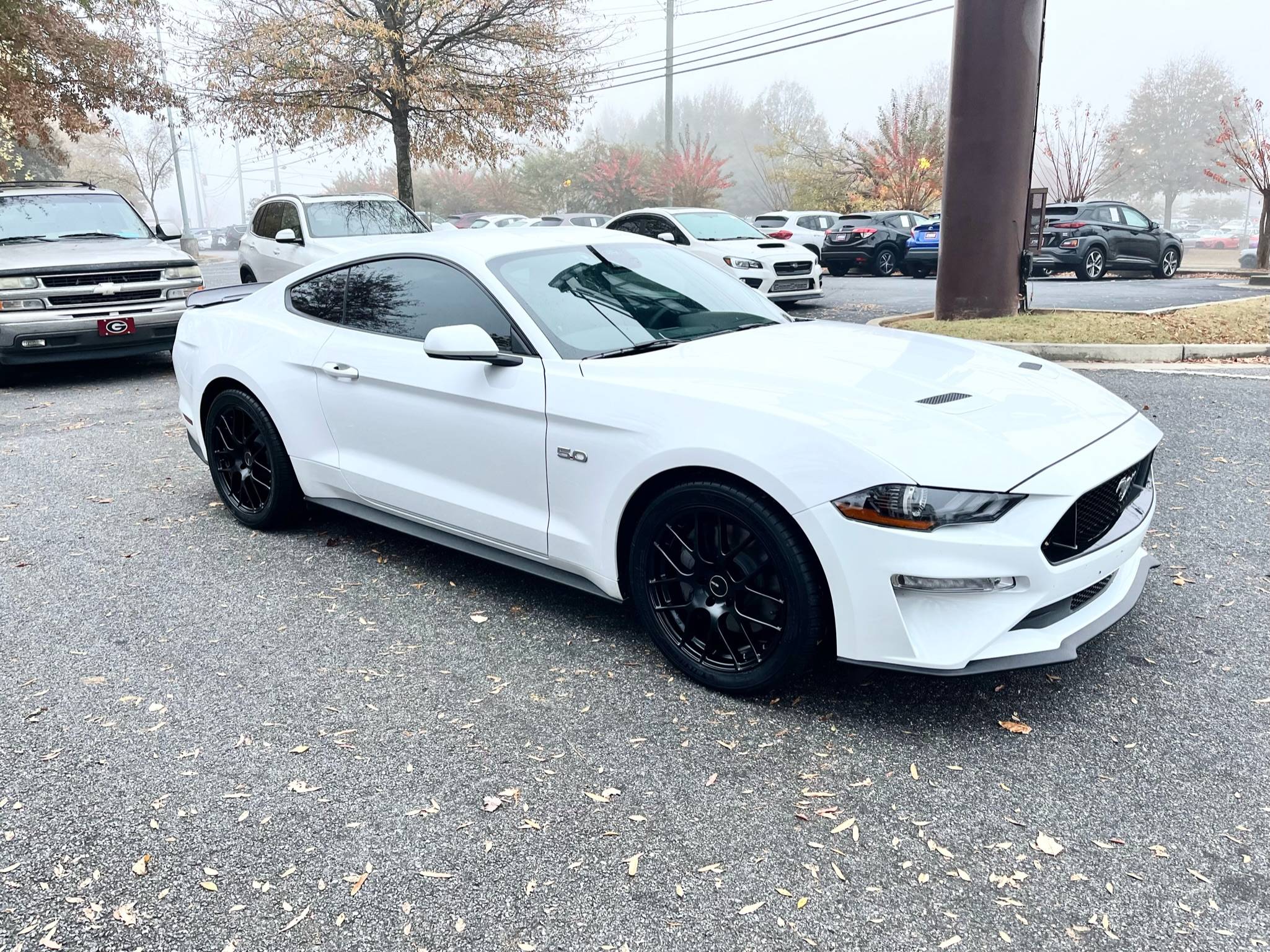

The SVE SP2’s are +35 offset which will give you a nice flush fitment. Honestly, I’d run 285 square (it’s what I run). The other sizes you mentioned will stretch a bit and as mentioned above it’s really hard to tell if you’re running a staggered setup from a visual standpoint unless you some big meats in the rear.
Did you have to worry about speedo calibration? 275/40/19 is taller than 255/40/19 on my stock. I know PP1 does come with 275/40/19. Any pics of your car?
Yup your 285 pics helped me come to terms with 285 because they look pretty meaty! Part of me wants 275 in front and 285 in rear but I feel like that's not enough of a visual difference and I'd lose ability to rotate.
Nope, I didn't have to do anything I had no issues after lowering. There pics are before it was lowerd. It's been lowerd for a month now.
I’m really happy with them. Yeah the difference in width between 275 and 285 is not noticeable and as you mentioned you lose the ability to rotate all 4 corners
