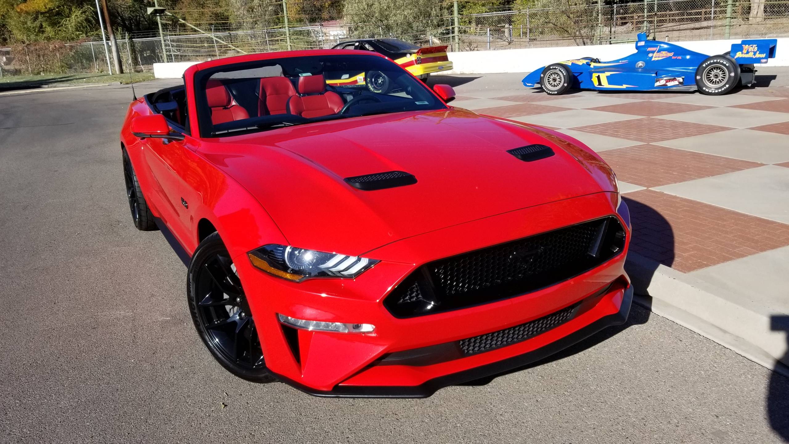

Albuquerque, NM. I'm looking for nothing more than a 4pt bolt-in roll cage or bar. All convertibles at the Albuquerque Dragway that run under 13.5 must have a cage or bar. Yours would qualify. My car may be a high 10-second car even at this high altitude. I have the Steeda Subframe and Alignment Kit with the Steeda Vertical Links and the GT-350 Half Shafts. I also have a set of Nitto NTR05 Drag Radials in a 305 width, so I think that she will stick without any hop. I'm just hoping that I can recline my seat, because she is a daily driver and I like to lean back...

The red on red is GORGEOUS. Great pic - thanks for that!

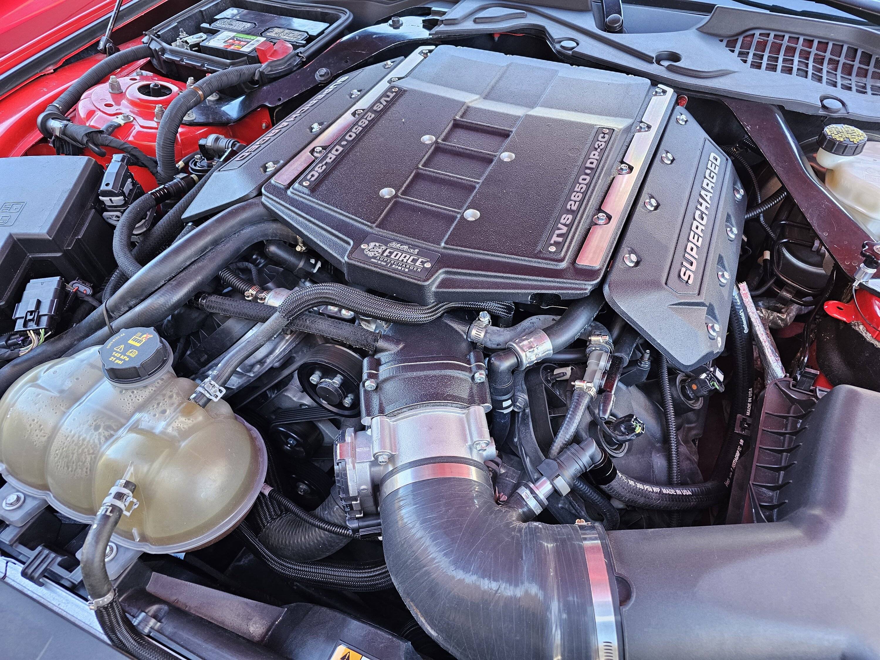

How've you found the chassis holding up against the supercharger? In this video Throttlehouse did they found that Shelby Super Snake convertible widebody's chassis warps under full power - . That's the only concern holding me back from considering adding a supercharger down the line.

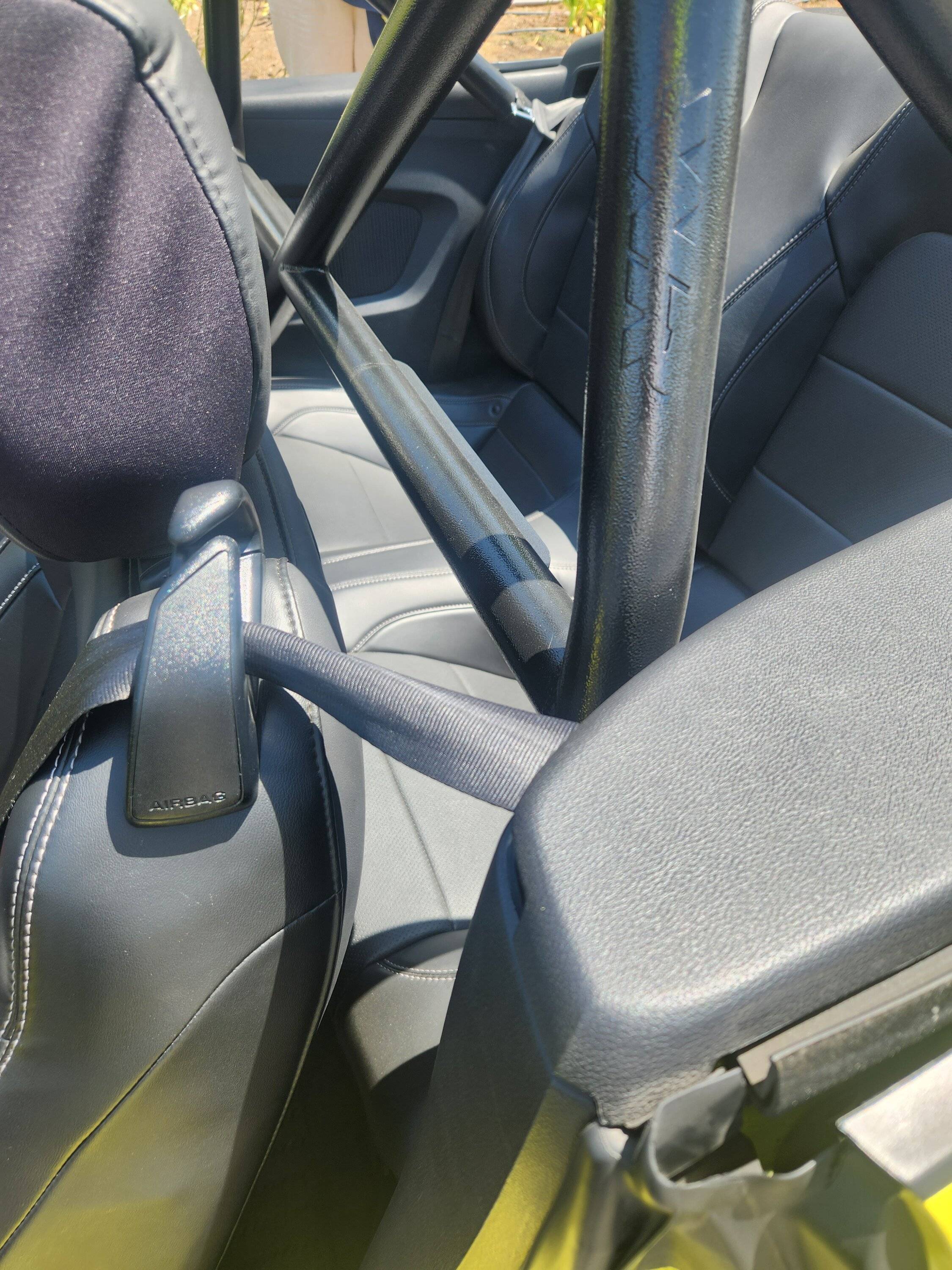

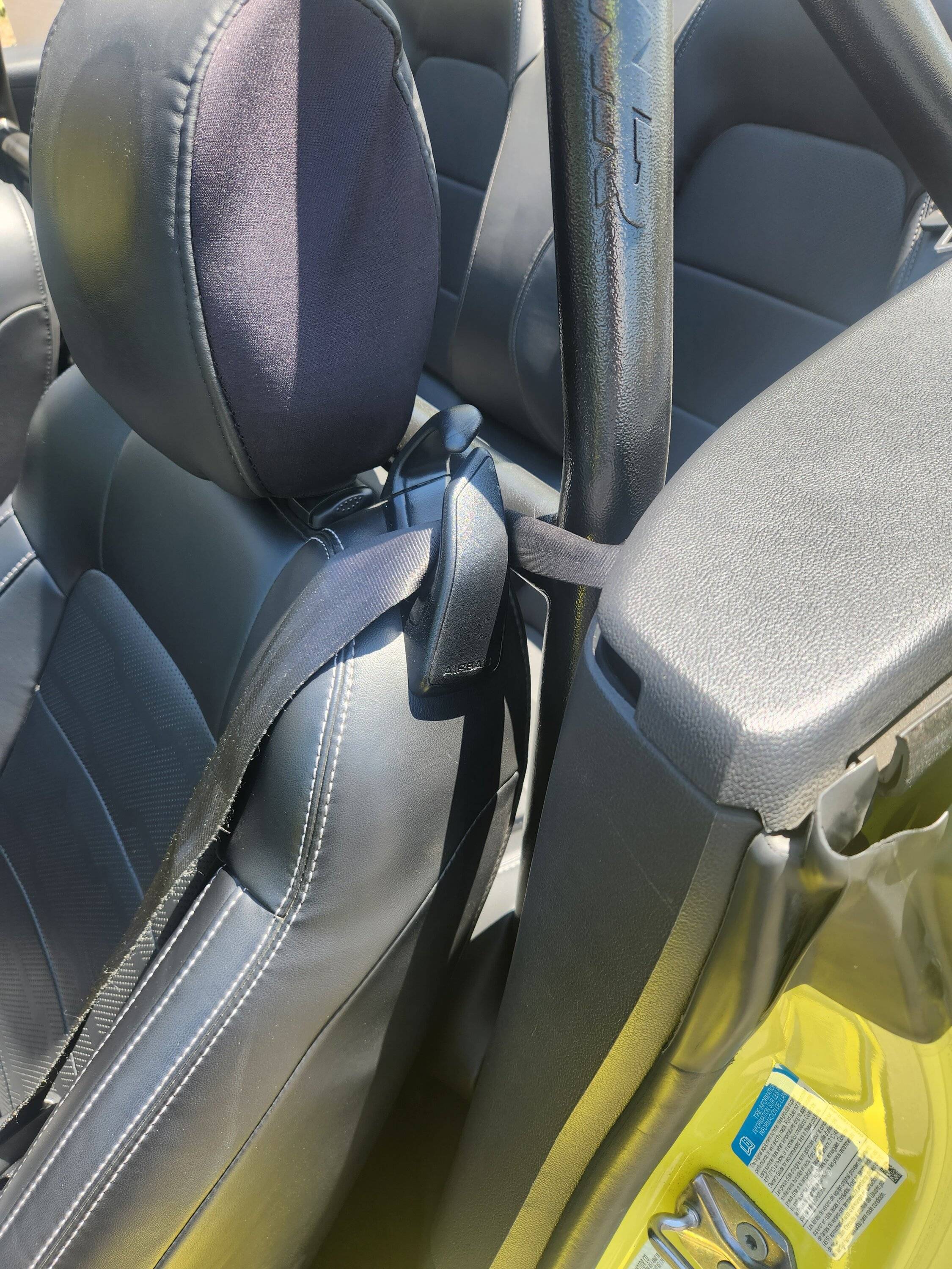

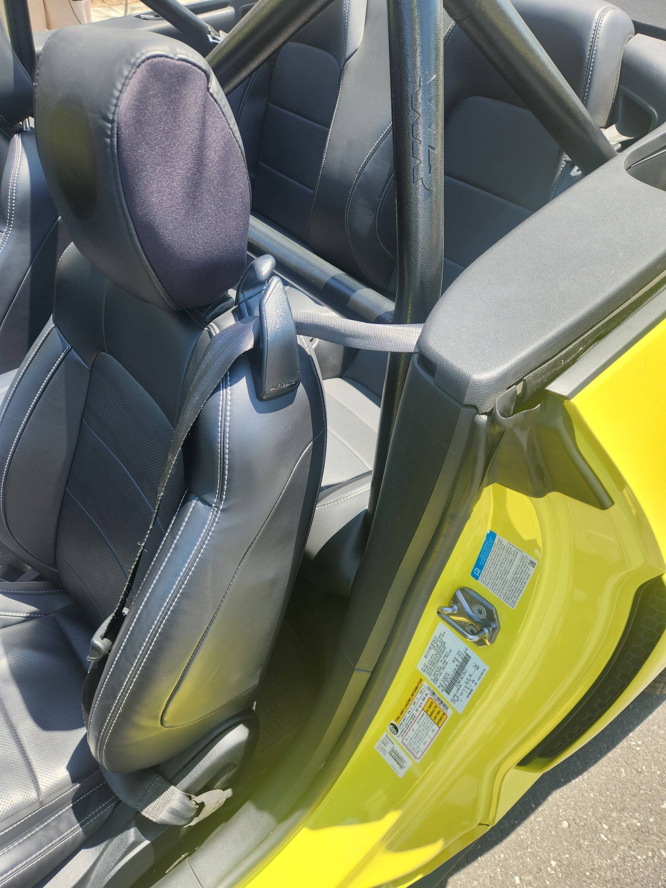

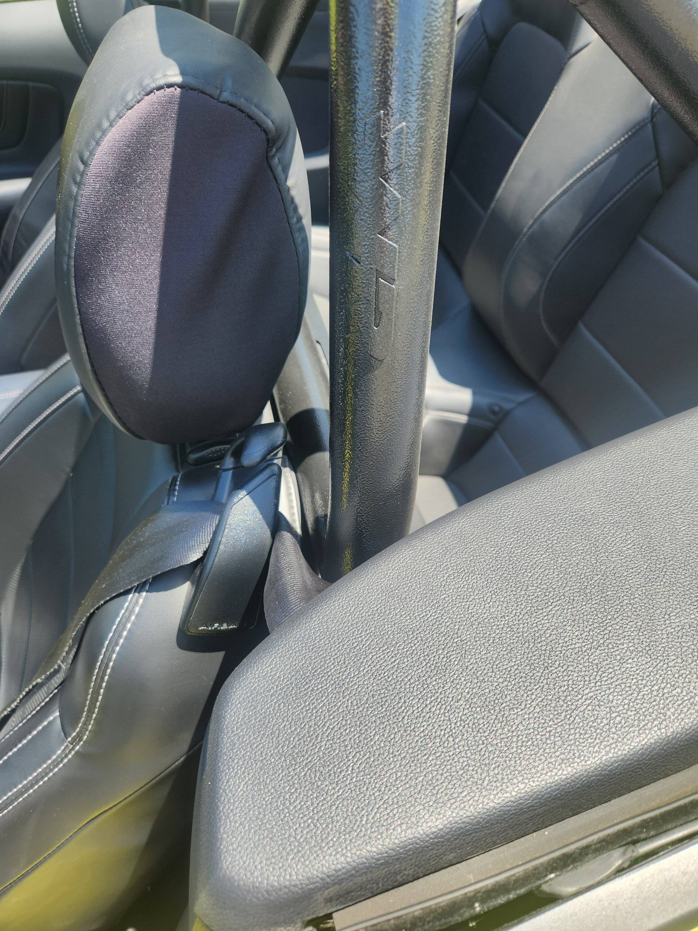

To answer your question - if you recline the seat fully back it will rest against the roll bar -
The way I sit is a few degrees straighter so it doesn't touch the roll bar but I'm still 'lounging' instead of sitting upright -

It seems to be holding up fine. There's extra bracing underneath for the verts. That's why the jacking rails are shorter than those for a coupe. The S550 convertibles were the first Mustang ragtops that were purpose built from the ground up to be convertibles. All previous verts were converted coupes. Much stronger design. I have had S197 convertibles and they all had a little body wobble on uneven roads. Not the S550's. It should be even stronger when I install a 4-point cage or roll bar.

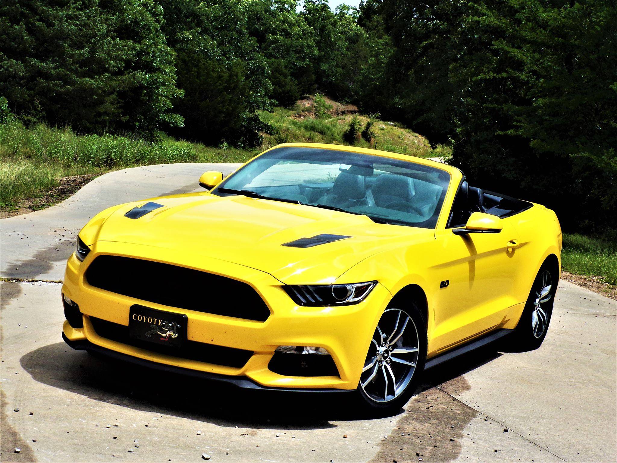

The yellow and black looks great. My previous Mustang was a 2015 yellow and black convertible. I was going to keep it, until the 2018 came out with the Gen3 Coyote engine. That poweplant was too much of a game changer to resist...

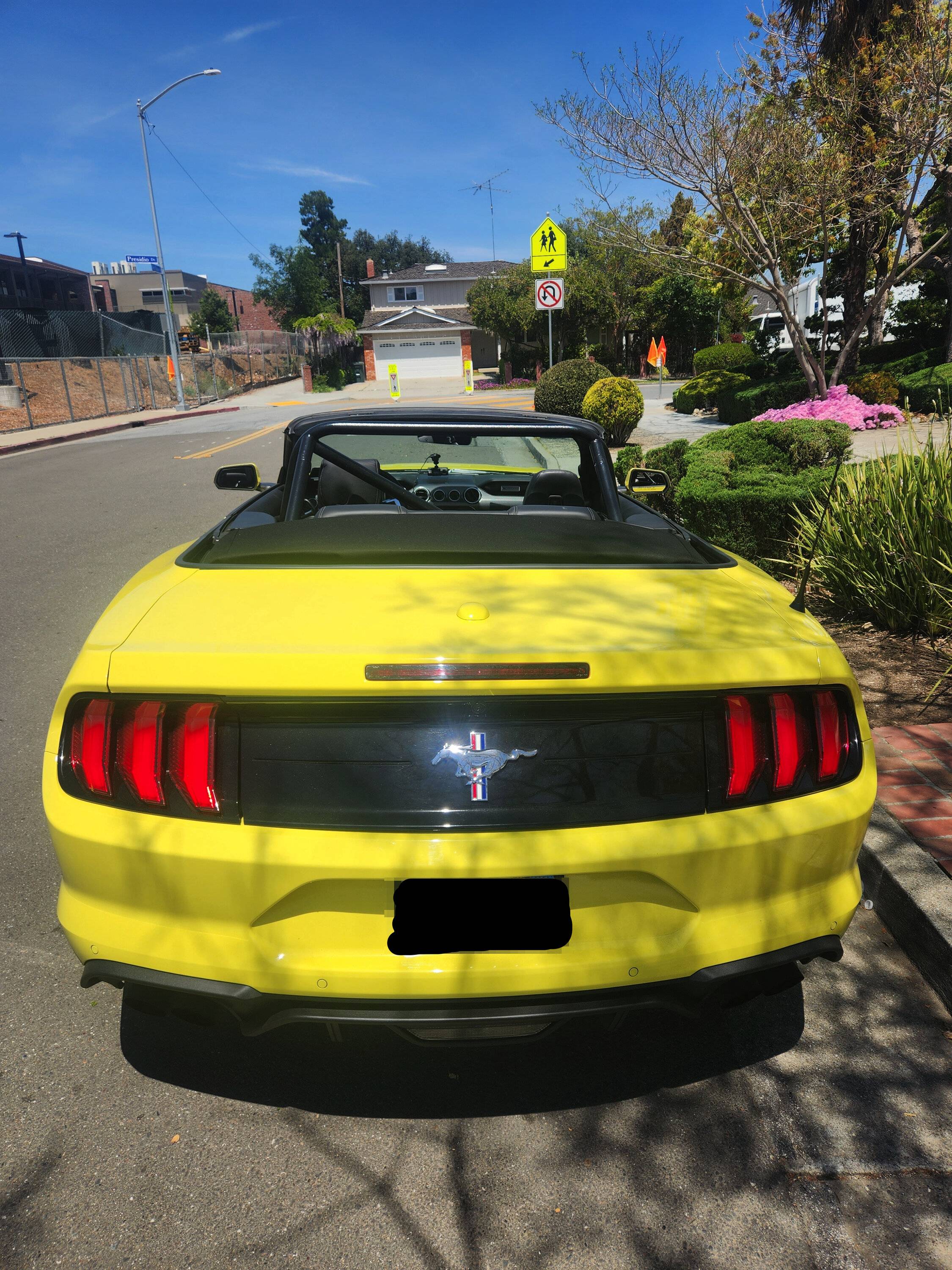

Ooooh could we get a picture of your rear seat delete please?? I mulled over the idea when I was getting the roll bar installed but the visuals weren't too pleasing without the seat.

About that rear seat delete, the story:
first nobody makes rear seat deletes for convertibles, don't know why, but I found a group that said they could do it (or said "he" could do it) $250 and months later I got it. Tried to see how to fit it and couldn't figure it out, even my buddy mechanic from this forum no go. I now have my local hot rod shops reference for their guy who they say can make it fit. So if/when it's done I'll send pics but not sure how it can be replicated.
