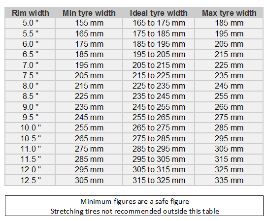

This should help. For a 305 width tire, you'd want at least an 11.5" wheel, but 12" would be better. Looks are subjective, and even performance (breaking loose, as you say) is somewhat subjective. We can't really answer that unless we know what else you've done. For instance, I have Steeda rear subframe connectors, IRS bushing supports, IRS locator pins, diff bushings, and vertical links. This is the vast majority of the Steeda Stop the Hop Ultimate kit, and she's getting adjustable rear toe links before my new tires go on. Even with all that, and what are typically thought of as among the absolute best tires you can put on this car without going to a Sport Cup 2 or a dedicated track tire, I can spin the rear wheels because 450+ horsepower.
I think the best thing for you to do is to go through some of the fitment threads on here and find a setup you think looks good. Bear in mind that the wider you go, the more tramlining you're going to get. A staggered setup will help with that, but not eliminate it.
You may find that a 305 square setup is what you want for max grip. A 285/305 staggered setup might be better. Beyond that, it's calculating offsets and spacers, and I'm sure one of the reps on the forum from Velgen or a tire shop would be happy to help you figure out the best fitment.
