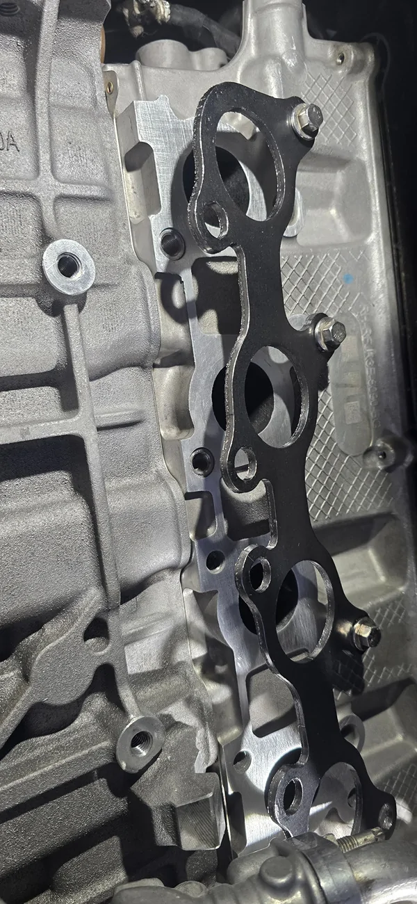

For gaskets I would highly recommend the thick crushable remflex gaskets. I was unable to get mine to seal up with oem or the kooks gaskets.

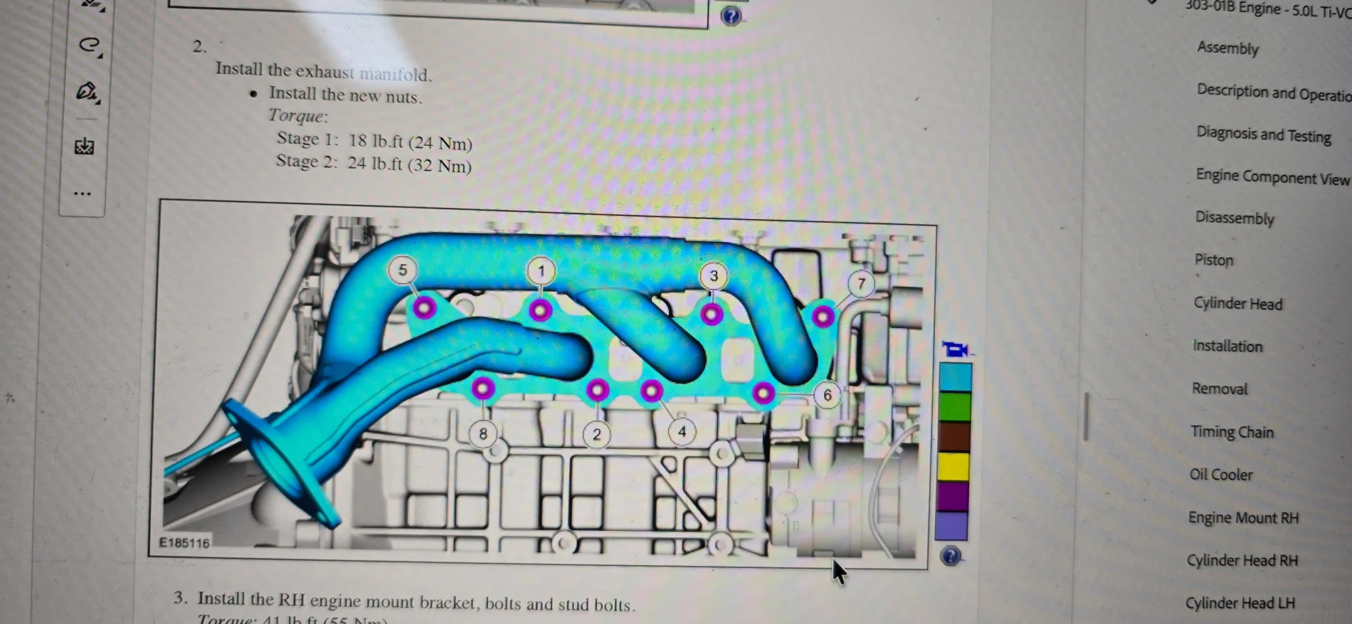

Be sure to follow the proper torque sequence as it made a huge difference when I was fighting to get mine to seal with the "normal" gaskets. I used a shop vac on blow mode to pressurize then spray with soapy water to make sure they were sealed. For me seal was extremely important (and the reason I had to re do this a couple years after the initial install) I was getting a 10-20% fueling difference between banks 1 and 2 due to leaks.
I removed the studs completely and used the kooks bolts. Ratcheting flex head wrenches, torque adapters are basically a requirement. A ratcheting torx is pretty nice for the studs.Lots of lights also.

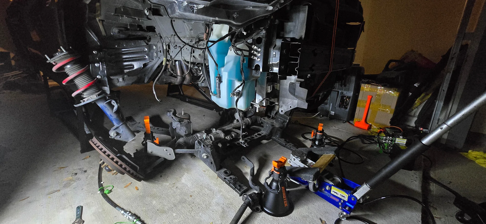

Plan for a rough weekend, I've done this twice both times using quick jacks. The second time I just hung the motor with one of those harbor freight support braces and dropped the whole front subframe. Made it so much easier and less frustrating.
Take your time and be very patient if you don't drop the subframe. Remember these are aluminum heads and it's pretty easy to cross thread going into the heads because it's difficult to get bolts or studs lined up due to space constraints. I made this mistake and ended up having to drill the threads and use steel inserts on a couple of spots.
