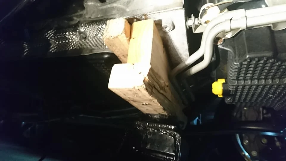

Make yourself a little jig and jack at the trans.

The 10R80 has more room between the motor and trans looking at that picture - that looks like a great way to do it on the auto cars. Ill confirm but I dont think i have more than a fingers width between motor and trans.

The small piece of wood rests up against the trans pan to keep the vertical 2x4 from flipping sideways. There's only a couple inches there or so but may be different with the manual trans like you mentioned.

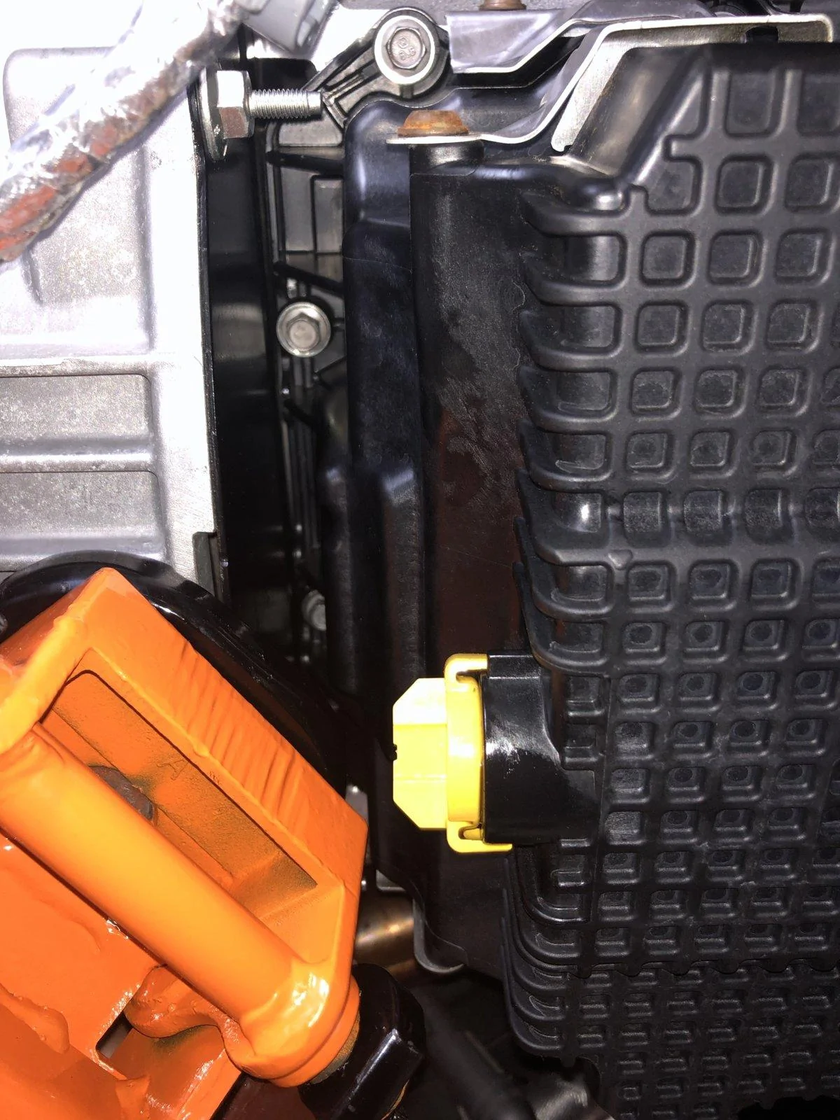

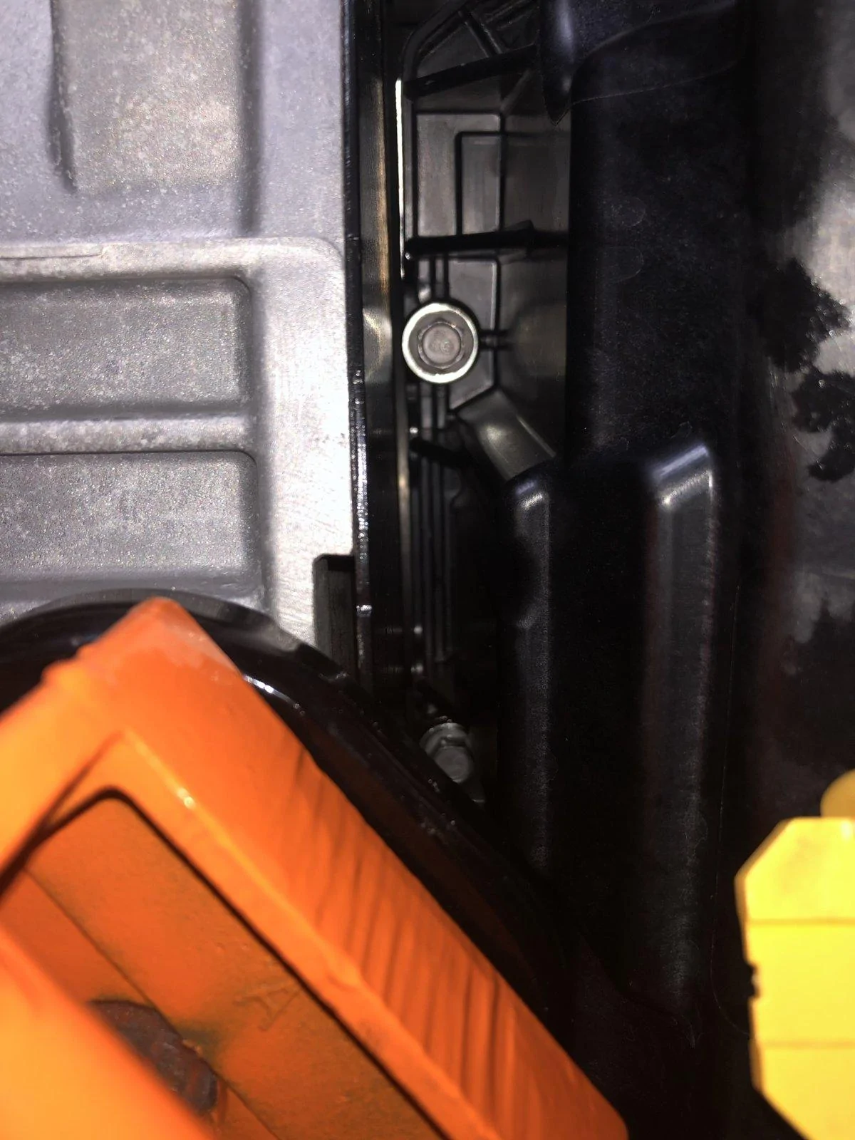

Here's the MT82 situation in photos - no metal to hook up to like the auto it seems - why plastic ford? Lol

Indeed different, but as long as you stay on the trans you look to be good.

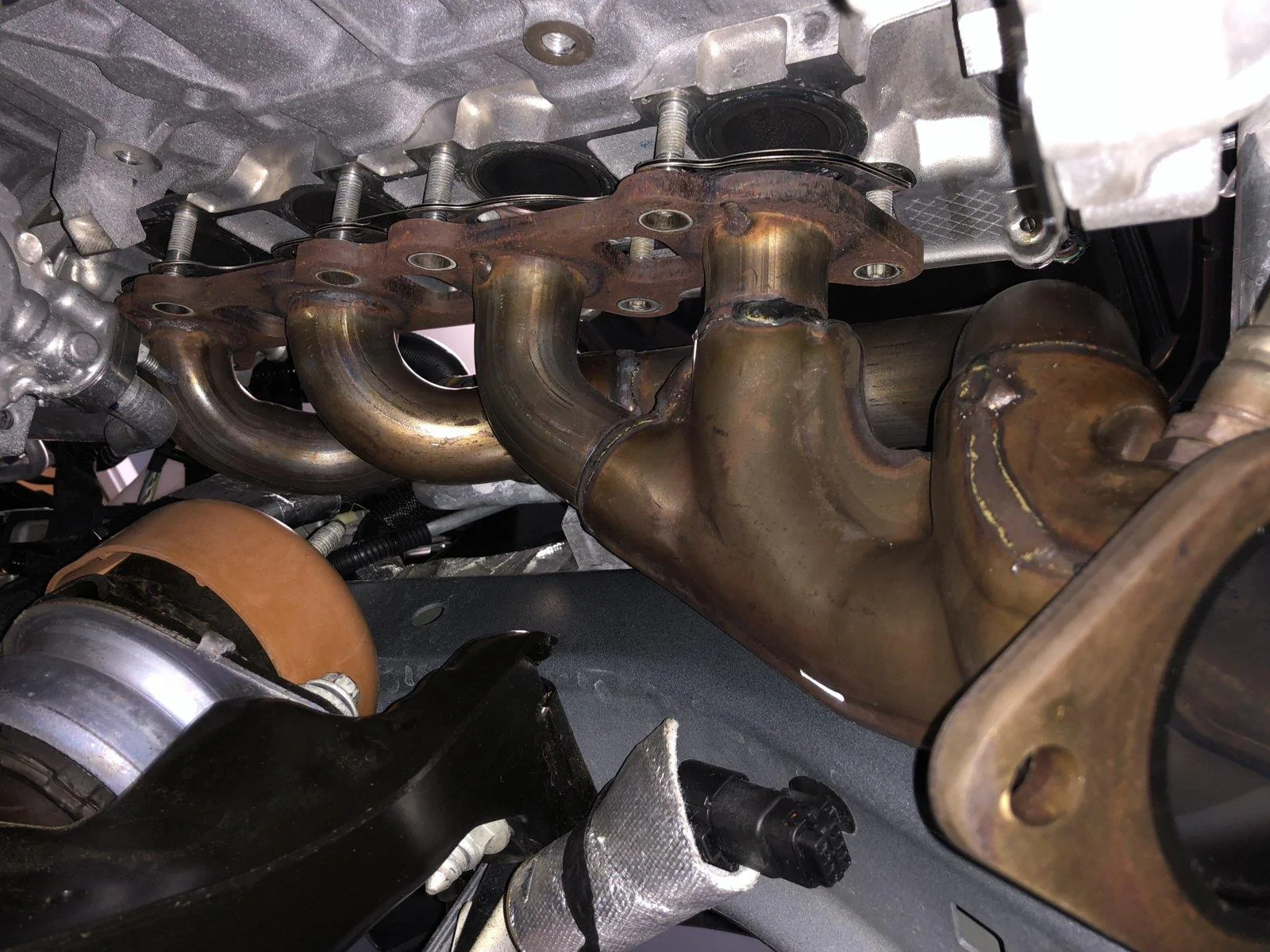

So when you get all the nuts off and the manifolds free to come out but the studs sre the hang up ... are you guys pulling the studs out to get the manifold off and then reinstalling the studs again once the header is in place?

I did have to take some studs out and reinstall. Also try to pull the engine to the driver side/passenger side as needed to remove. If you are going to pull studs, work them out a bit, then back in, then back out until removed.

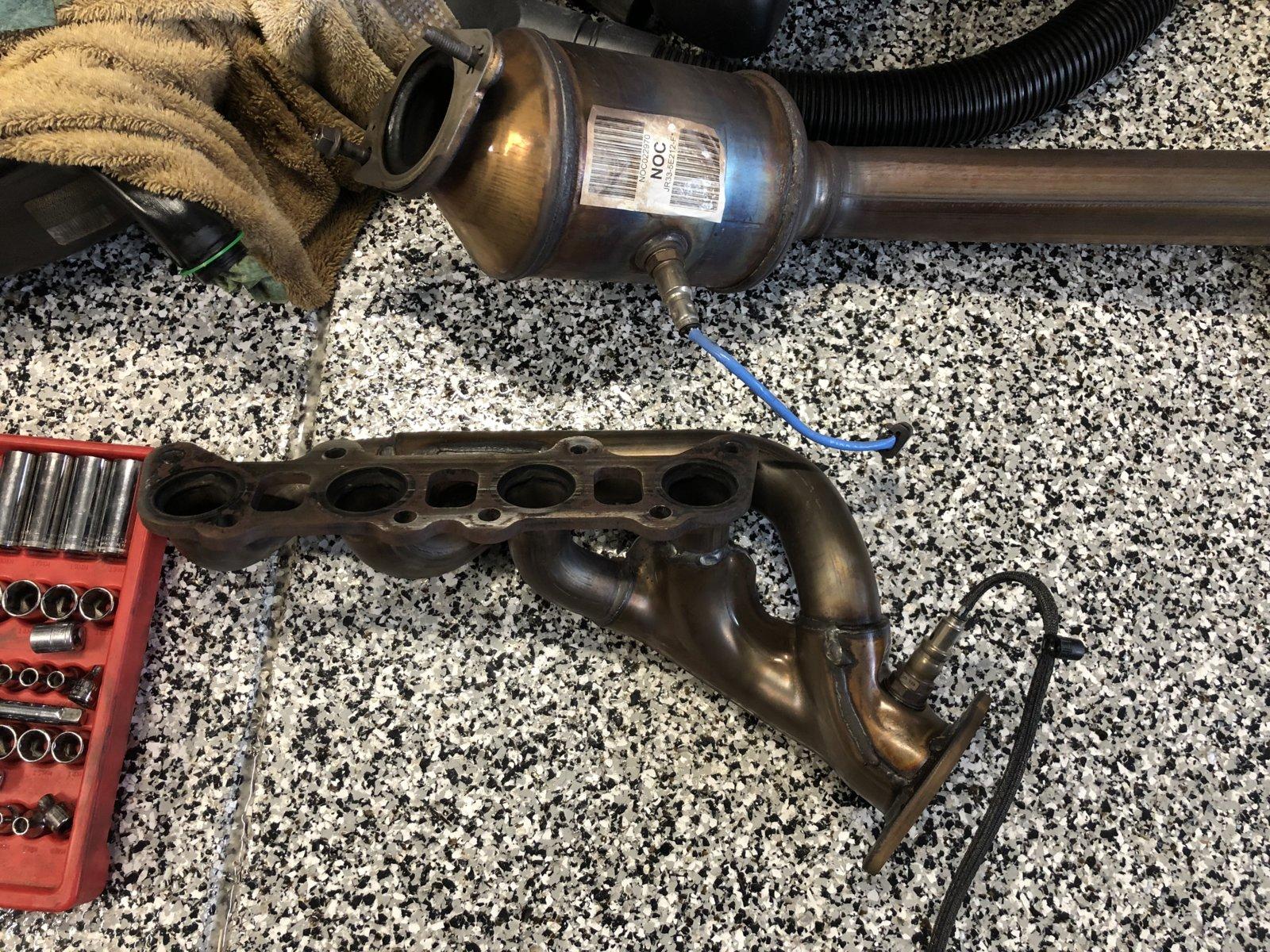

Now we're getting somewhere!
Lets see how bad it is going back on.... could be ugly... or not. Thanks for the tips!
