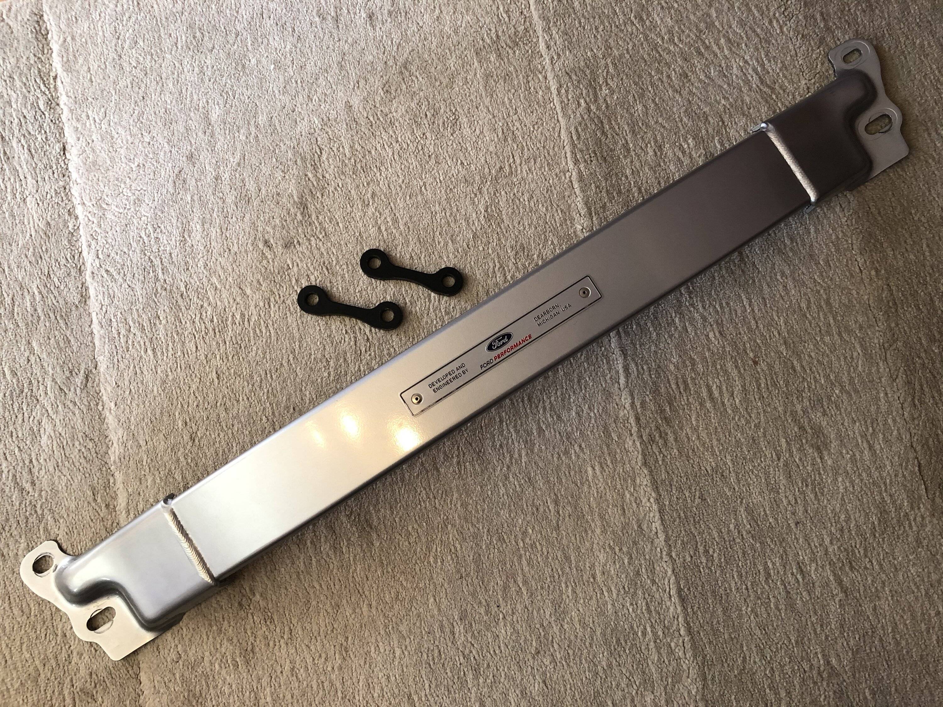

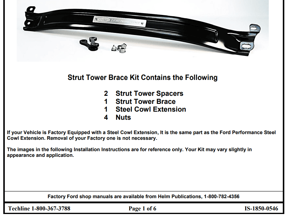

Have you guys seen the spacers Ford Performance give us as standard with RHD strut braces ?

Yeah, I take photos of everything ... :giggle:

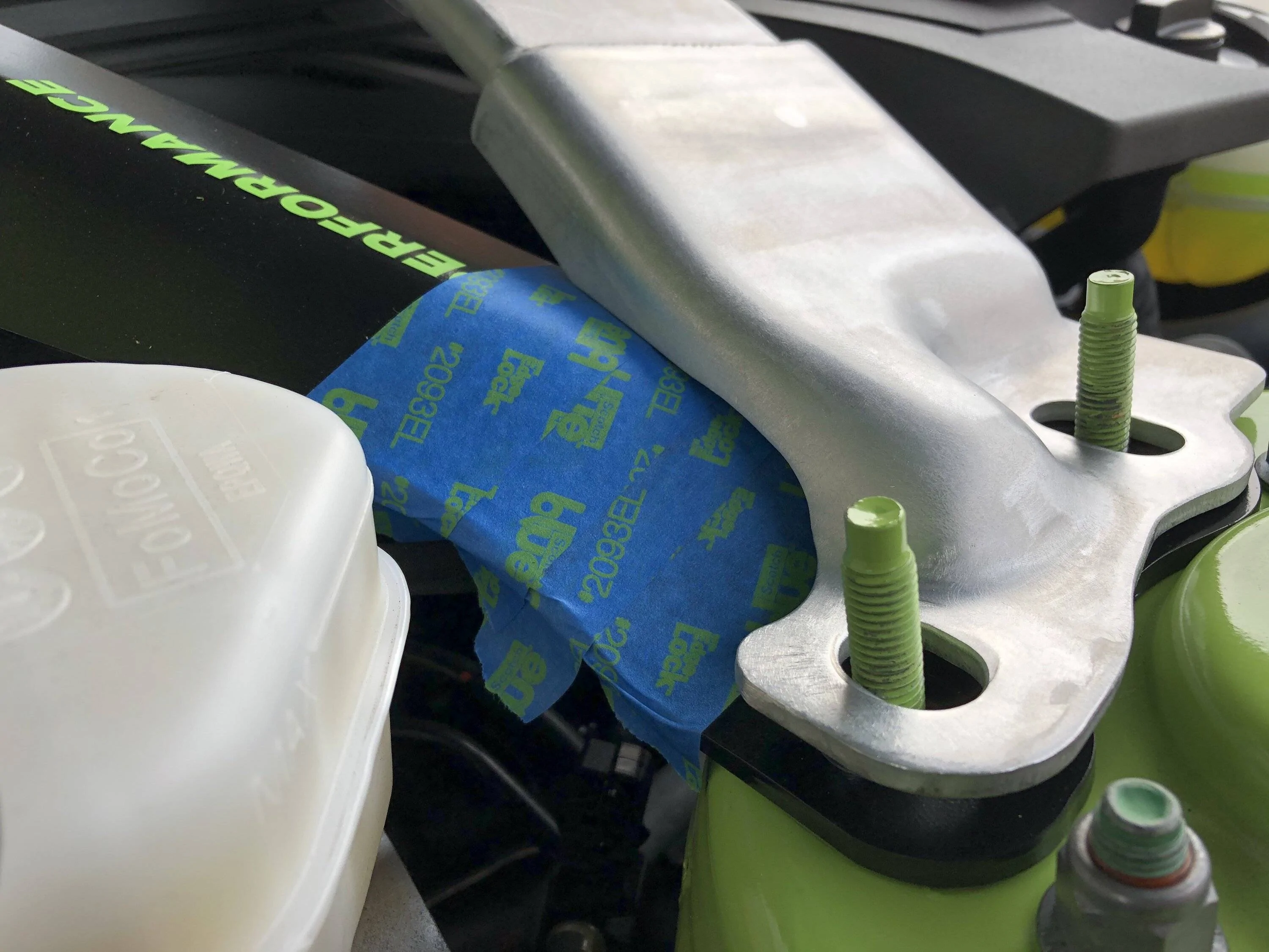

RHD cars have a different shaped cowl brace which means the standard brace doesn't quite sit down flat (same problem for both the standard steel and the 350 alloy brace) :
To fix the issue and avoid the need for a special RHD brace, FP decided to give us the dog bone spacers :
I don't know if FP have individual part numbers for those items ? They designed them to fit like this :

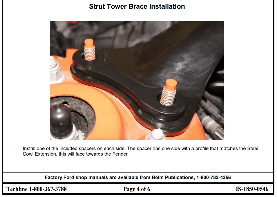

The FP info / details are attached :like:

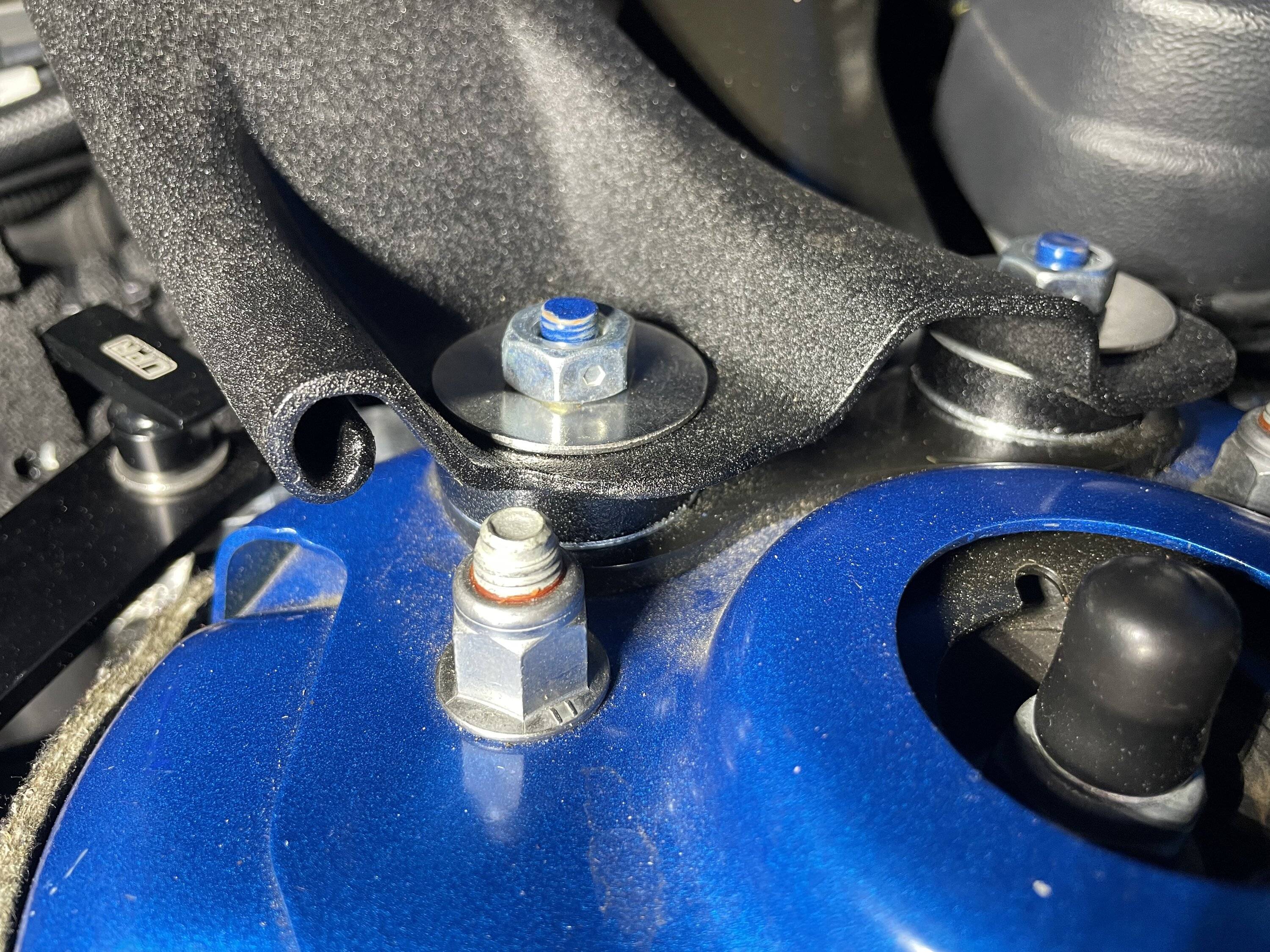

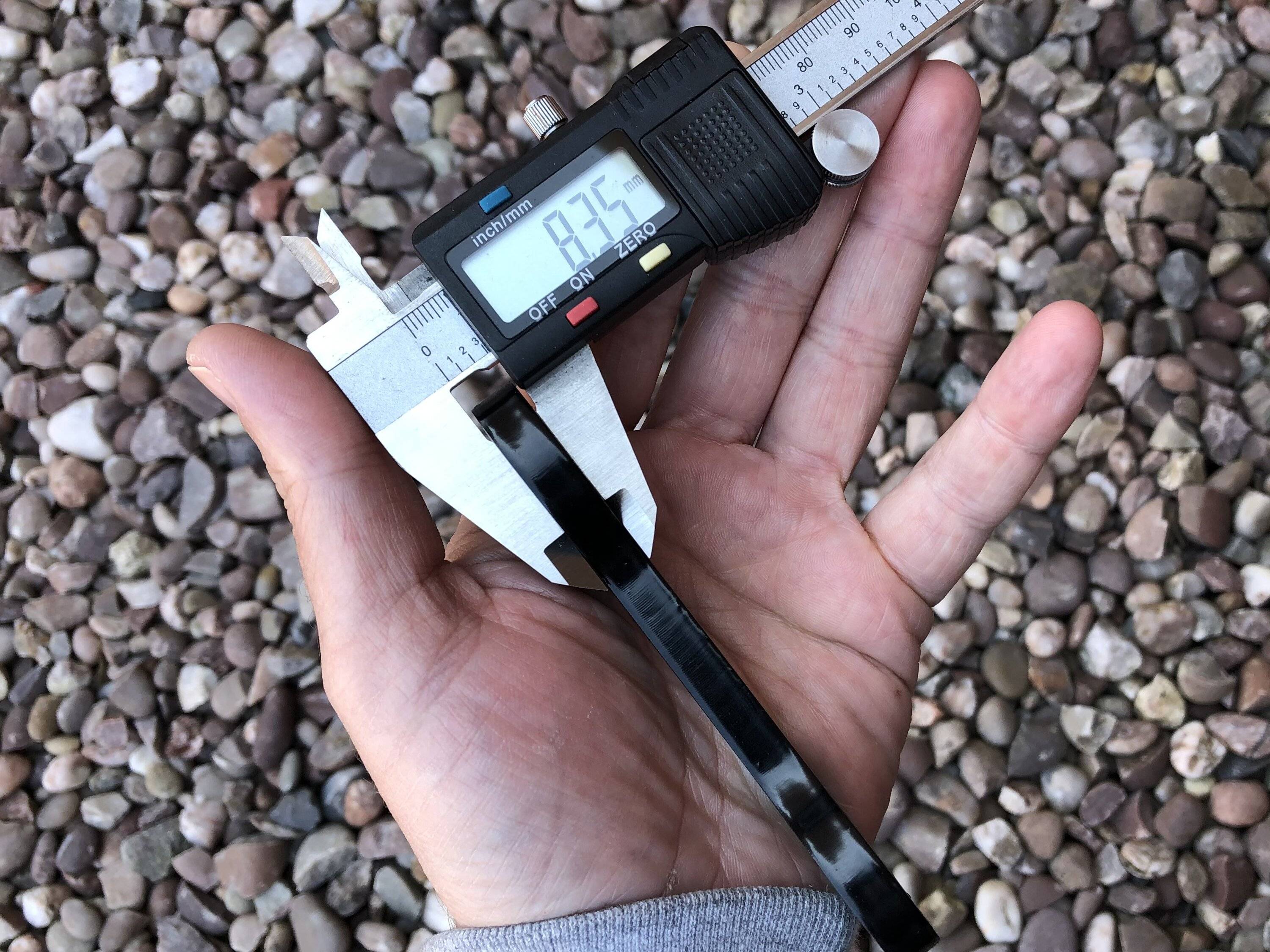

I gifted my spacers to another RHD user who bought a second hand brace which came without the spacers, but before I did I measured them at just over 8mm thick including the coating :
Note that using spacers that thick puts the nylock part of the nut very close to the top unthreaded part of the stud (or even makes it redundant) when fitted on the side of the car with the shorter studs.

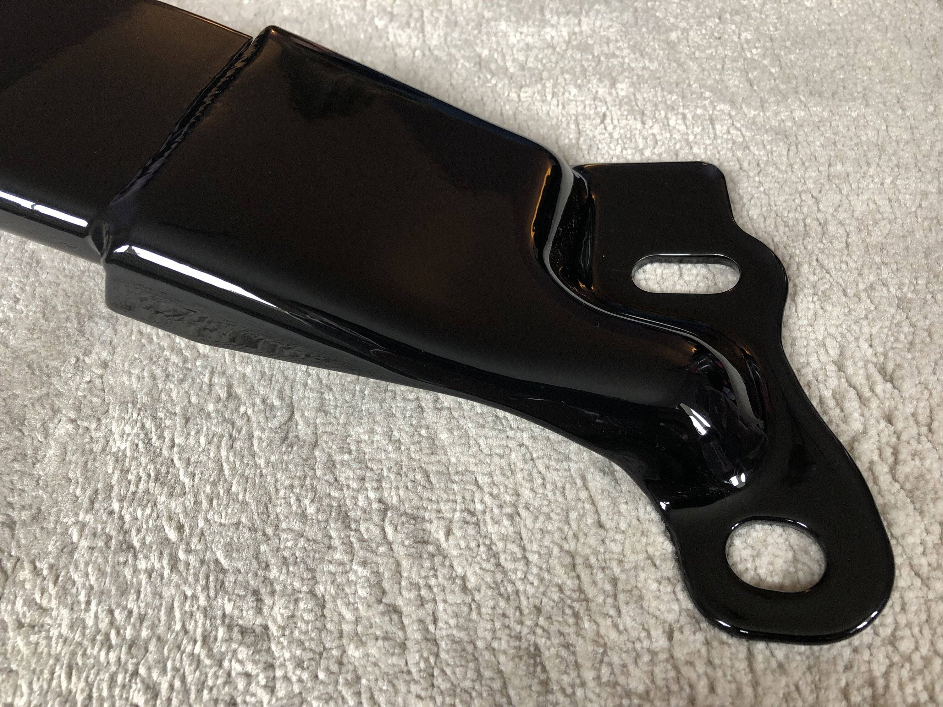

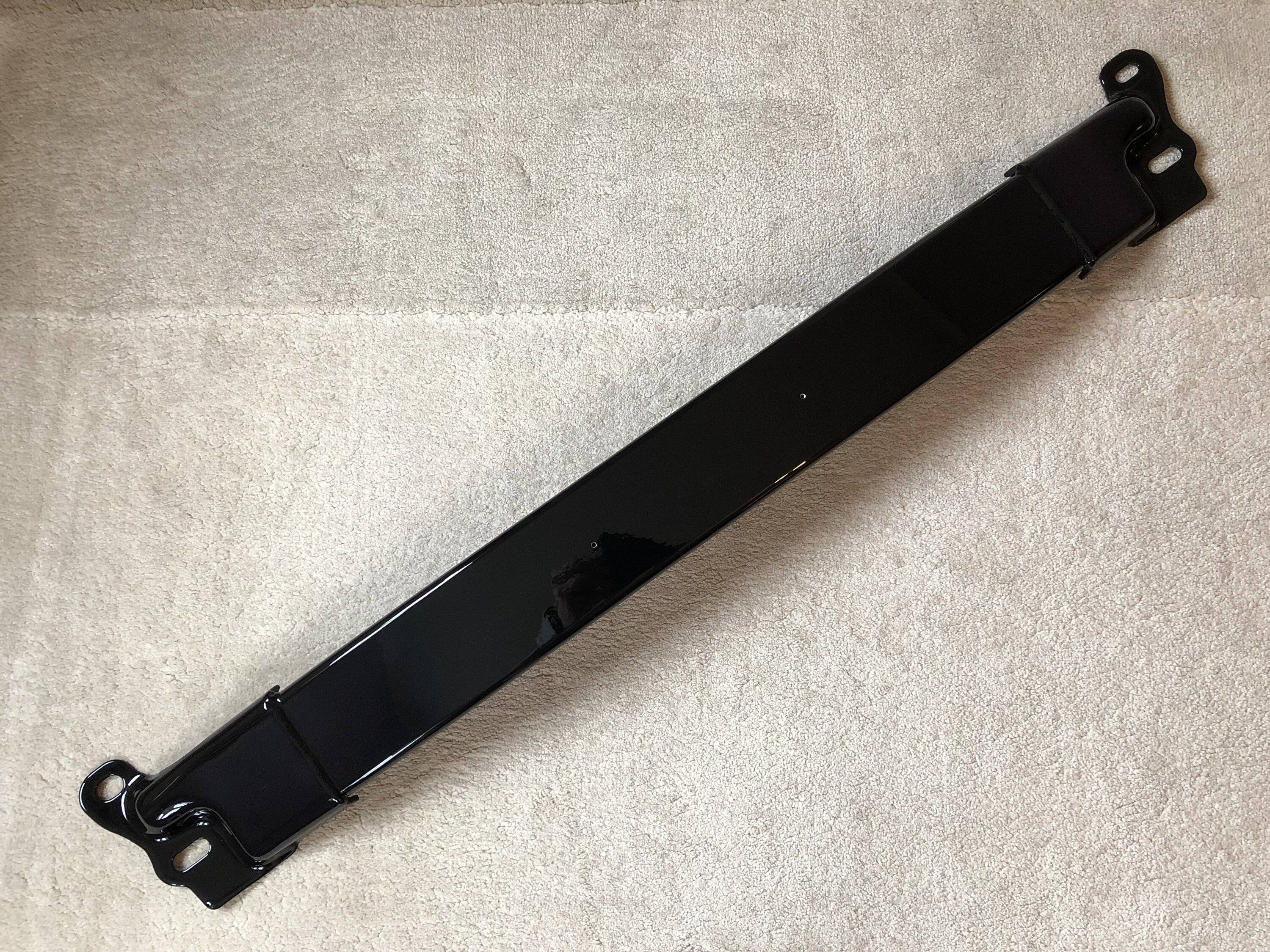

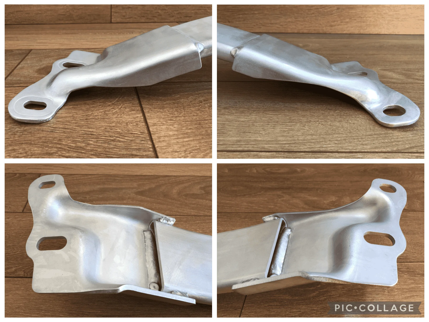

I know its not relevant for you guys but I modified my brace so it didn't need the spacers :
And then powder coated it black :
Hope that helps ?

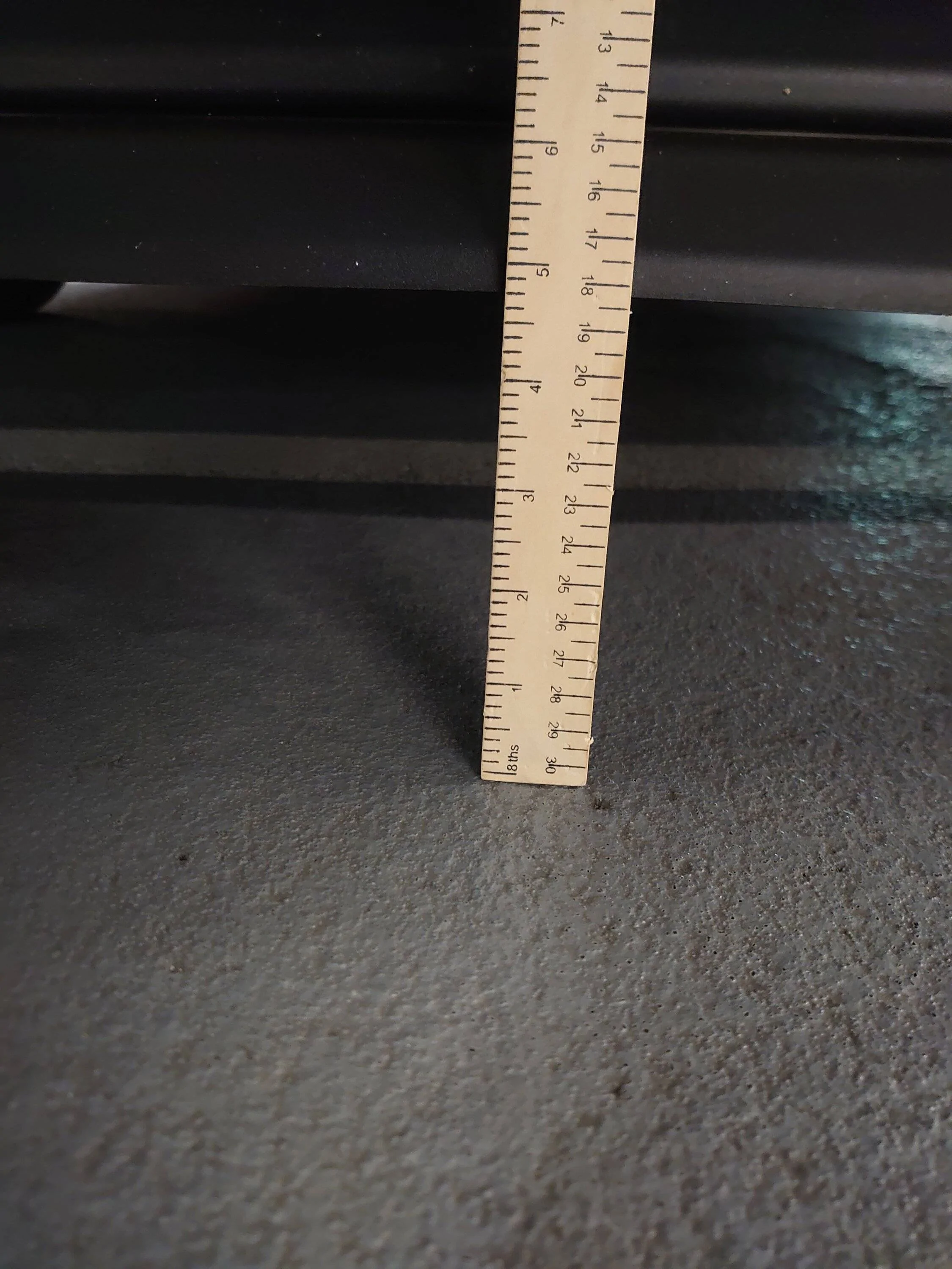

If anyone gets a minute could you measure your splitter height on the stock HP springs? Just wondering how much of a drop I hae up front. I thought the BMR springs for the 350 said 1/2" up front and 1" rear but I cant find that anywhere.
I also wonder how much additional compression the springs might have with that massive S/C sitting up there
All my suspension is stock, non-HP wheels. I have 4 7/8" clearance...

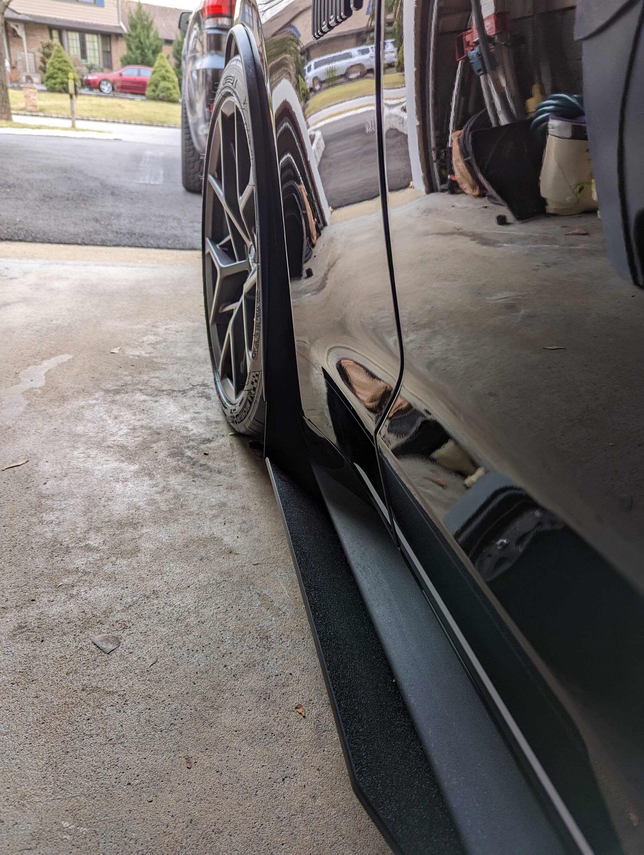

I have to get the rock blockers on soon to preserve my paint too
Hi Mike , not to get off topic on your amazing thread but could you post a picture of your rock blockers installed please ?
