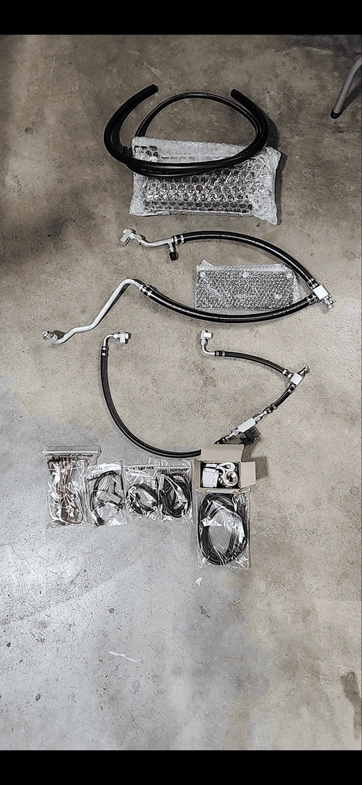

@DF19RS3 does the no-hack system replace ac refrigerant lines?,
I think you splice into them. For what I use the car for, I'm reluctant to hack in a rocker switch to enable full AC to the IC.

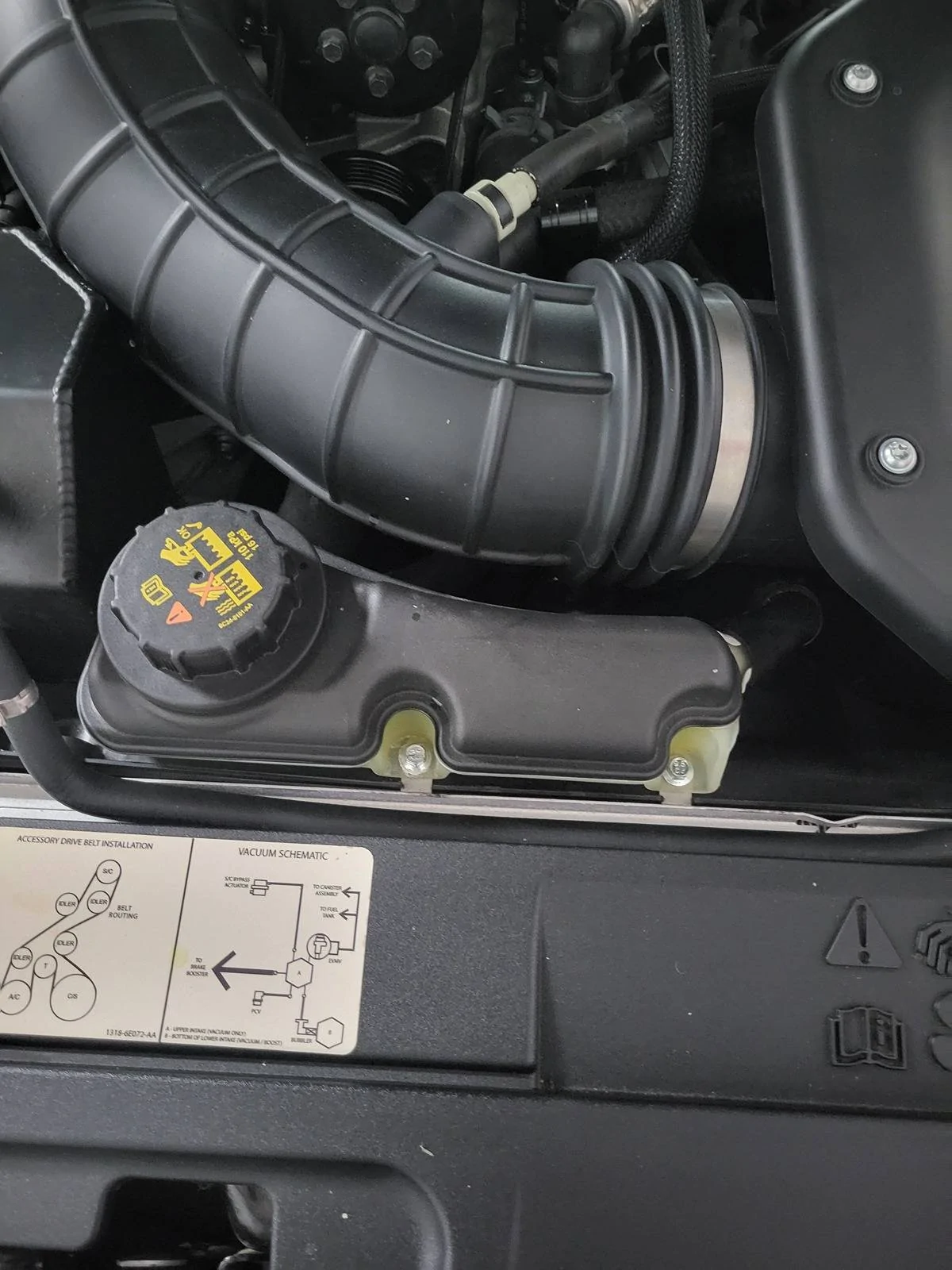

I have the stock smaller oval shaped radiator bottle. That’s why I can get in there. You have the larger radiator aftermarket tank.
Yes. Nice tank. But it's big
