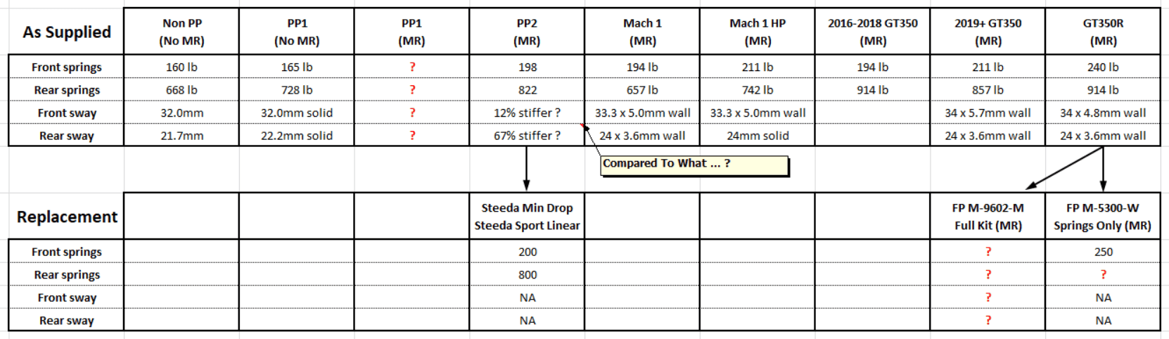

This is great info :sunglasses:
I've shamelessly stolen it and added it to other info of interest :
From my selfish perspective though, I'm most interested in the entries that are missing (bold red question marks) i.e. what I have now and what I want to add to the car lol
WD :like:
From what I have read I really think the Eibach Pro-Kit is the best in terms of rates drop for that car if not MR car. For MR cars is obviously that the FP Magneride kit is the best value for money.
WD :like:
Someone (sorry I can't give them credit) posted the PP1 GT with Magneride and I wrote it down because my car is a PP1. It was 150 front, 650 rear.
Also a GT was listed as 160 front and 668 rear.
