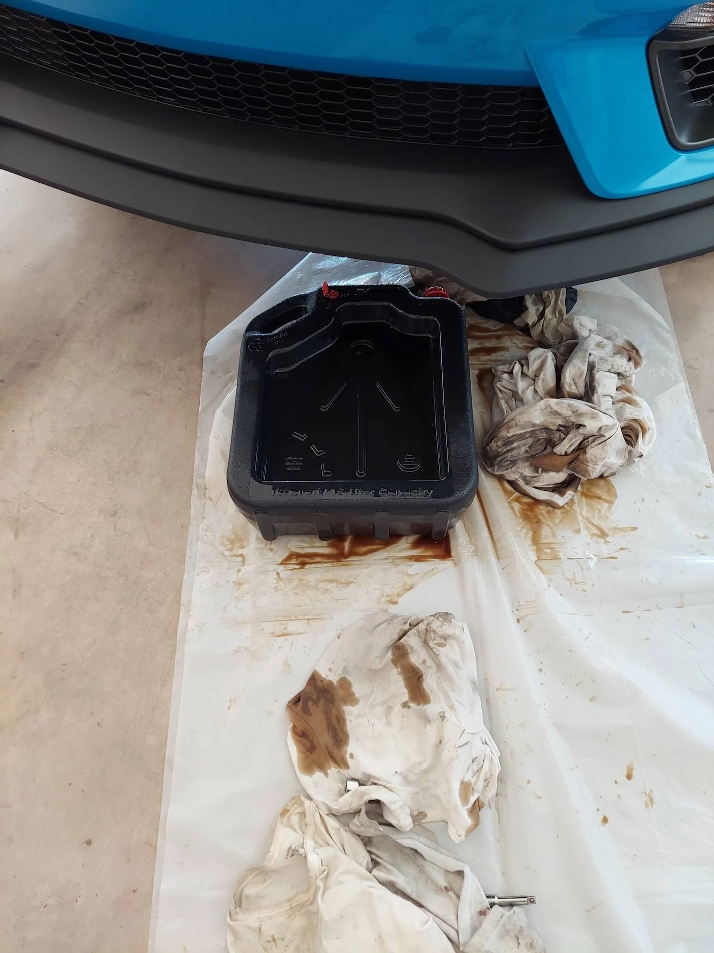

The first prototype has a lot of room for improvement.
Testify! :handsinair:
After the first oil change, I realized I needed to make a few adjustments. :giggle:

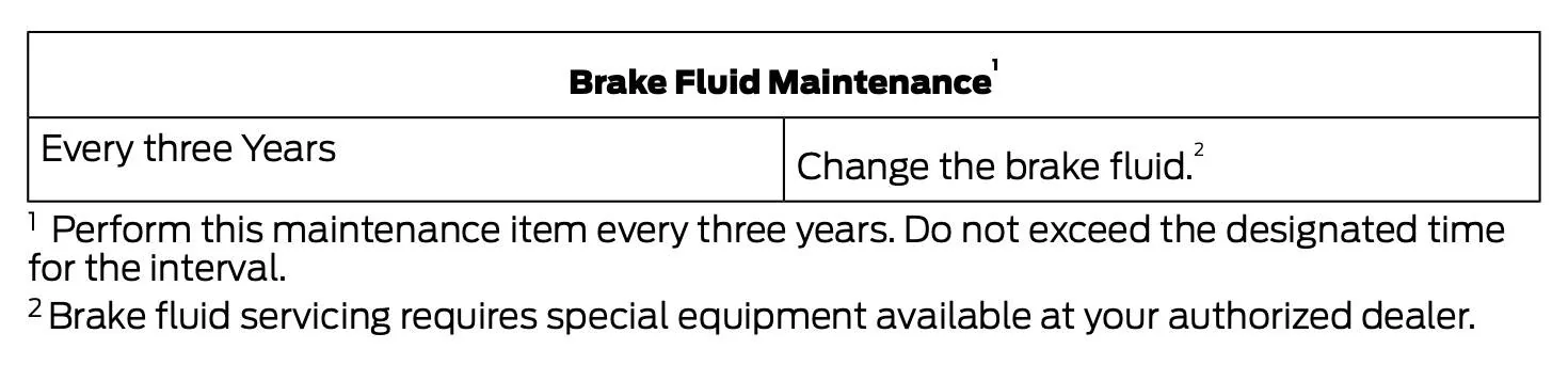

Brake fluid 3 years? Missed that in my manual.
In the 2022 Owners Manual, the reference is on Page 454.
Brake fluid, like gasoline, absorbs moisture over time, through plastic especially (see reservoir and brake lines).
Most modern vehicles have a requirement to replace the brake fluid every few years. With enough moisture present, pieces have an increased potential to rot, but more importantly, the fluid can no longer support the higher temperatures demanded of the brakes.
Going a bit over in time is not an emergency. Like any maintenance, a little variation is OK. It should still be done, to keep the brakes at their peak and support the value of the car.
https://www.mustang6g.com/forums/threads/changing-the-brake-fluid.193321/#post-3876287
Above is a thread which had some good insight, if DIY. Otherwise, any capable shop can accomplish.

Brake fluids should normally be exchanged every 2 years but higher quality ones with higher wet/dry boiling points have 3 year interval, like good old ATE 2000. I guess Mustangs use the better ones (which they should given their wild nature).
