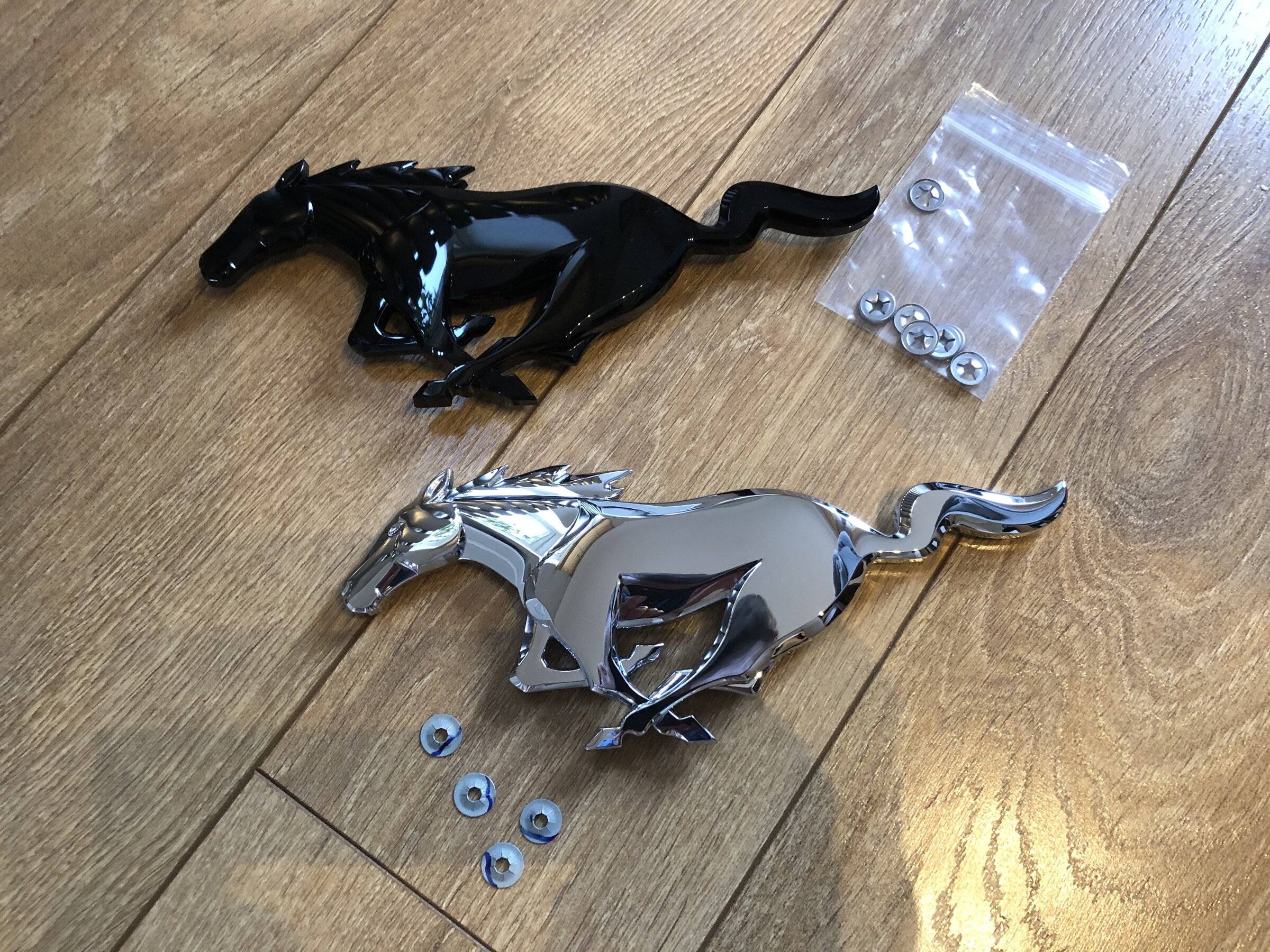

Dead easy to reuse the original lock washers, or swap them out to stainless :
If I recall correctly, the OE badges are recessed on the back which might make tape application a bit more tricky.

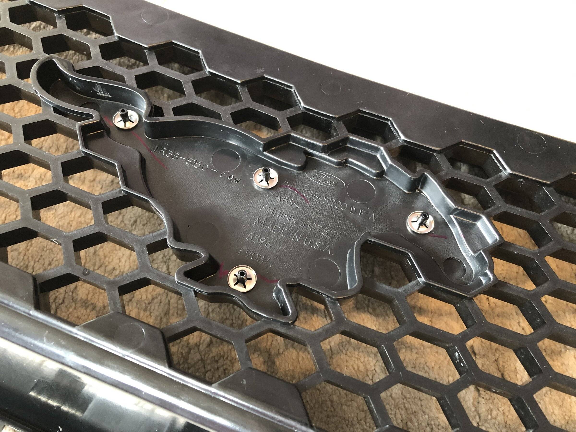

Remove the radiator shroud cover, then carefully remove the plastic cover by the hood latch. There are 2 main plastic pins that are horizontal and little clips that are vertical. I popped out the vertical ones then pulled the 2 main ones and carefully pushed it down and out of the way. It will move around a bit, just be carful and patient. After that is out of the way, you can get your hand in there...wear gloves as the plastic is sharp...my wife said no means no when I was done! lol
The pony's clips are held in by a metal retainer...get a small screwdriver and pry it off...you will most likely break the plastic holding the pony...no worries. Luckily the OEM pony doesn't have adhesive (The damn 5.0 badges are a nightmare). Once all clips are removed, it just comes right out. Put the new one in and use the similar style clips on the posts.

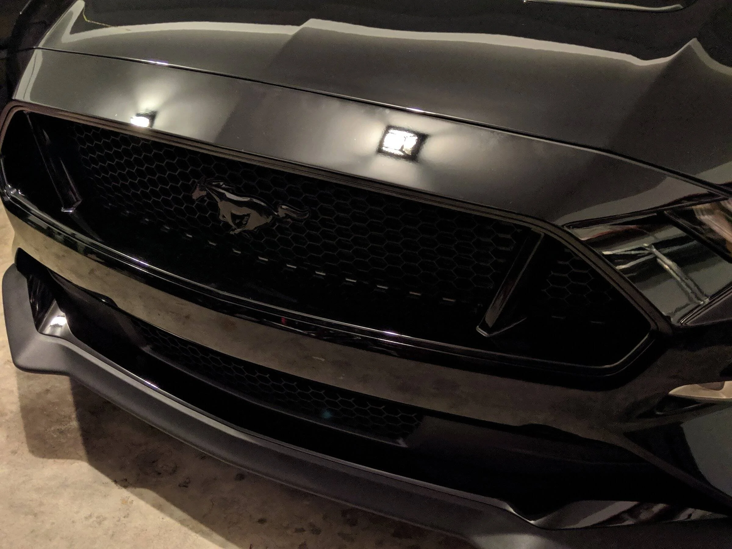

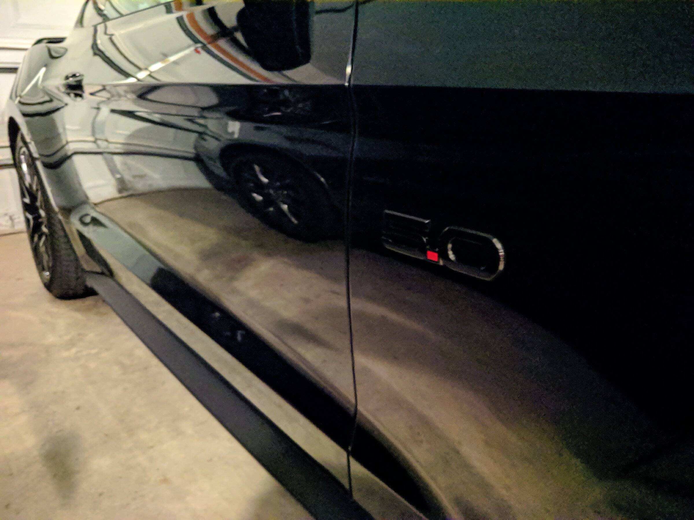

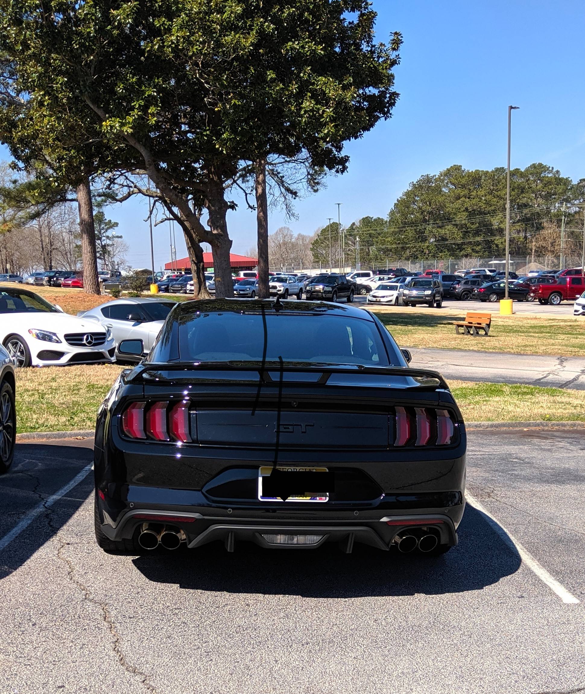

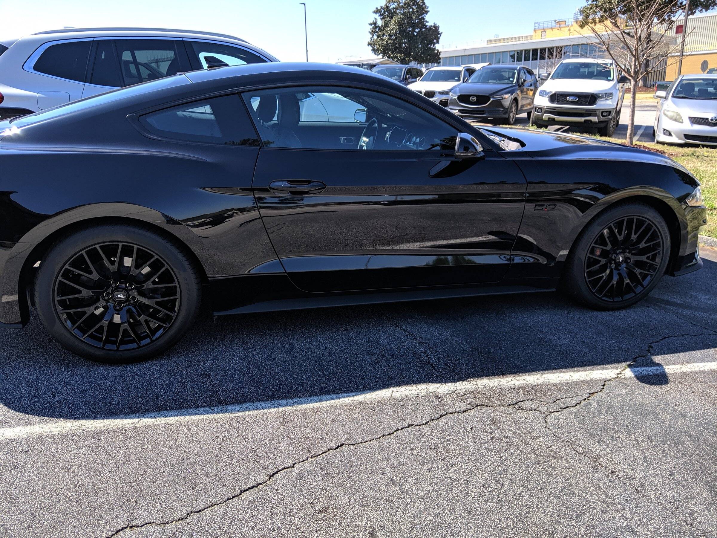

Thanks, here are the other pics...hated the chrome!
