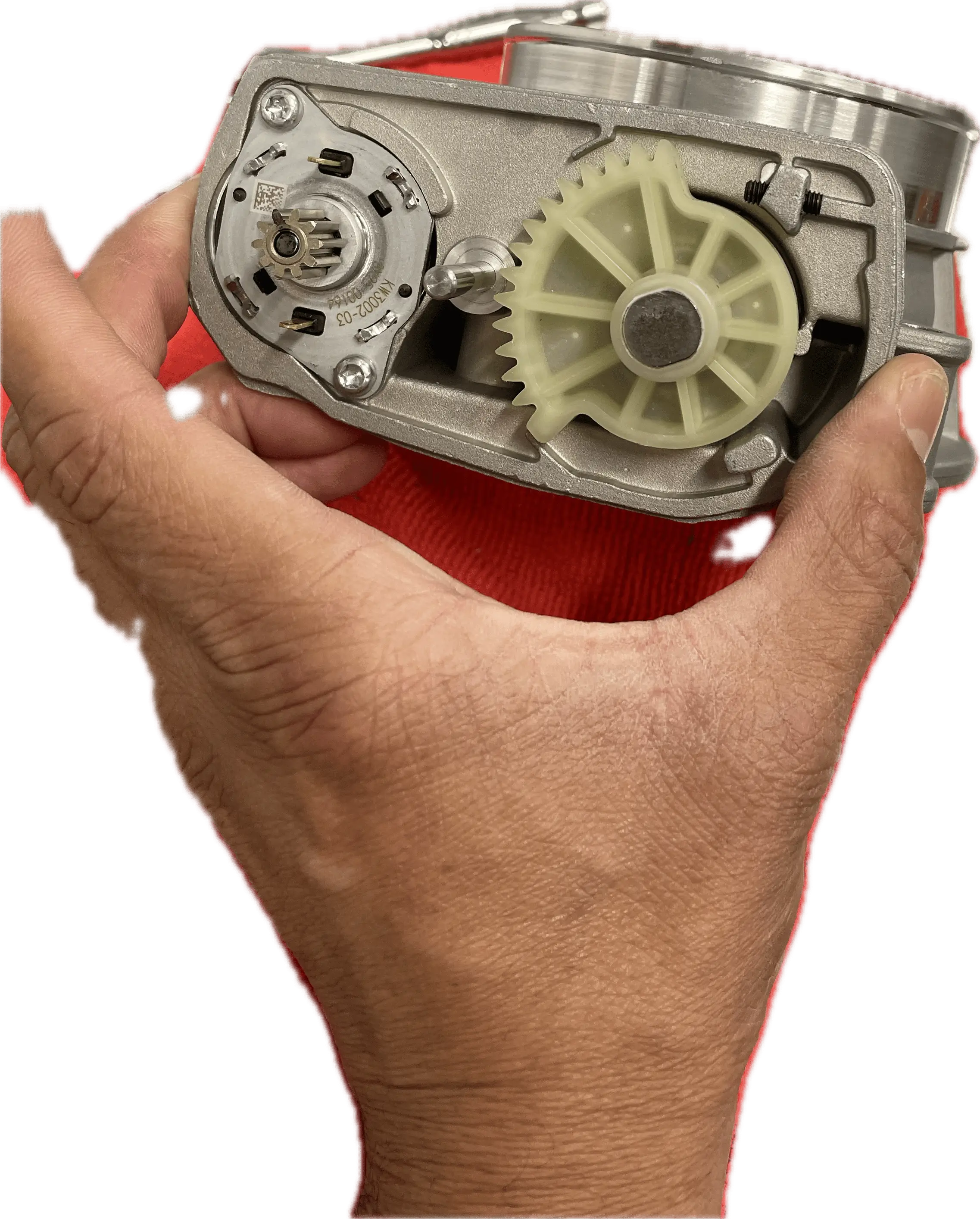

If memory serves me correctly, I believe you said the shaft area around the blade on the tb was clean and not gunked up. When I had thst problem of mine sticking open and shut, there were witness marks in the bore of my tb.
Have you popped the cover off and looked underneath to see if anything looks amiss? The spring clips come off very easily with a flathead screwdriver.

I have the global settings set to Mazda instead of Ford. Since there was no check engine light, I didn't check for codes. After the first occurrence, I turned off no-lift and launch control for the WOTBox. With traction control off, the factory launch control was also disabled. The last time I inspected my throttle body, it appeared clean. I will follow your instructions to check the throttle body unit for any abnormalities. Additionally, I haven't performed the KAM reset yet, so I will do that as a precautionary measure.
