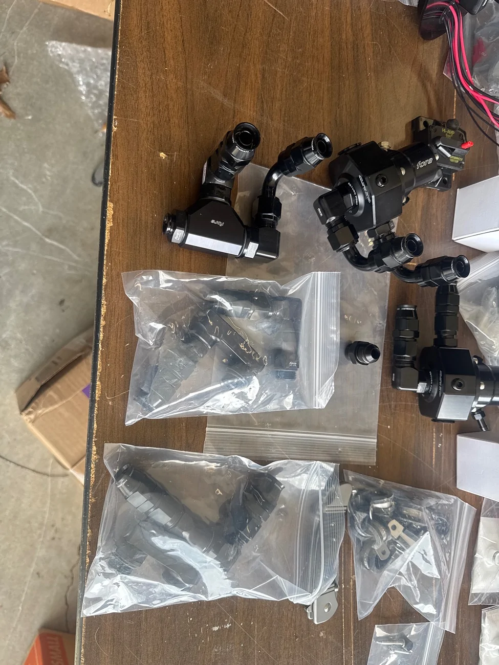

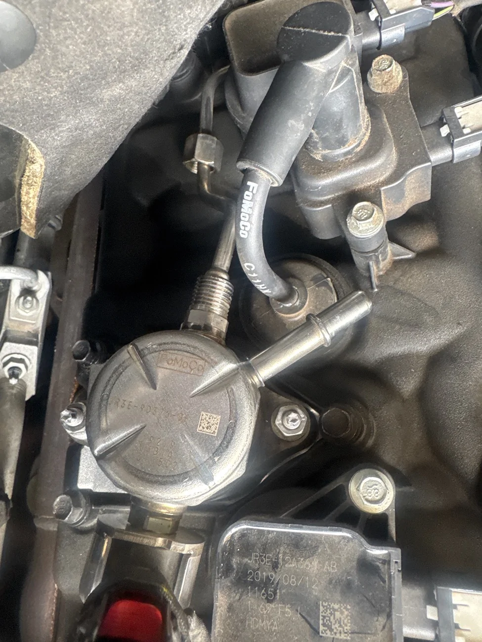

attempting to install the fuel system but hitting a hiccup early on… the high pressure fuel pump.. one regulator supposed to go before it no real location to mount the regulator

That regulator should after the billet fuel rails get fed. The HPFP is usually fed off the rails or looks like it could be fed off of that tee. The regulator will control the fuel pressure in the rail by returning what isn’t needed. You can run your first fuel pump off the factory PWM connector and use the Fore relay box to turn on pump 2 and 3.
