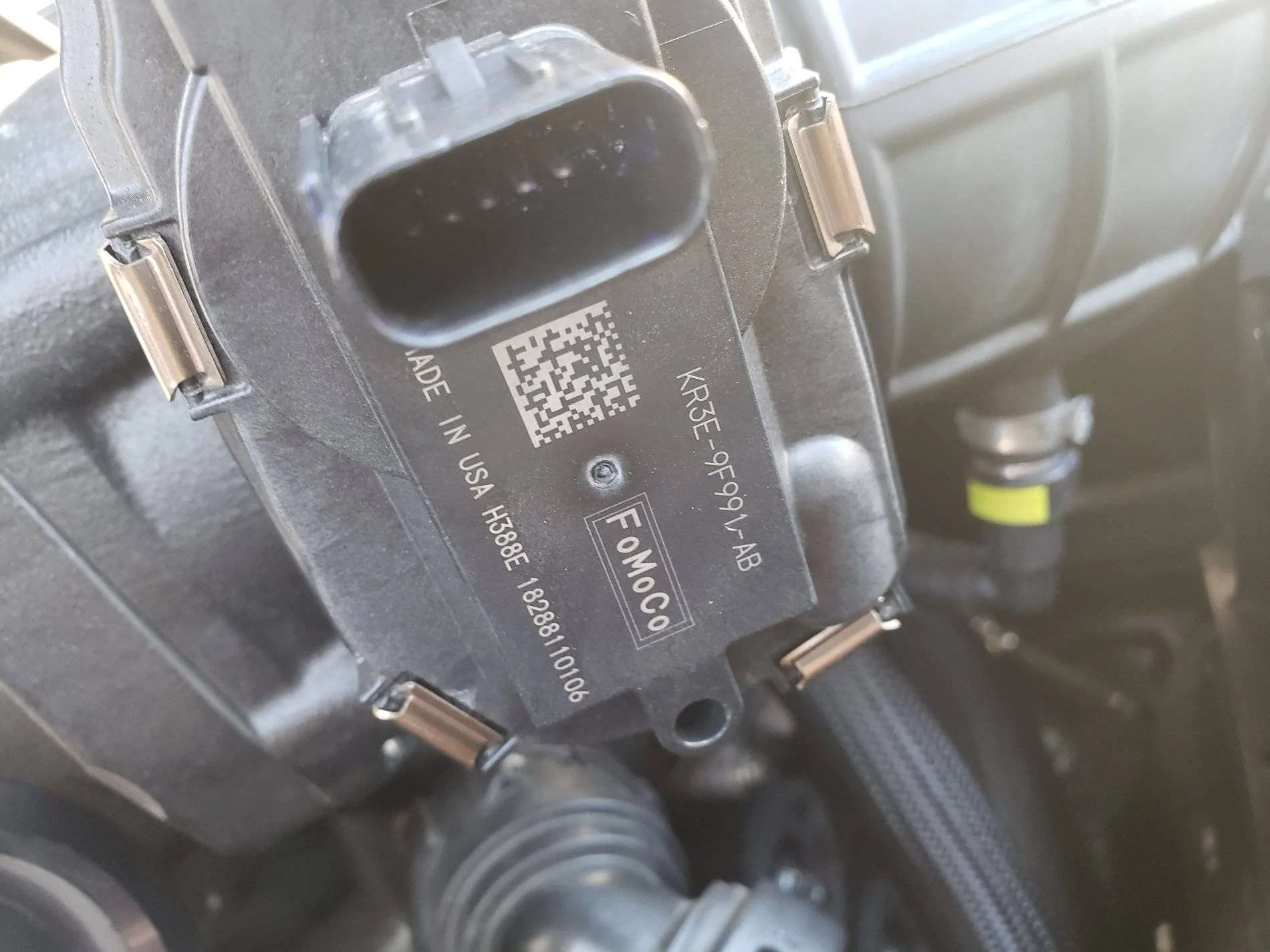

Update #2: I was having significant issues with the tune. Flat spots with virtually no throttle response during random cruising and also when coming out of boost. Then it went in limp mode out of nowhere and CEL came on. I pulled three codes all related to PCM inputs- throttle position, IAT sensor, and ABS.
I decided to revert the tune back to stock and then re-program the car with the EB tune. So far, driveability has improved drastically now that the TB is operating properly. There is still somewhat of an on/off switch, but much better than before.
Still may go the custom tune route and I have OPG/CS on order.
I was having this issue and it turned out to be the throttle body. Like you I reset to stock with the stock TB and then it was fine for awhile. The issue kept happening so Edelbrock replaced the TB and I havent had an issue ever since.

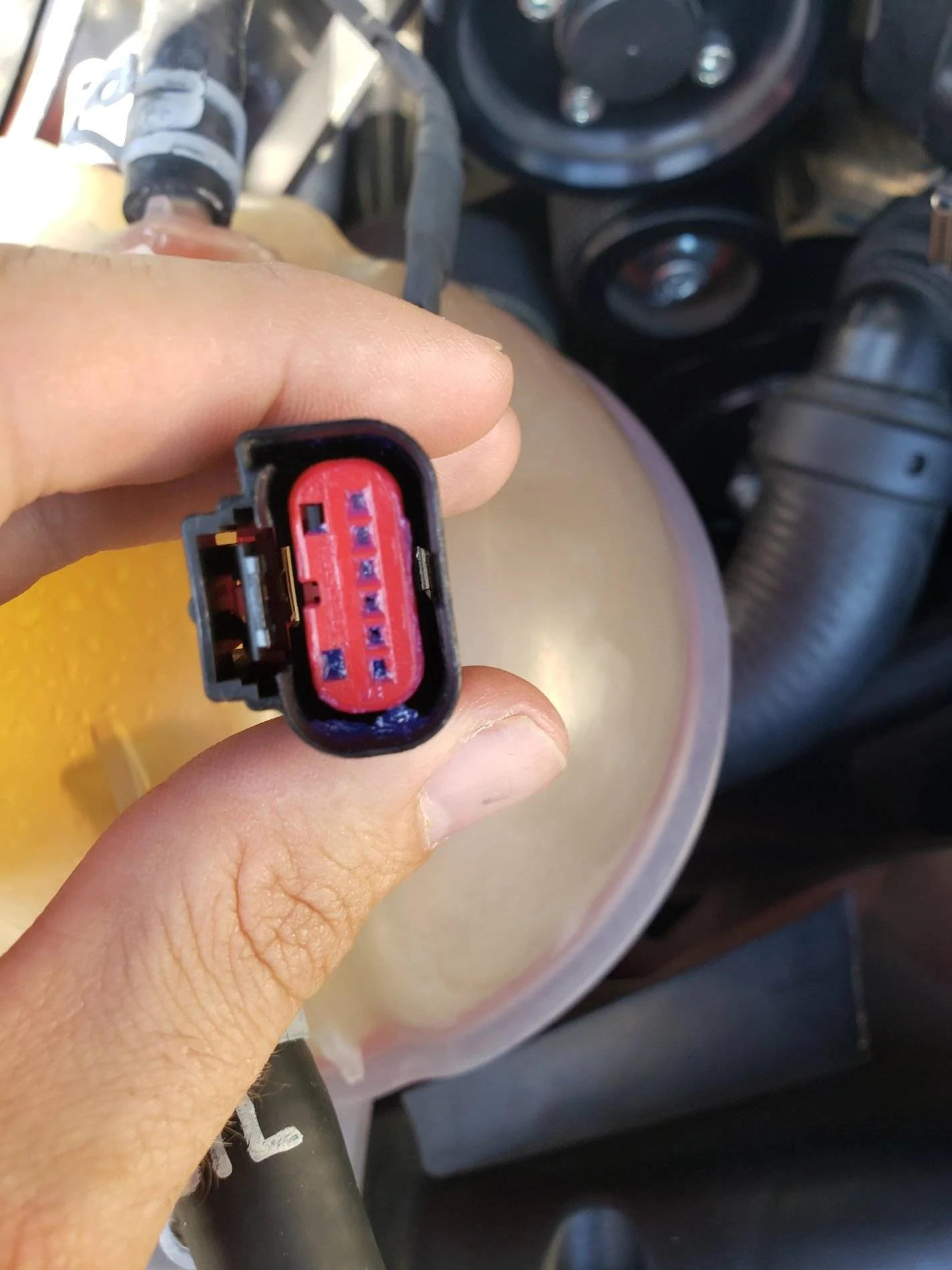

Also, the weirdest thing happend to me before I replaced the TB. The plug going into the throttle body looked like it melted on the inside and there was some grease on the inside, which to me looked like dielectric grease although neither me nor the installer put it on there. I'm not sure if that had anything to do with it, I replaced the connector before the TB went on and its been perfect ever since.

That’s crazy. Thanks for the info. So far so good since I reloaded the tune, but I’ll look out for that if it returns.
