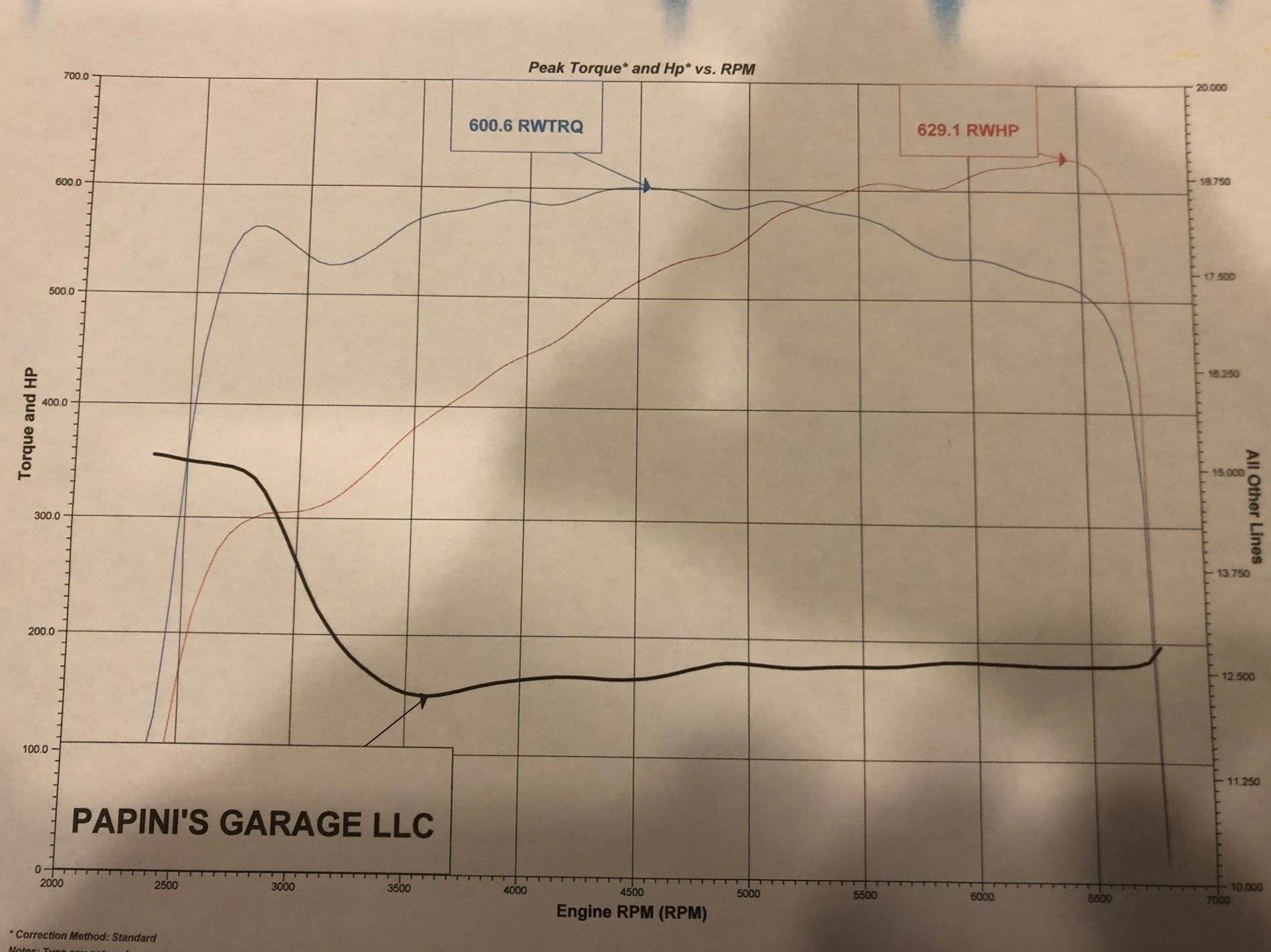

I just had the Edelbrock 2650 Stage II kit installed on my 2020 Mustang GT (PP1/A10). The dyno graph below depicts the DynoJet numbers on straight 91 octane. Overall, I'm happy with the numbers that it made especially the torque that the 2650 makes.
I have very limited seat time, but as far as the driveability goes, it is just like stock....almost too much like stock. As others have mentioned, the canned EB tune is like an on/off switch. It's either WOT throttle or it drives completely like stock even at 1/2 to 2/3 throttle. And yes, I removed the nitrous pill and clamped both ends of the bypass hose before installing the blower. Looking at the logs, this thing only has about 9.5 to 10 degrees of timing in it so there is a lot left on the table. The good thing is that we didn't see any knock during the dyno runs with straight 91 octane (NO octane booster).
I just sold a boosted (centri) C6Z06 that had much better throttle response than I have felt so far with this blower so I may look at a custom tune soon so I can enjoy the PD blower much more.
More to follow as I get more seat time, but I wanted to at least let others know what these kits are capable of on straight 91.

Not terrible through an A10 even in STD correction, shame u don’t have access to 93

Tell me about it. It's very tempting to put on e85 because I have that available locally. I may just do a custom tune to fix the throttle response and to unlock some of the power that 's left in the canned tune.

Good for 91 octane. Dynojet’s typically read higher but still good. If you have E85 available then combine that with a custom tune and you will be amazed with the results. Some OPG’s and let her rev!

Trying to keep this build mild. Will likely just do a custom tune for 91. Just sold a car making 874/795 and don’t need that much power.

Data logs showed no knock, but only 9.5 to 10 deg timing.
