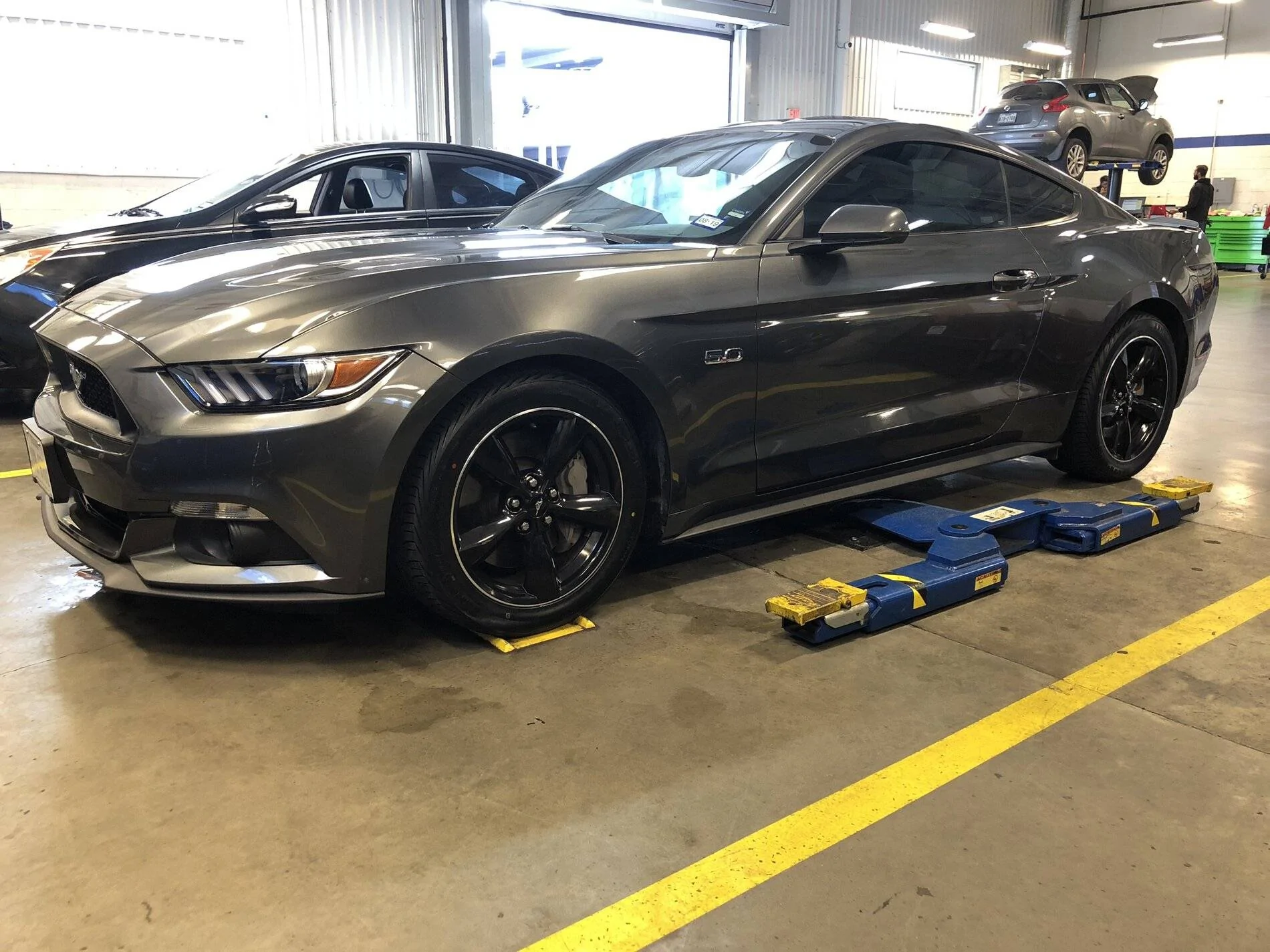

When I had my ‘17 GT with the stock 18x8 wheels, I tried out 255/45R18 tires. They weren’t a problem to mount at all. Traction was slightly better but still insufficient. Here’s what they looked like:
What tires did you buy?

They were Zenna Argus, just some cheap tires to keep me rolling. I never intended to keep the stock wheels on for long.
